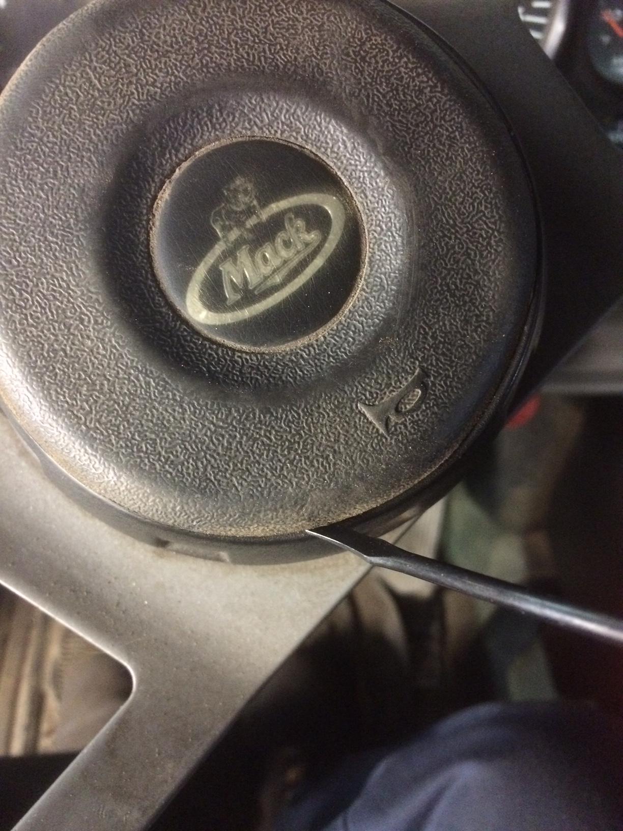

2.The rubber cap can just be pried off. Sometimes the inner cup will stay with it other times it will separate.

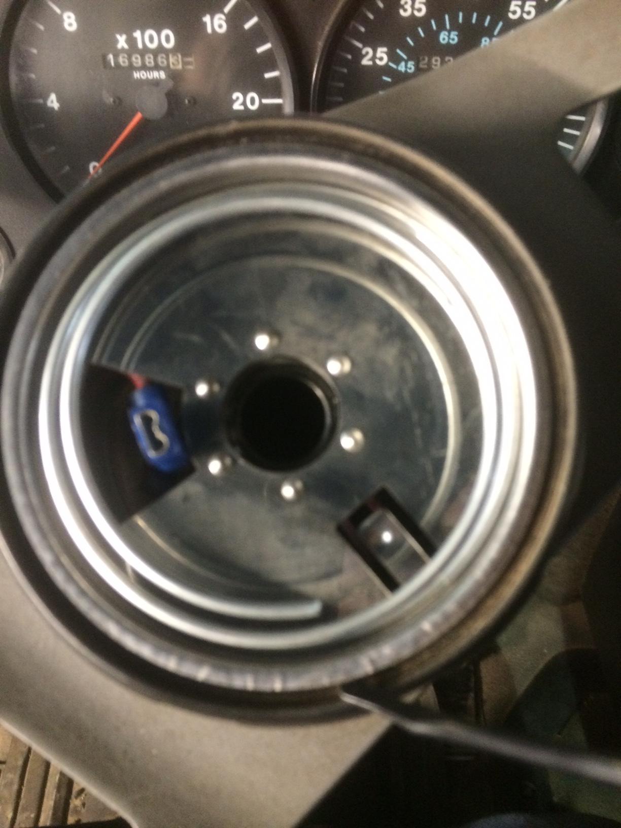

4. Remove the inner cup by prying up. (if it didn't already come out with the rubber)

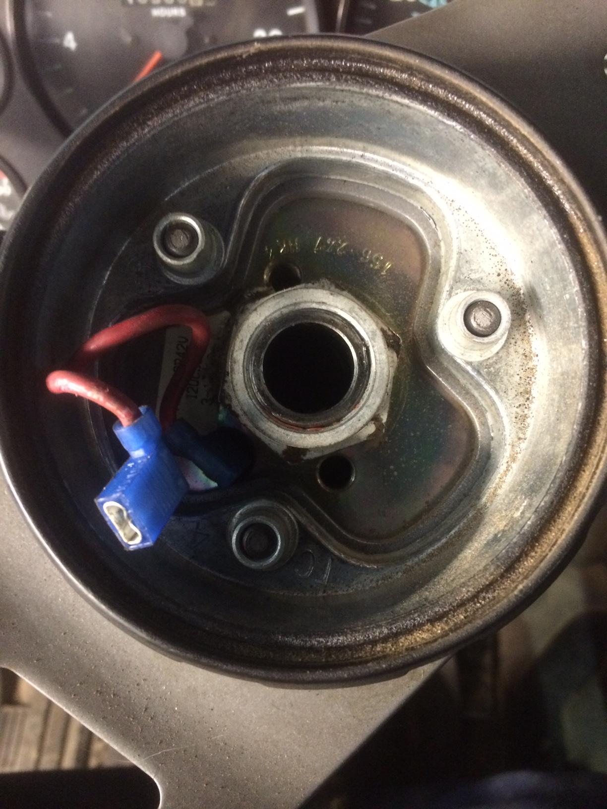

5. Remove the center nut.

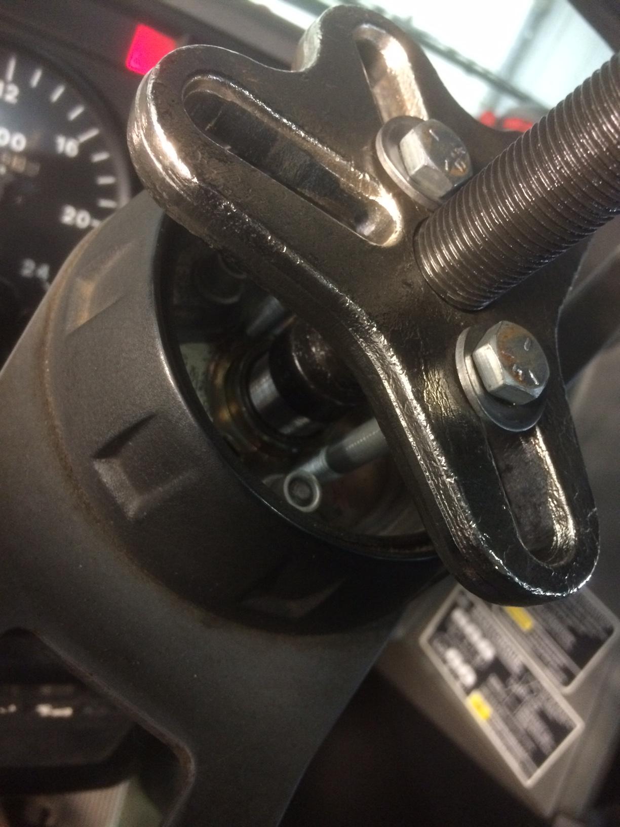

6. Using a suitable puller pop the wheel off. (There are 2 threaded holes to grab the wheel) Usually come off with minimal force.
