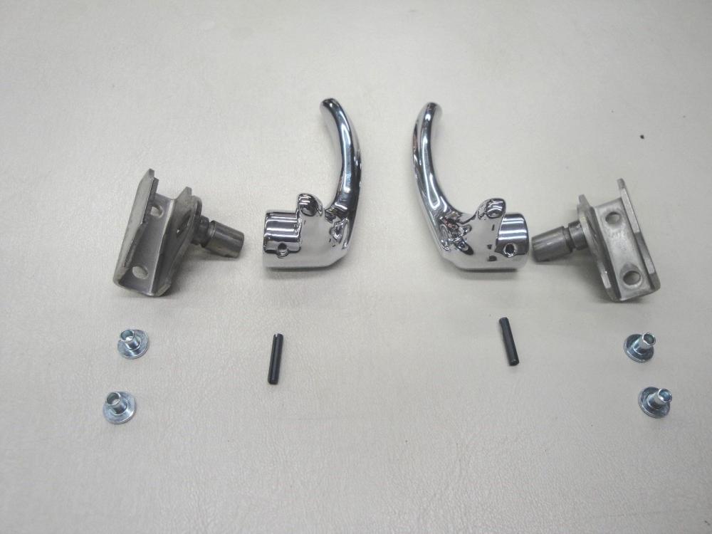

I have not found the solution to putting together the latch. I cannot find a pin online so the latch will connect to the window frame. I found an old Chevy truck site and bought the pins but they were not a match fit with the latches I bought from Watts.I'm at a stand still on this project.
 Are they "Roll Pins?
If so go to harbor freight they have a 120 piece assortment for $5
http://www.harborfreight.com/120-piece-roll-pin-storehouse-67591.html

Ok.....looked on site but should be a backing round kinda flat that goes through the vent frame to protrude out long enough stem so handle will fit on. Different from what this shows. I think these roll pins lock the handle on to the shaft i'm speaking of.

Take a photo of the handle and the shaft it goes on it you can.

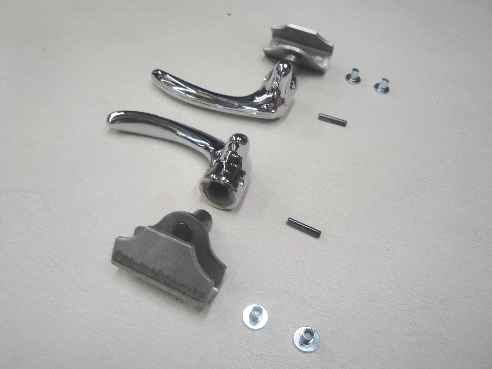

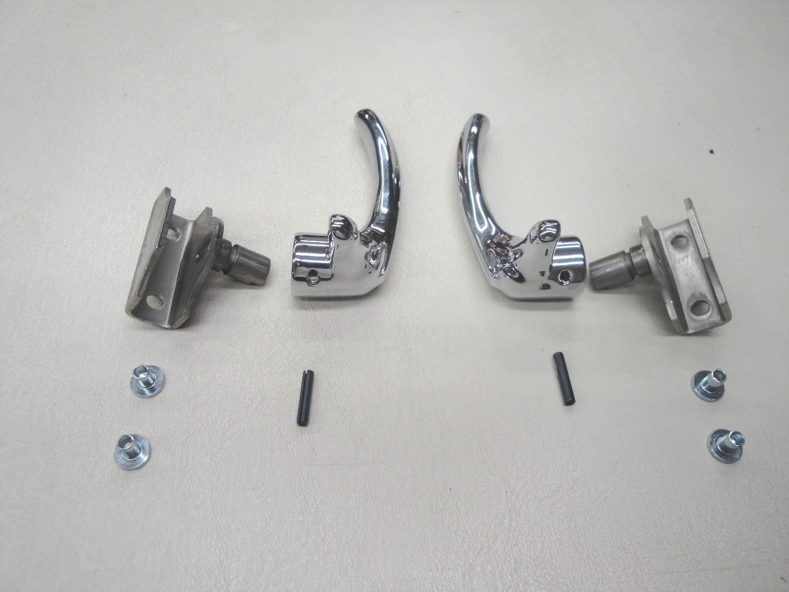

This  is what I bought for my B61 Mixer.  The shaft has a flat that limits the amount the handle turns and behind the flat is a 360 degree "channel" that the roll pin  fits against.

All of that stuff is what I need. I only have the handles. Nothing else came with it. I sure have suffered for no good reasons with just those vent windows. I farmed them out 5 years ago to a local hot rod shop they drug their feet so I finally had to pick them up, after them keeping them for many months. Paul how can I find those parts?

Here is the link to Dennis Carpenters Ford Truck parts. It's on the second or third page.  I ended up pretty lucky because the 1948  to 1952 matches the B shaped vent close not exact but close enough to work well. 1953 and up is close the R model vent parts. .    Paul
