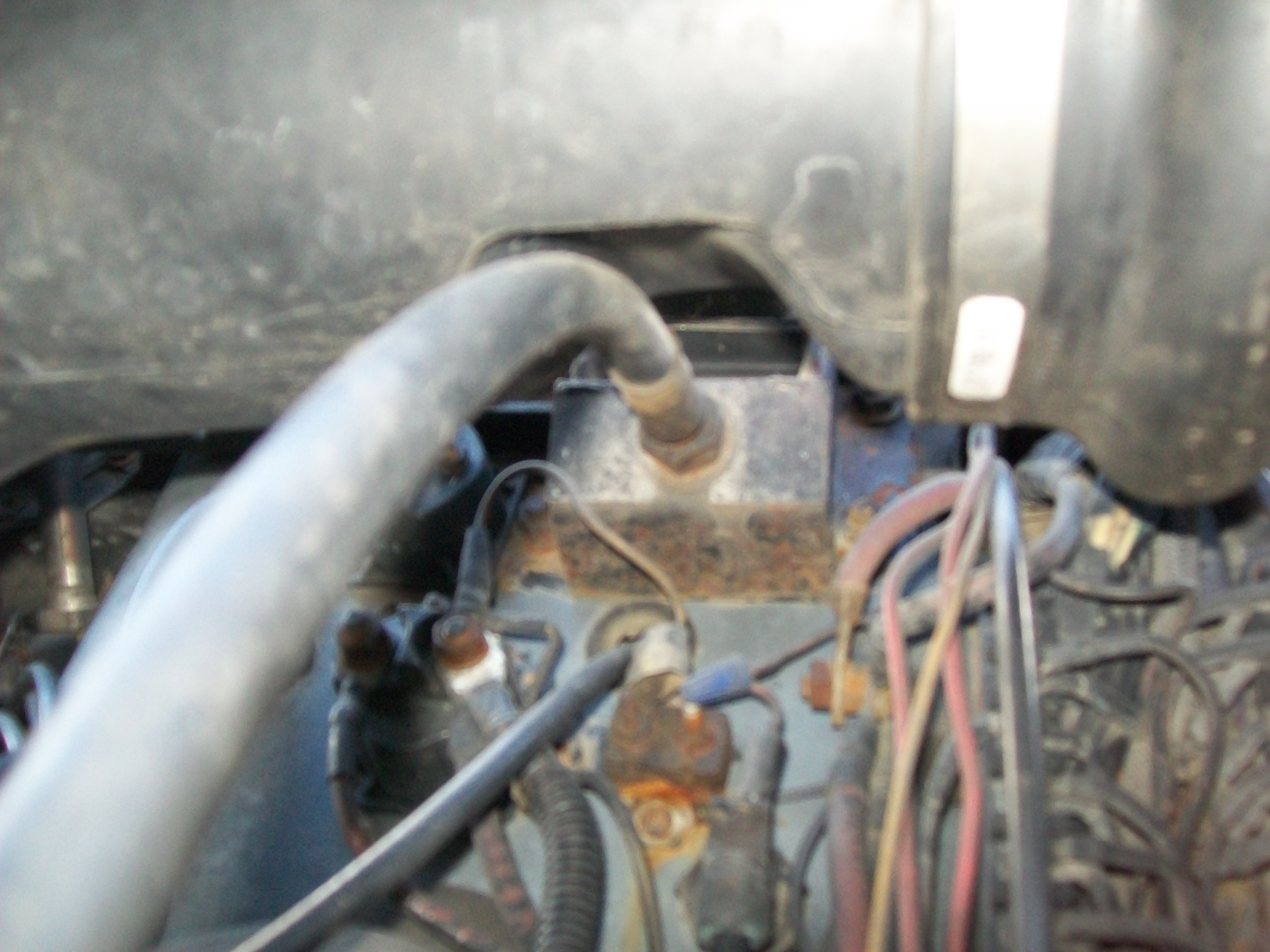

Hey guys I'm installing external air cleaners on a superliner I'm redoing, need some under hood pics of the left side to see how the piping clears the clutch cable, mine has no room for the pipe without moving the cable, I will post some pics tomorrow to show the problem, was thinking there might be a different cable bracket for a factory external truck

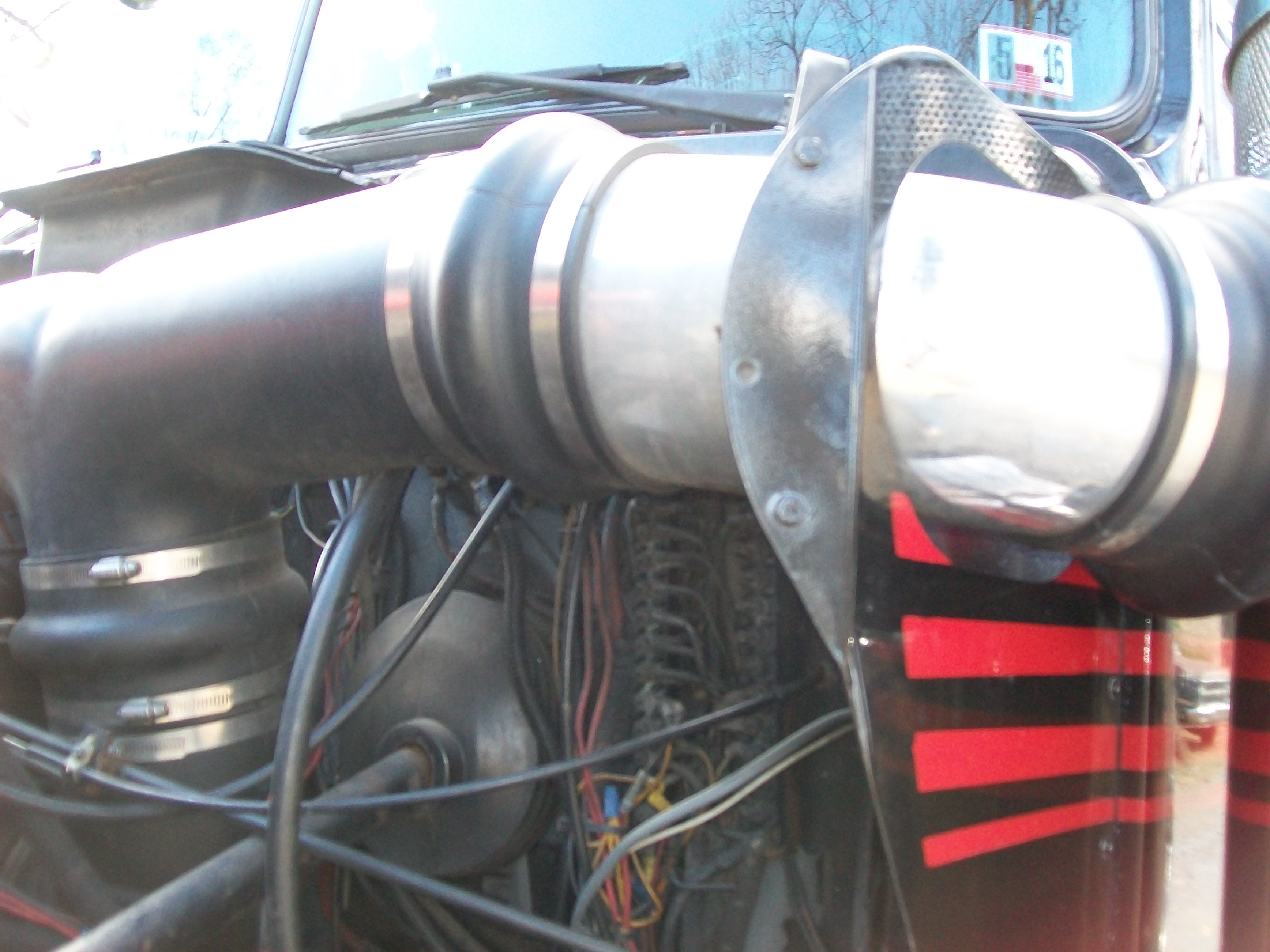

Go to "Waking up the E9" post you can see how it was done on my Superliner. I don't think any brackets were moved or made. They sure help it breathe!!

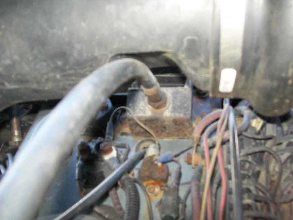

I can see pretty good in your pics, looks like my clutch cable comes off the cab on a downward angle, and yours goes straight out, theres a small piece of metal on the cab where the 2 jam nuts are on the cable, I think if I losen them I can flip that metal piece around, then it would raise the cable up, maybe someone put mine on wrong in a cable replacement, I will try it today, thanks for the info

Yep all mack pieces
seen guys make there own aluminum crossovers
Like on my truck. Think it was actually made out of aluminum at Madison Mack on my truck. it is 6 inch. I think Back in Black's is 7" into 6 at the turbo and mounted higher.
