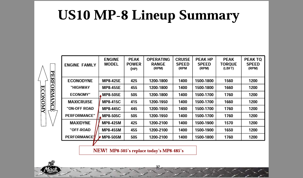

All the MP8's are pretty much the same. The torque curve starts around 1100rpm and drops off just under 1500 rpm if i remember correctly. somewhere around 1400 is the sweet spot. Anymore then 1450 is wasted fuel. These MP's pull like hell right down to 1000rpm. I tell the guys not to bog them down that low but they handle it well.
(All of the newer MP literature I have are missing the graph's for some weird reason???) 445 and 505 act very similar in torque etc. except for needing to feed more horses. Keep in mind you get into a whole different animal with the 505E+ (Econ-boost)
There is a big difference in performance that I and my dealer have noticed with regards to weather or not your MP8 is an Econodyne, Maxicruise or Maxidyne.
We have found and our dealer agrees that the Maxicruise is getting the best all around performance results for grunt and fuel economy.
The best performer we have is the MP8445C (Maxicruise) Our 505E (Econodyne) should be the fuel miser that it isnt and in performing has fell flat on its face.
That is the engine we reflashed to a 445C. It has gained in fuel mileage (almost 1/2 an MPG) and pull on long grades as reported by the dedicated driver.
The stock trucks the dealer is ordering in are predominately Maxicruise.(C Engines)
Our 445C with 13 Fuller and Eaton 355's on 22.5 rubber runs 1400rpm at 105km/hr

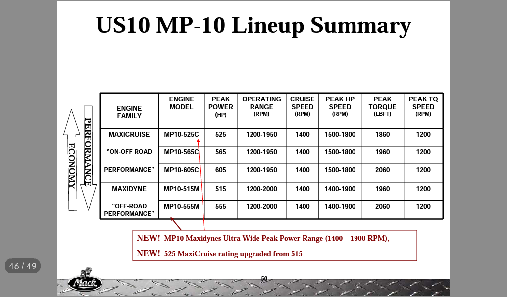

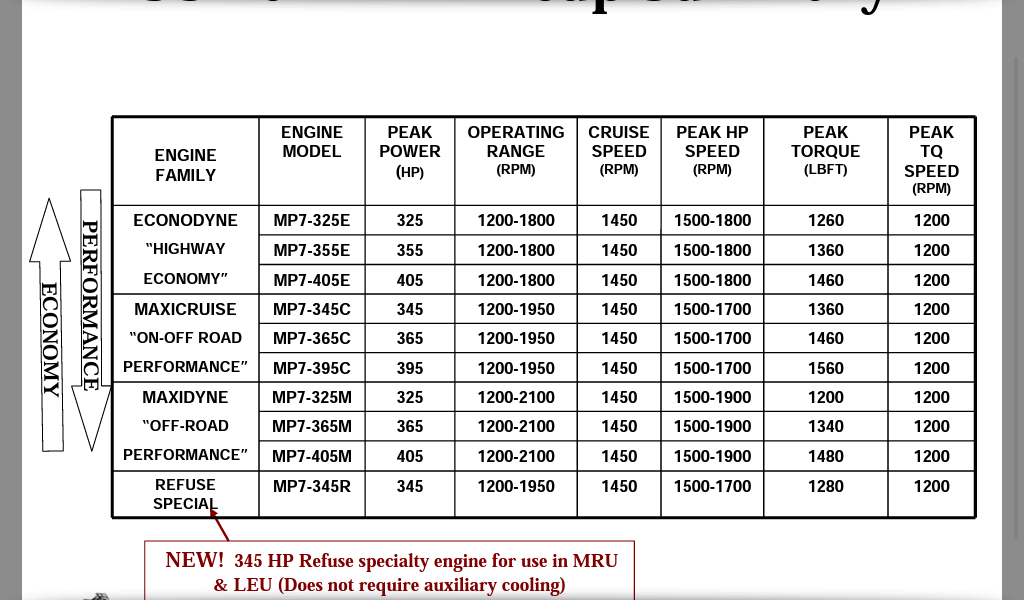

II though I had a brochure on my tablet with the engine specifics for the MP7, but now.I can't find it.
Tried Google and got a bunch of things, but not what I was looking for...
post-14397-0-12187500-1403969808_thumb.p
post-14397-0-33913400-1403969820_thumb.p
post-14397-0-87738300-1403969827_thumb.p
I don't know how reliable this info is, but seems about right.......
Says 1400rpm cruise for MP7 405-M, which is 90km/h in 8th gear (Eaton 8LL Over)......that would be why I get better milage hauling gravel out of Paris (max speed 80km/h + 10) than hauling a light load of trash out of Richmond Hill (max 100km/h on the 401, and electronically limited @ 105km/h)
