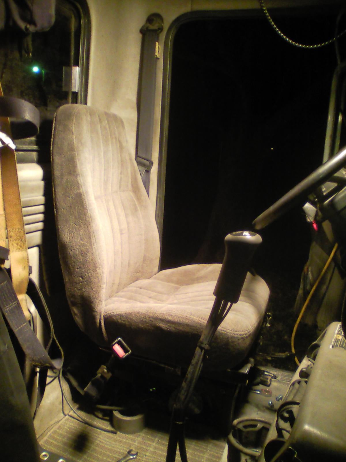

I was on a day trip down to Tuscaloosa...stopped about 30 minutes out to let Dozer out since I didn't know how long I'd have to wait before I could dump off. Anyway, I get back in the truck to go and the seat back is no longer locked in place. I managed to get it so that it wouldn't go back, but every time I'd lean forward, the backrest would follow. So, that seat had to come out. I still have the old seat that was in the truck when I bought it...but I pulled it out for a reason. It's wore out, none of the air (lumbar, etc.) worked, so it really didn't offer ANY support and was extremely uncomfortalble. Not only that, but it's a wide seat....and I'm not wide enough to fit in it, so the arm rest is a bit if a reach for me. I do still have the seat that USED to be the jump seat....I unbolted it from the base when I built a seat Dozer could climb up onto (he's not allowed on people chairs). The base, however, was not air ride...and had a convenient storage box...so I bolted Dozer's chair onto the OEM base. So, I had to figure out how to get a non-air-ride seat to bolt onto a Bostrom Talladega 915 air-ride base.
I think I got 'er licked.

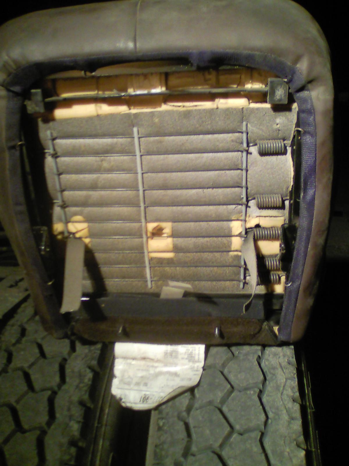

This was the bottom of the broken seat
post-1673-0-93003900-1362890369_thumb.jp

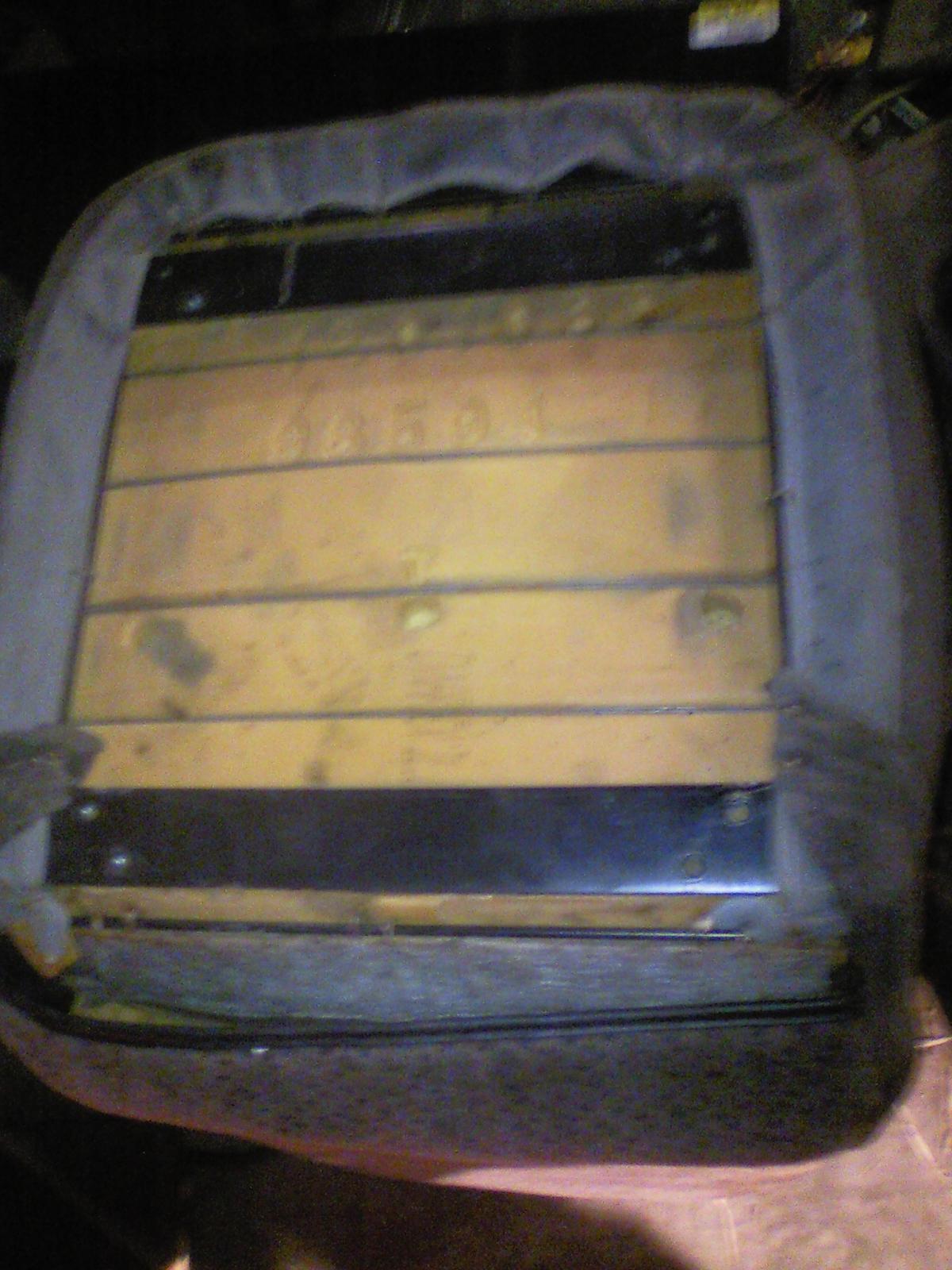

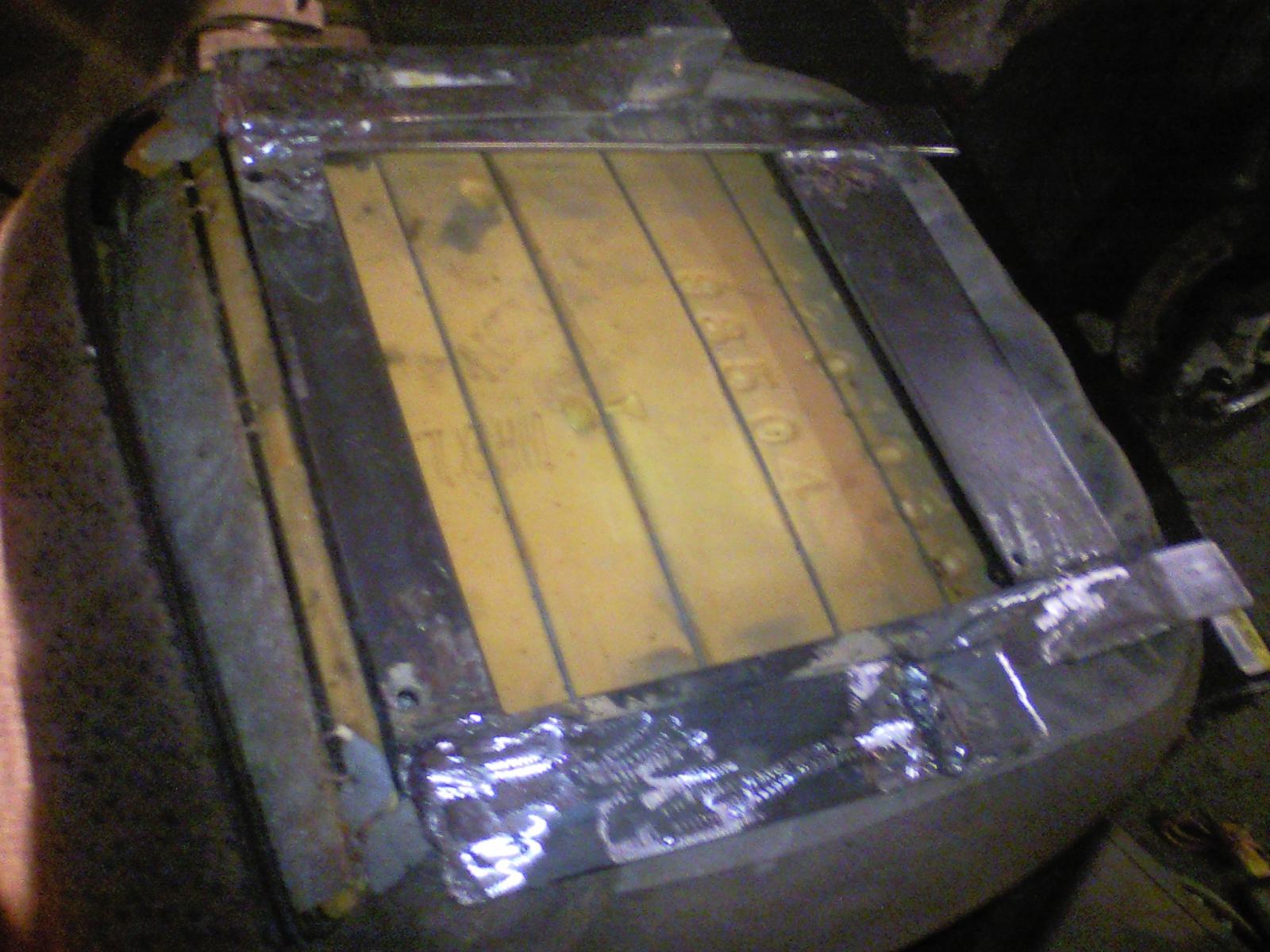

...and the bottom of the seat that I had to get to fit onto the air-ride base the broken seat came off of
post-1673-0-52196000-1362889804_thumb.jp

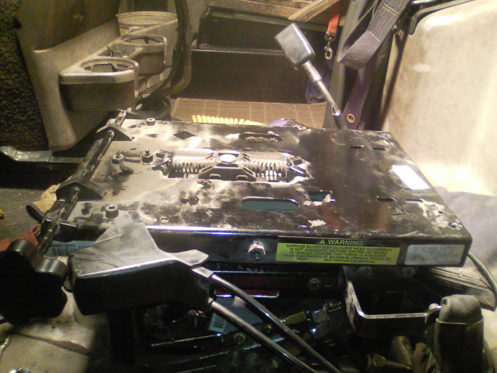

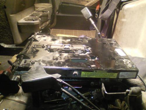

...the seatless air-ride base
post-1673-0-64559900-1362889879_thumb.jp

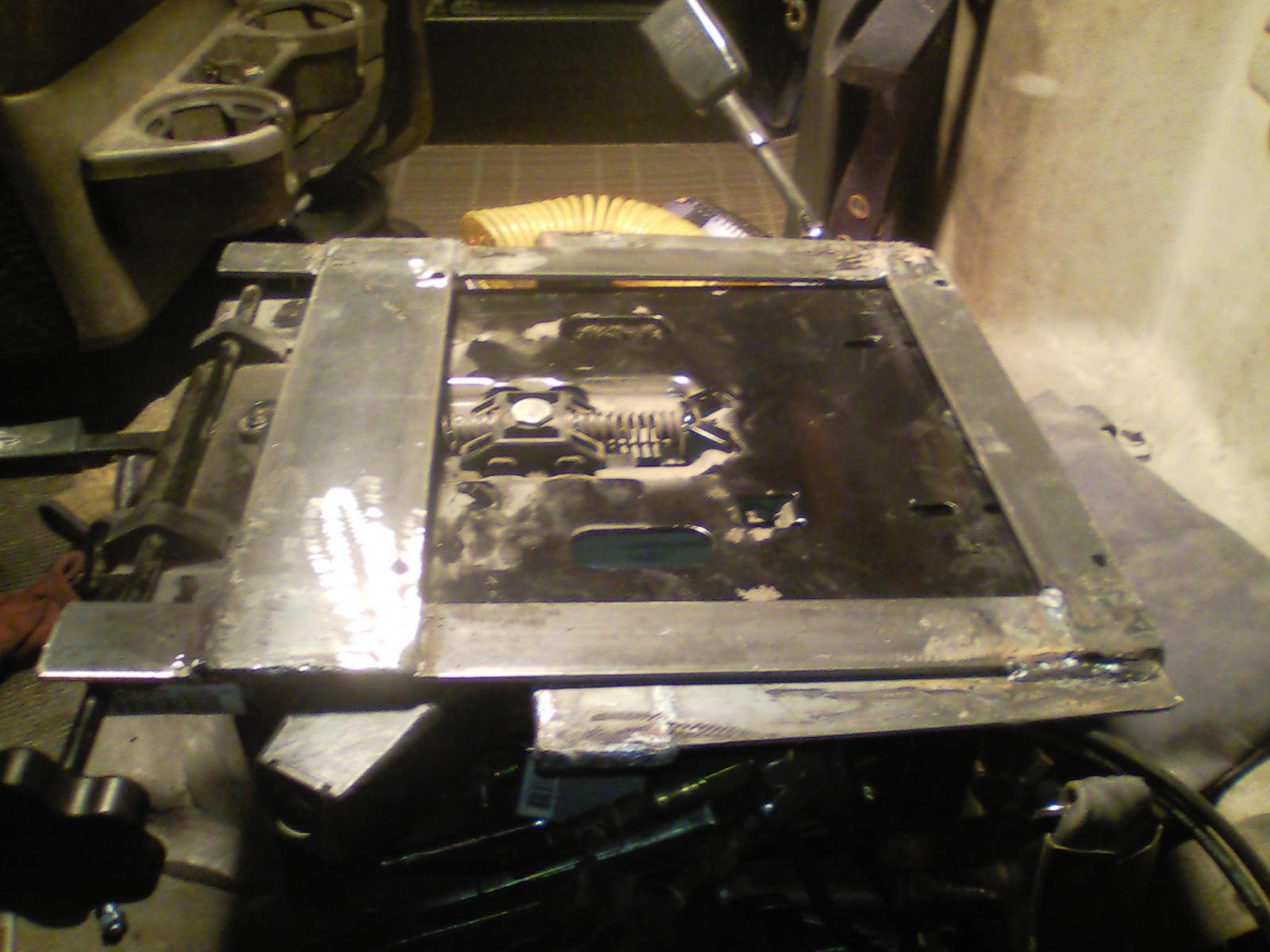

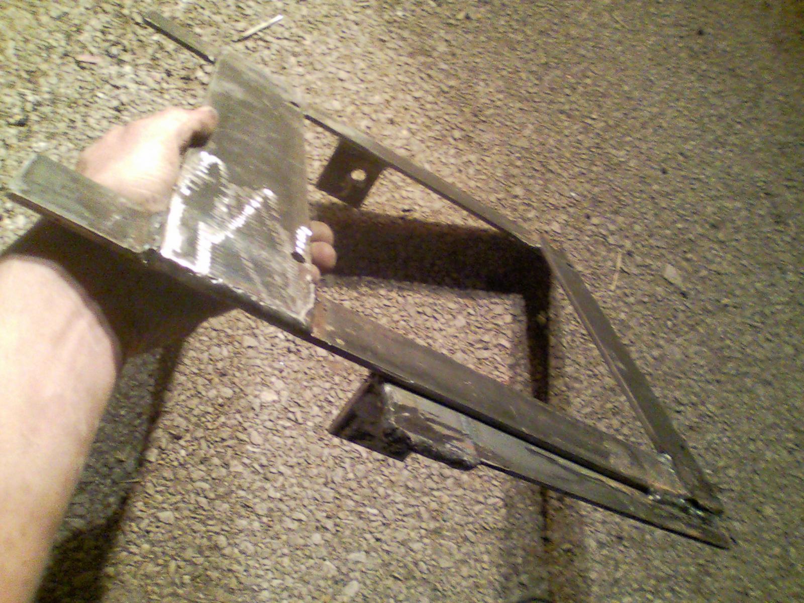

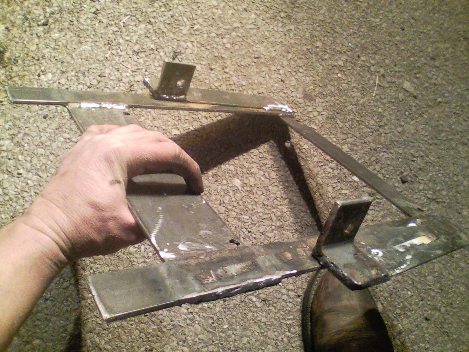

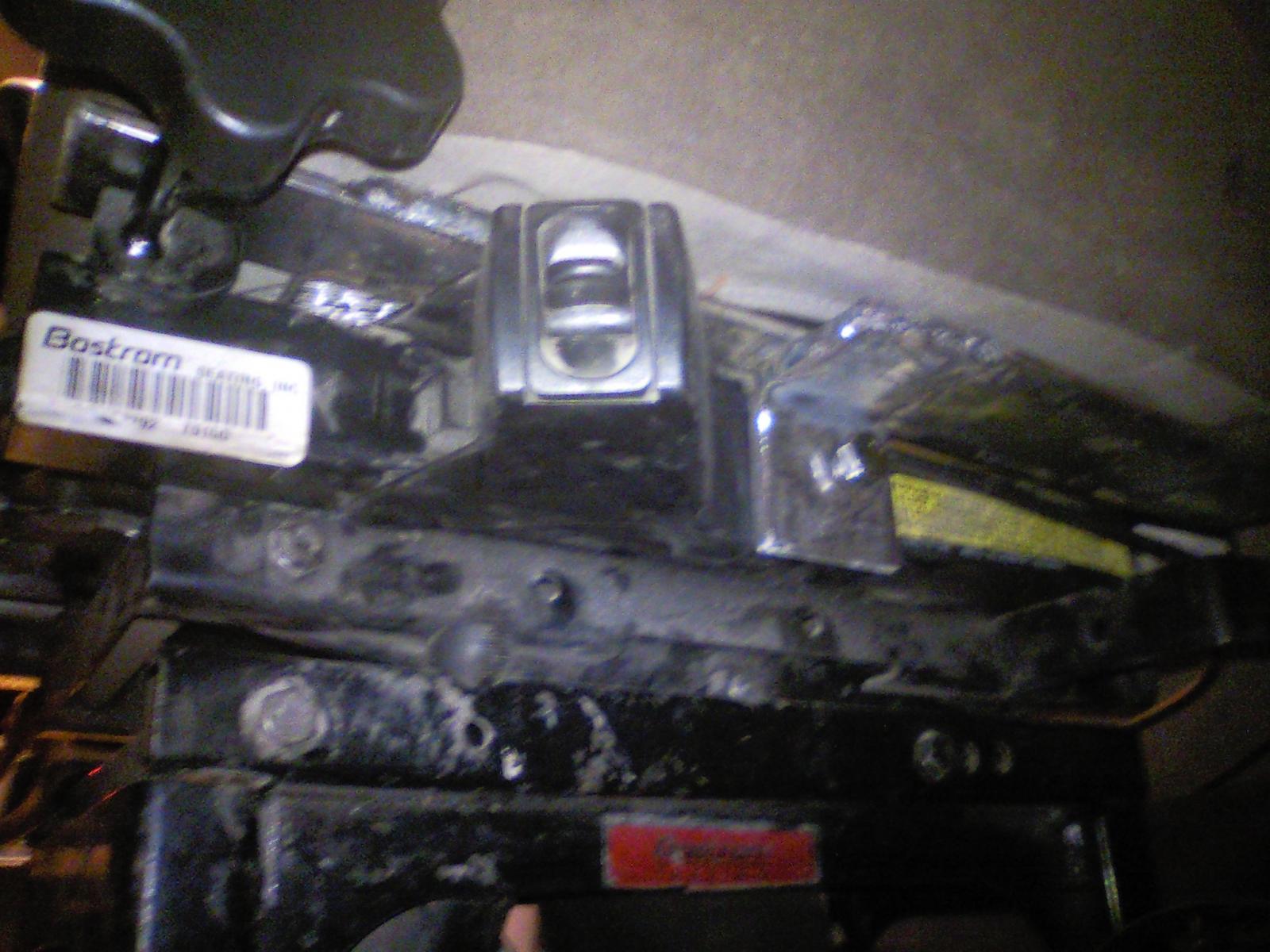

Adapter plate fit like a glove....
post-1673-0-49529000-1362889966_thumb.jppost-1673-0-85247300-1362890020_thumb.jp
Went together pretty easily
post-1673-0-38045600-1362890081_thumb.jppost-1673-0-12213400-1362890130_thumb.jp

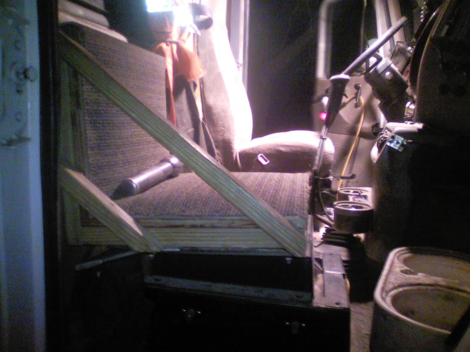

This one shows Dozer's seat, too.
post-1673-0-27882600-1362890179_thumb.jp
