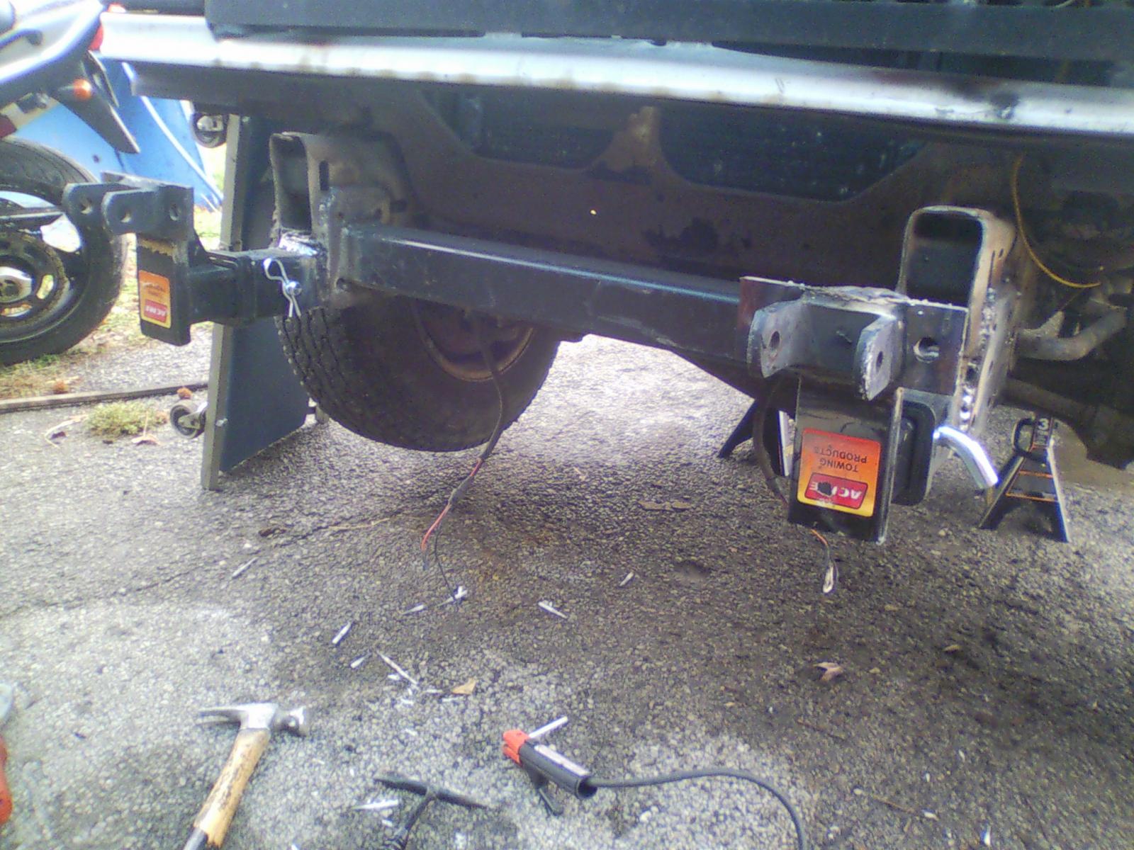

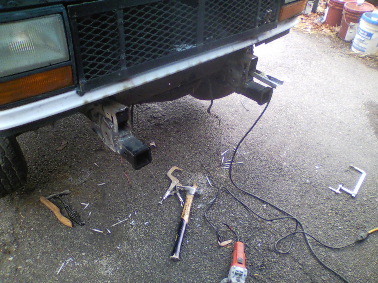

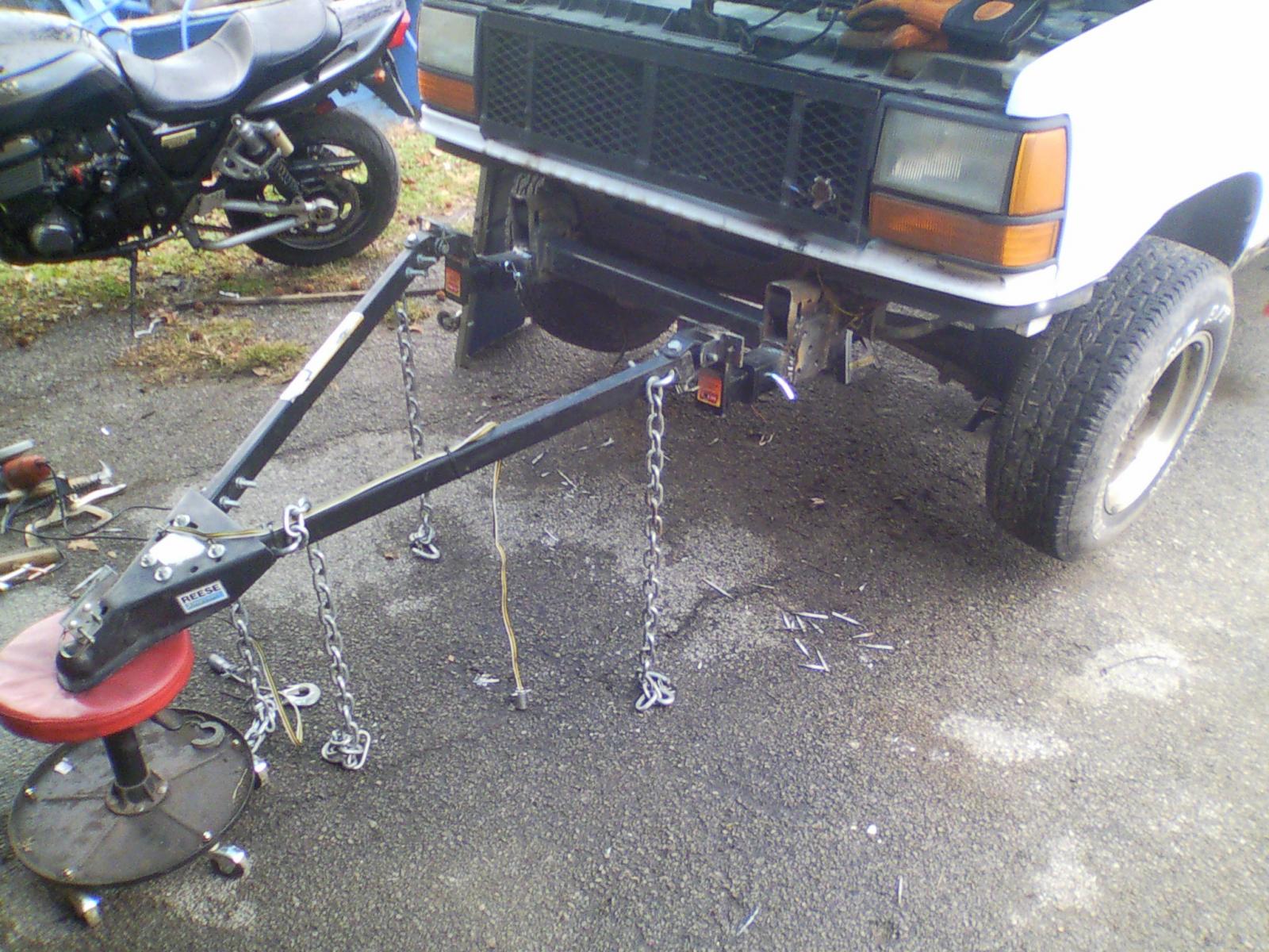

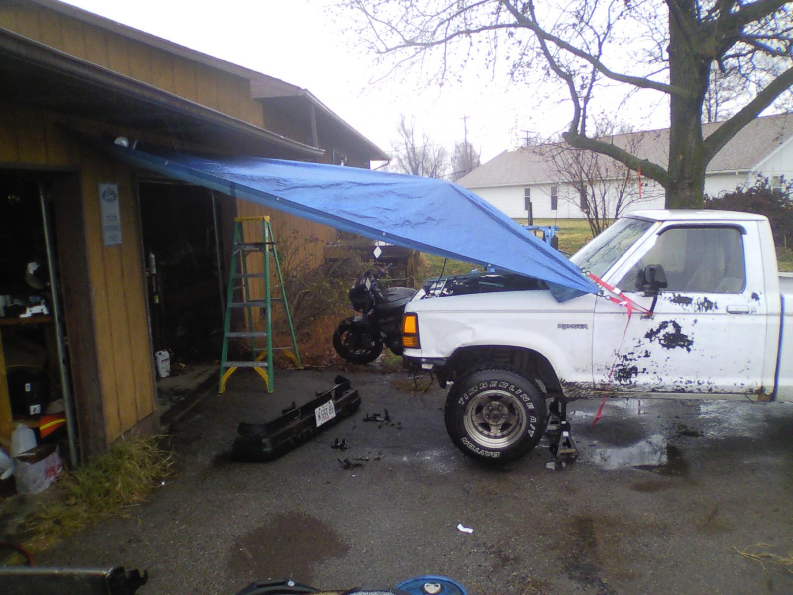

Damn near lost the Ranger on Friday when I dragged it behind the Mack to the shop for work....bumper was literally hanging by a thread by the time I got there. Luckily I use safety chains on the draw bar, but no telling if they would have been strong enough to prevent a run-away truck had it come apart on me. Anyway, I got back last night from a weekend on the road and decided I had better get it fixed.

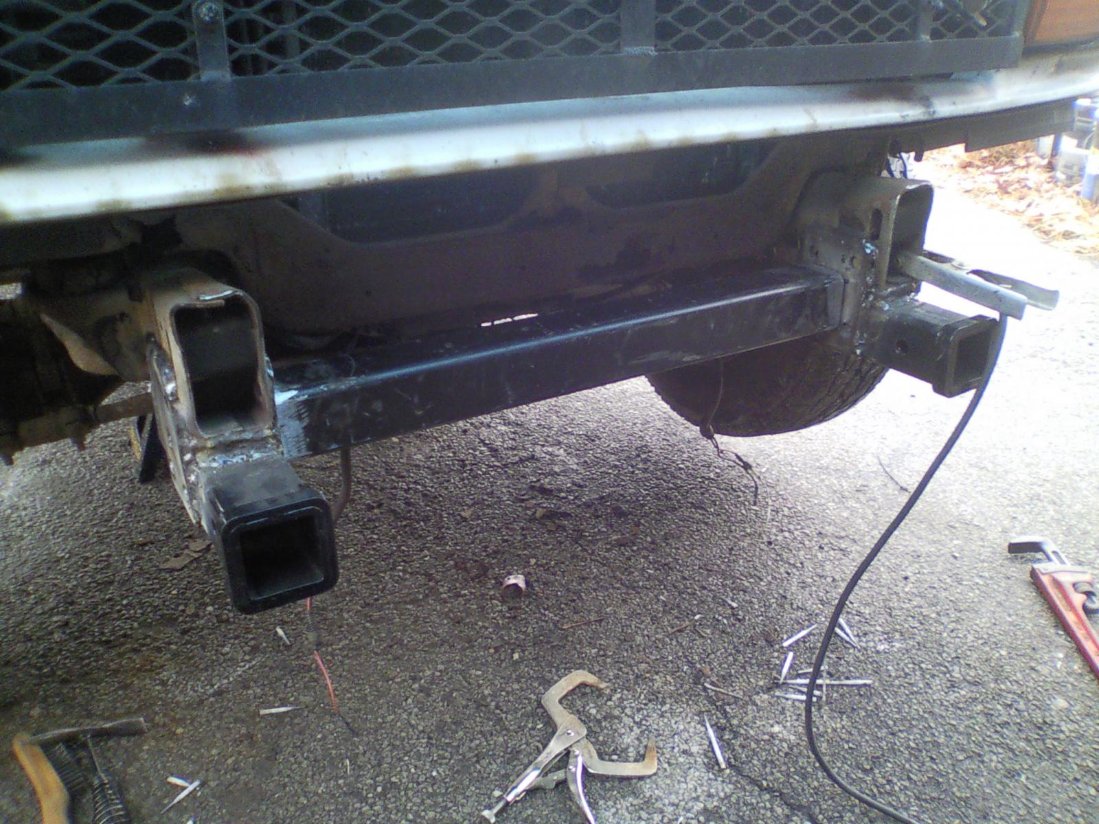

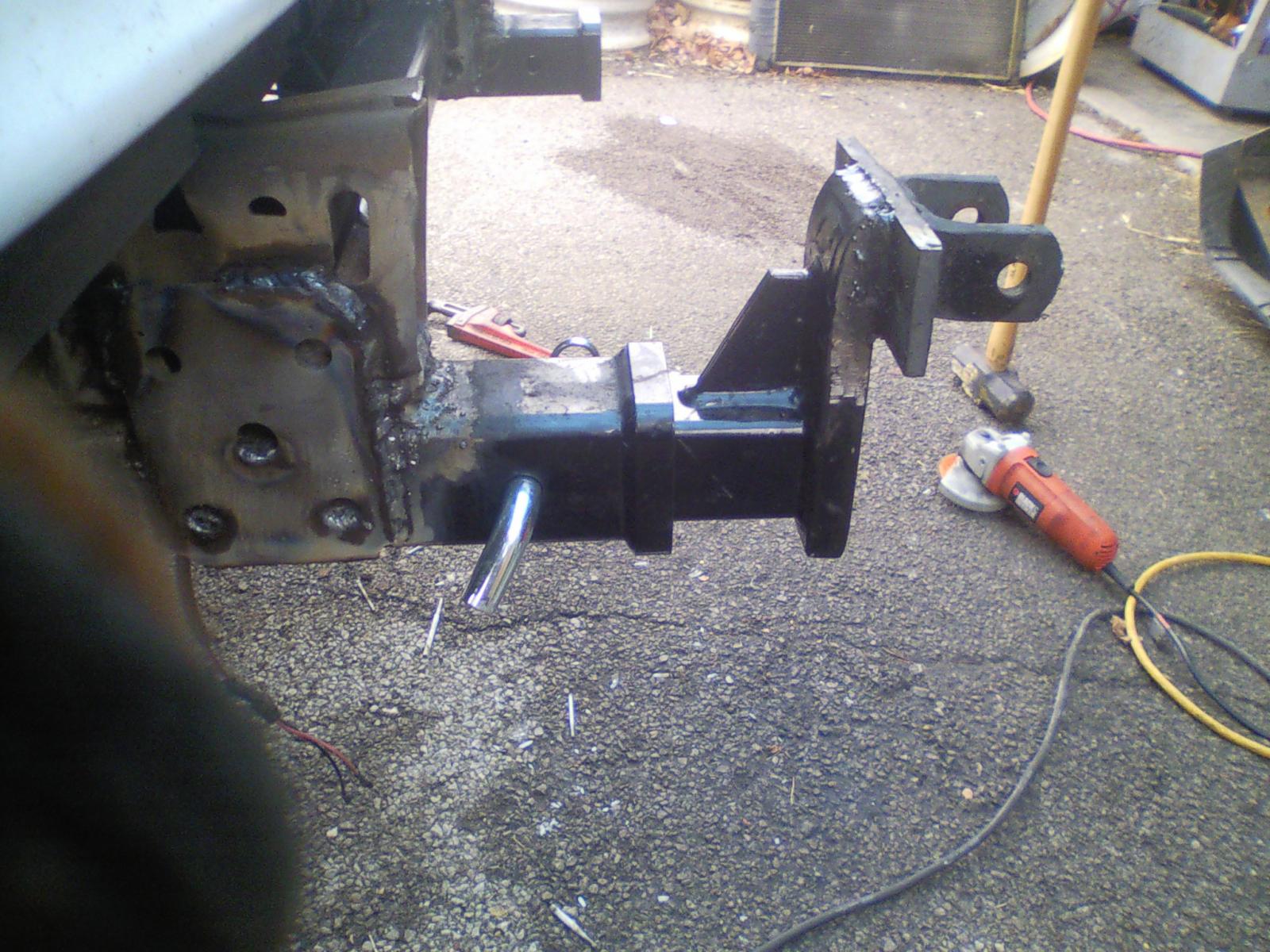

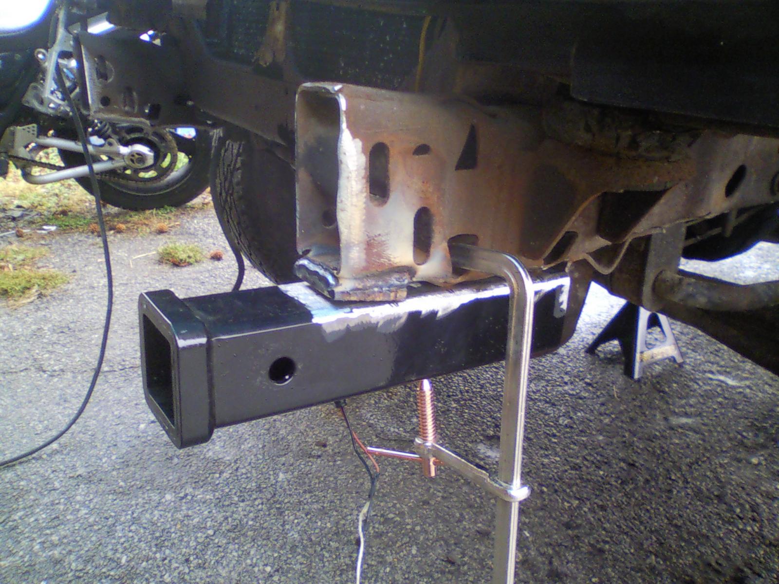

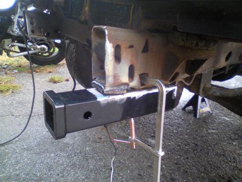

I started out picking up a few supplies on the way into town....a pair of 12" long 2" receiver tubes, a pair of 6" drop receiver hitches with a perpendicular drop (instead of slanted), and some spring tie plates. That and some scrap I had laying around I got to work with the power tools...

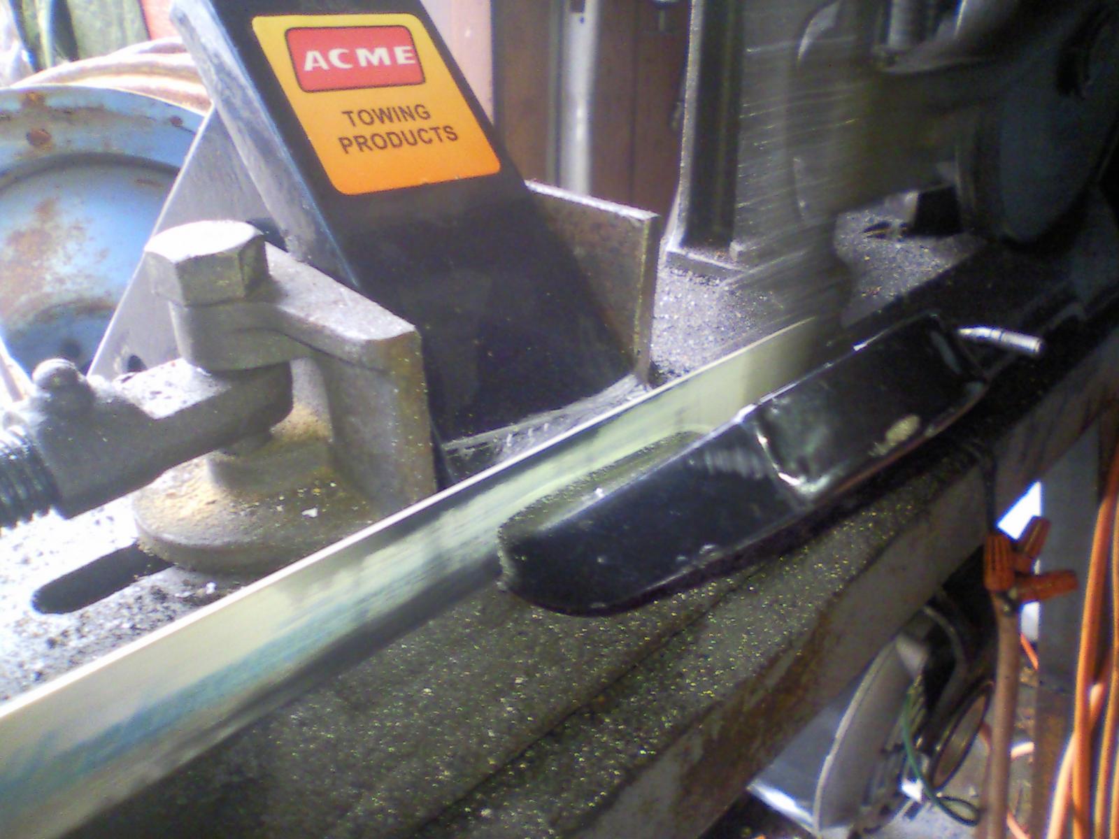

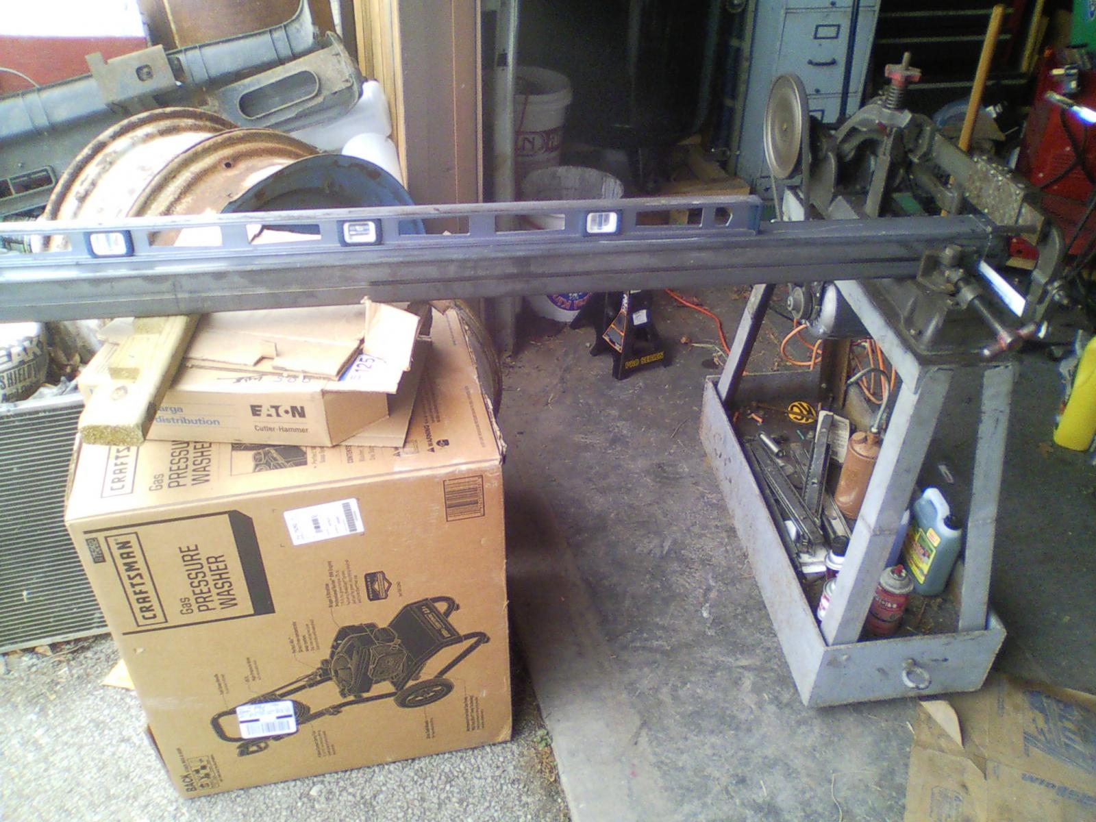

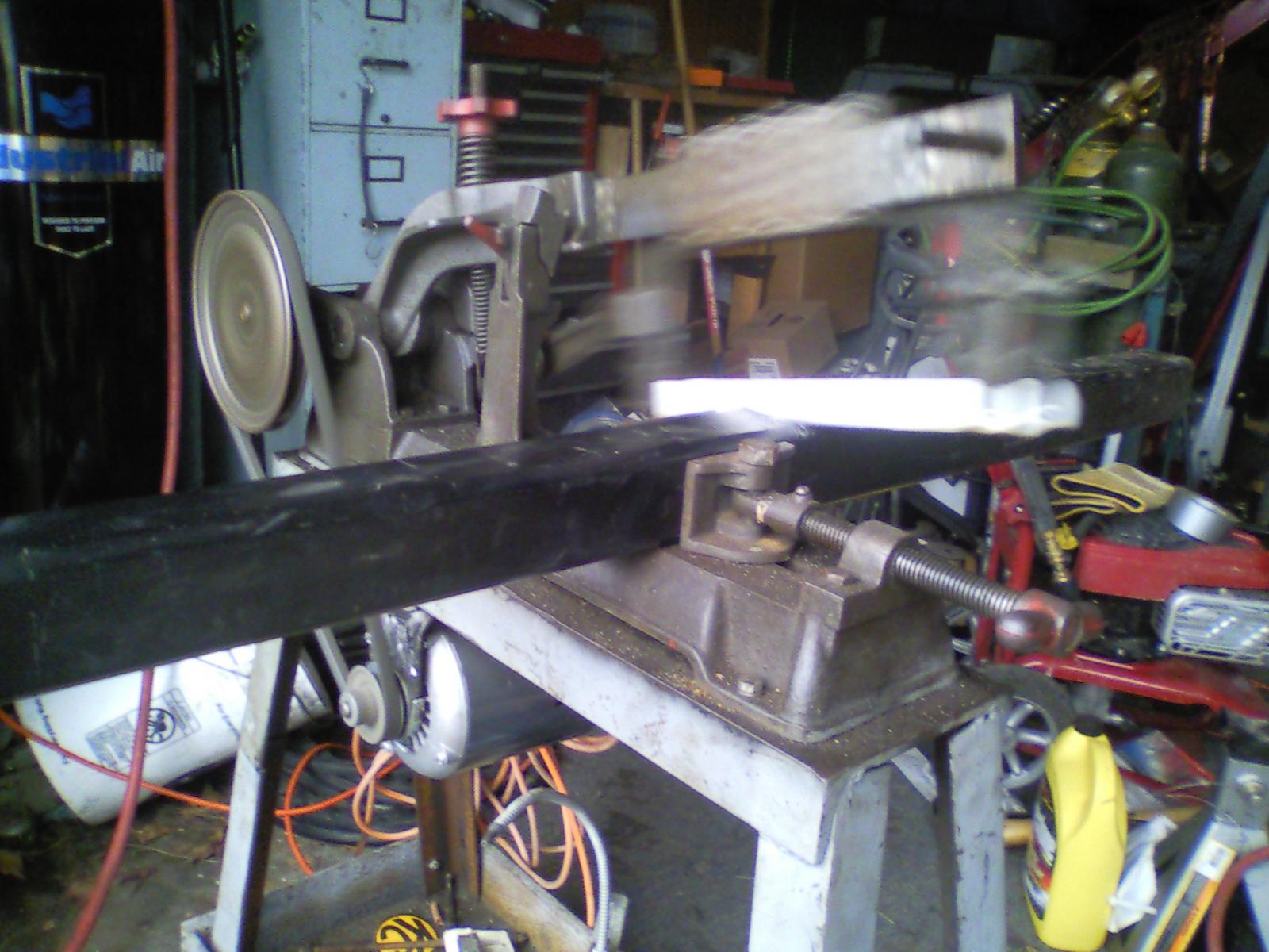

Gotta cut stuff to length with the power hacksaw. This thing is awesome....prefer using it to a cutting torch, since it makes a much cleaner & more precise cut. This WAS a 48" long piece of 2" receiver tube that I was cutting down to use as a cross member...

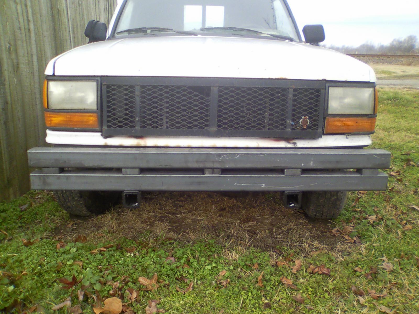

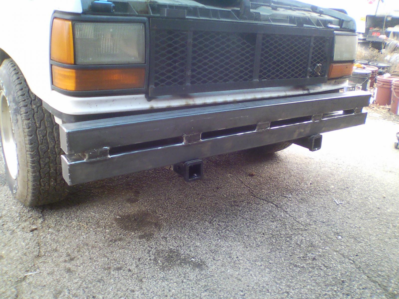

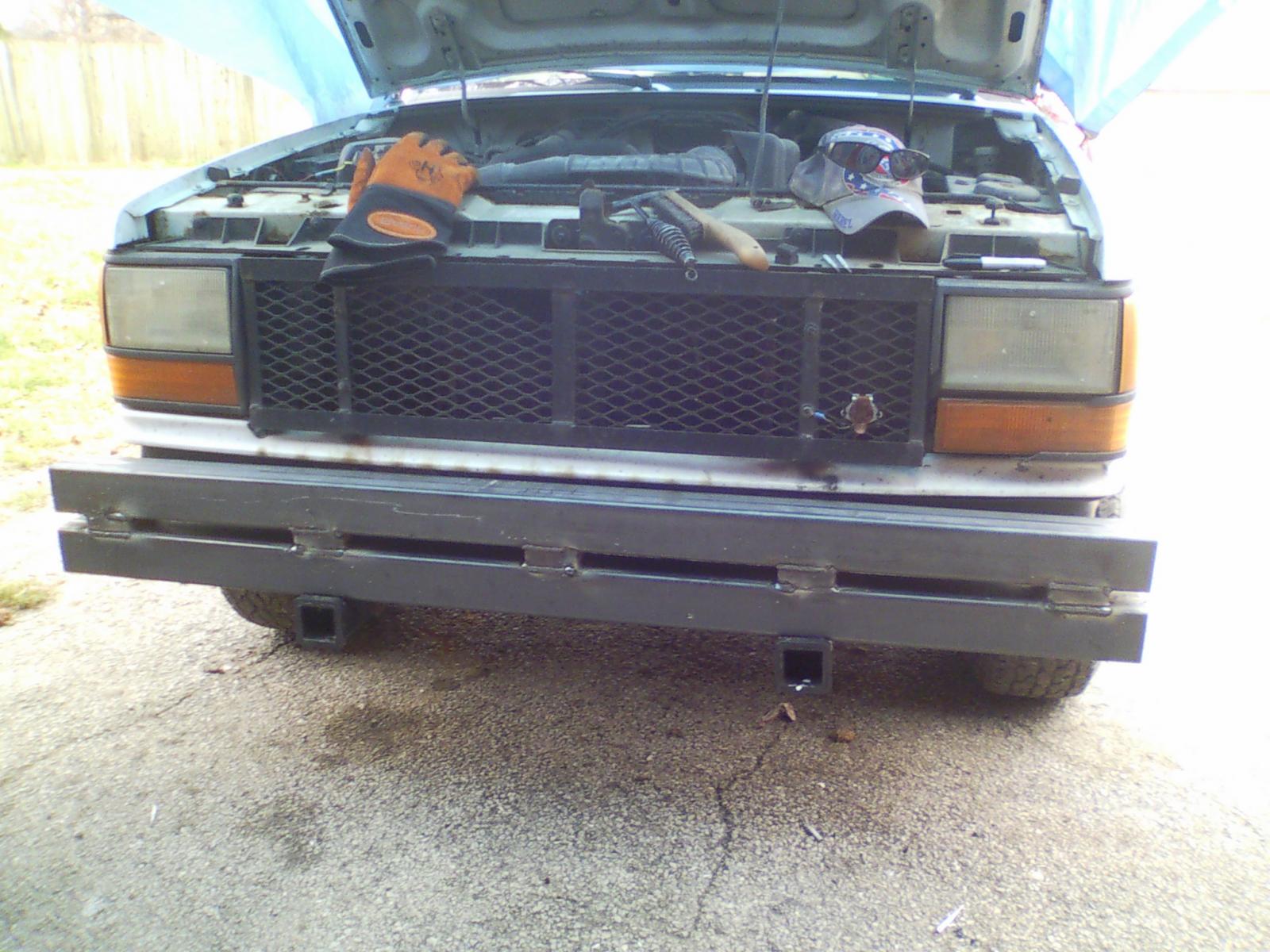

Going to stop by a metal fabricating shop to order (or hopefully pick up if they have it) a piece of 1/8" wall 2.5" x 7" x 66" tube to weld onto the front of the frame rails and the top of the 2" receiver tubes that I put on there today....that'll be my front bumper. I was thinking about using 1/4" wall, but that would be REALLY heavy, and I'm not sure the front suspension would be too happy with me if I did that. It'll still be the most bad-ass Ranger bumper on the road.
Yup...he told me they were superior products, so I went ahead and decided to give 'em a try.

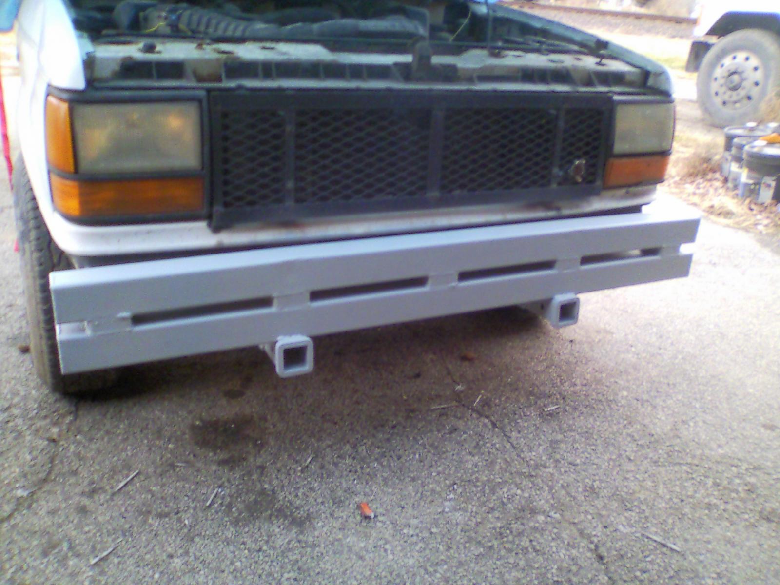

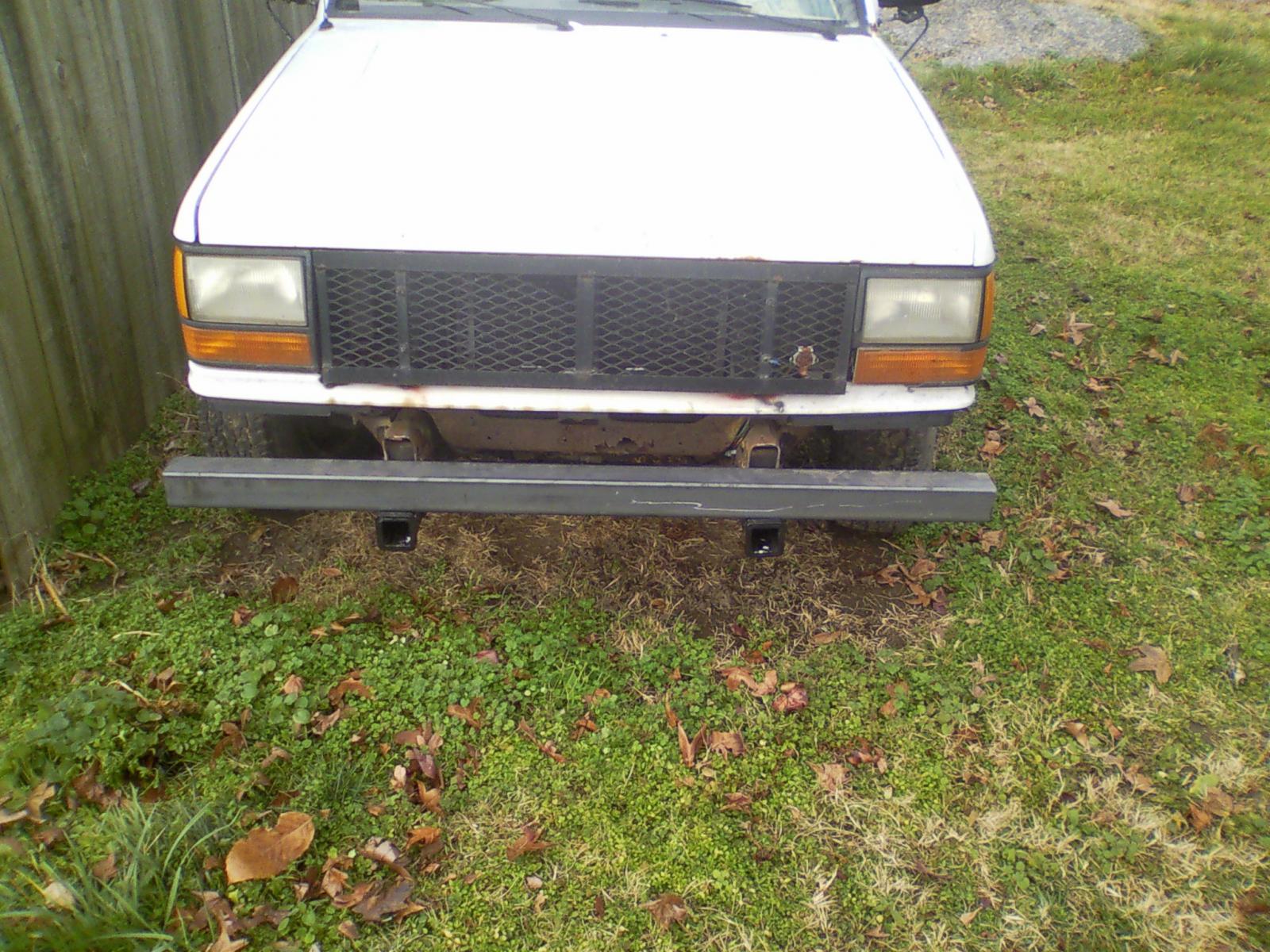

Anyway, I just picked up a pair of 1/8" wall 3"x3" steel square tubes to build a front bumper. I'm thinking I'll trim them in 1" increments so I'll have some 3"x3" risers to separate the top from the bottom (and give me the 7" tall bumper I wanted)...think that'll look better than just welding the two together. Whichever way I go with it, though, it'll be the most bad-ass bumper ever to be seen on a Ford Ranger.
Yup...when I told 'em I wanted a 1/8" wall piece of 2.5" x 7" steel tube, they said the only thing they'd have in that size would be 1/4" wall....which would work if I were building a bumper for the Mack, but the Ranger already has a hard time hooking up on wet pavement...don't need to exacerbate that situation any more than necessary.

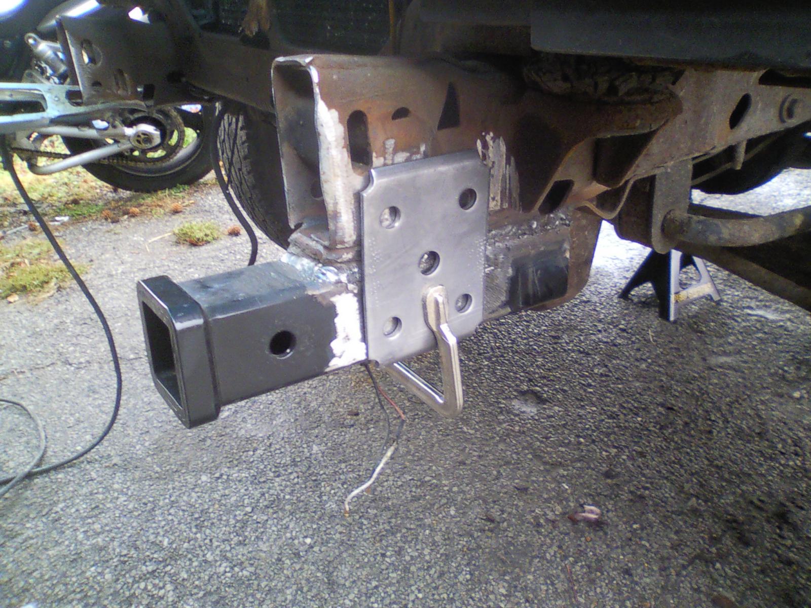

I didn't weigh anything...but the main bumper didn't FEEL all that much heavier than the OEM bumper. I'm sure it IS heavier, but since it's all 1/8" wall tubing it isn't too bad. I'd be willing to bet the draw bar hitch components weigh as much as the main bumper....that's all 1/4" stuff. A pair of 12" long 2" receiver tubes, 4 spring tie plates for 3500# axles (cheap, quick & easy fishplate material to reinforce the weld between the frame rail and the receiver tubes)...and then the 6" drop receiver that the bumper draw bar attaches to. That's all pretty heavy stuff...but the main bumper wasn't anything to pick up and carry around.
