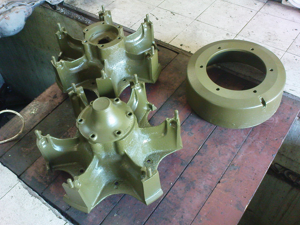

If plan to sandblast hubs wash all the grease off from the bearing cavit.
I saved a time not dismounting outer bearing cones but had to remove them after blasting.
Sand fixed up on a grease that came from little canals behind the cones so I needed to wash the hubs again.
post-3971-0-88884600-1354203968_thumb.jp
One note on powder coating. Cover any threaded stud or bolt hole or you will end up with grief. The powder coating is a bit&h to remove so you can install nuts or bolts. I learned that the hard way on my AC rear axle and trans-axle assemblies. Paul
Thanks fellas! I have decided to just go through everything and then do the powdercoating while it is taken apart! Thant way I know that it is all good to go. Thanks again for all of your help! This is my first heavy truck and am learning by leaps and bounds
