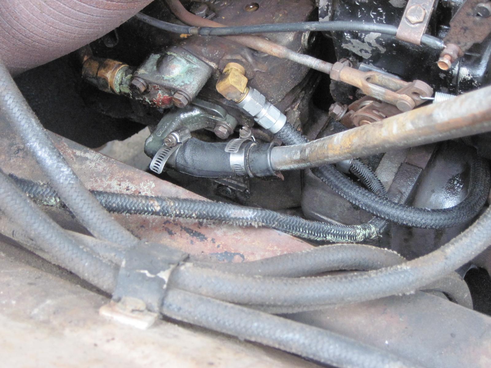

After a little head scratching I notice the governor line to the compressor has been rubbing on the frame and looks to have a small hole in it, Aha!...
I convince myself that is why it was failing gradually, as the hose wore on the frame...makes sense

Back to the parts store...can't bring myself to pay 45 cents/inch for steel braid so opt for plastic hose and new fittings...
$8 for 3 feet tubing and two fittings...
Get the hose routed all pretty and away from the frame, everything looking peachy...WTF? It is still doing it?

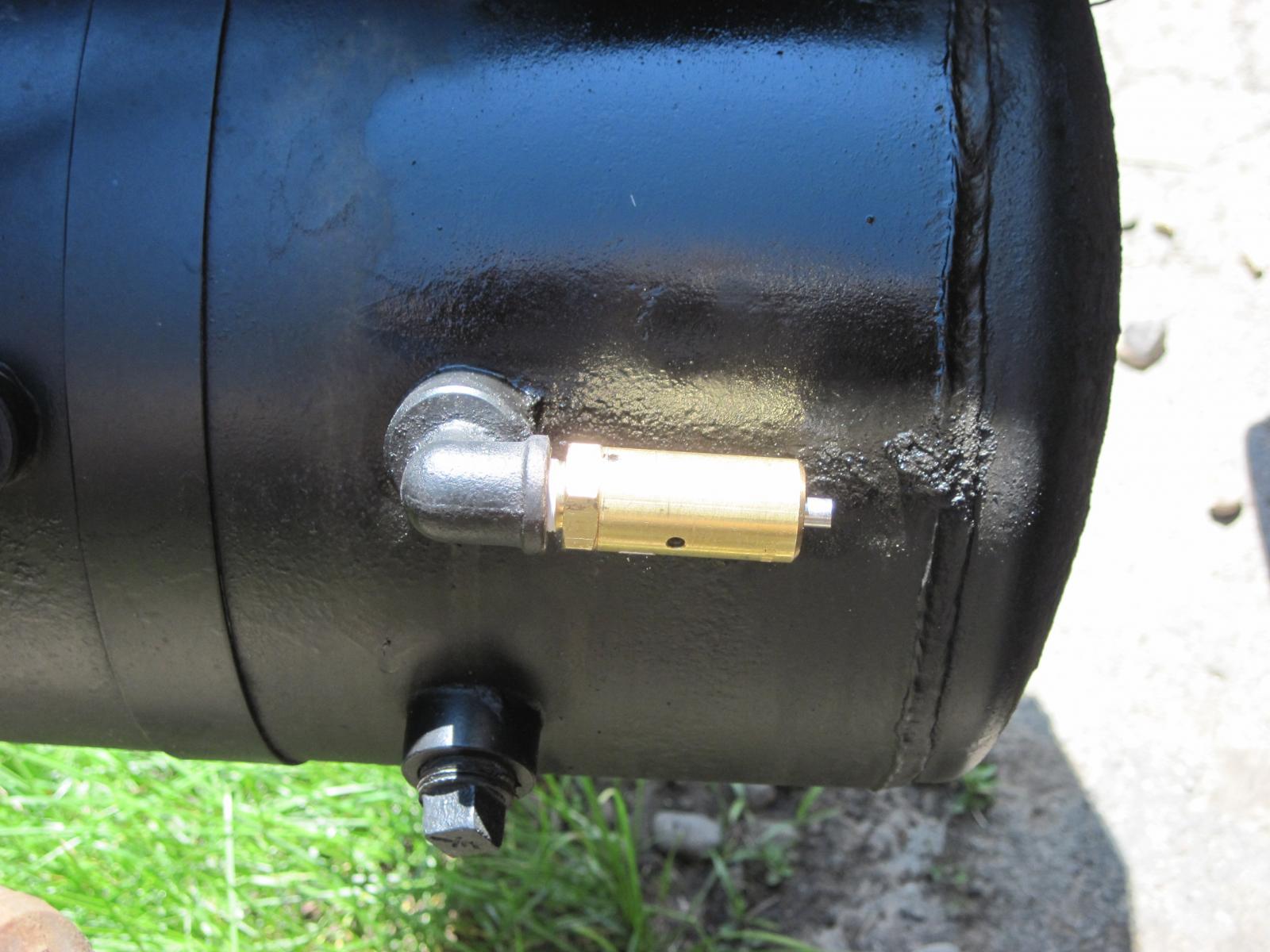

Sit in the cab with the engine running contemplating hari-kari,,,,wait a minute, it is popping off just under 130, shouldn't it be 150?!?
Go back to the tank an hold the safety valve in, it takes about 1/2 second for the compressor to unload...this mutha#%$%^#$$%SOB!
Back to the parts store for a new safety valve, $8 more dollars... Of course this solves the problem!
post-6773-0-35942800-1339621429_thumb.jp
So I gained considerable knowledge and learned a valuable lesson and it only cost $34!! Even better, Truck is back on the road!!
