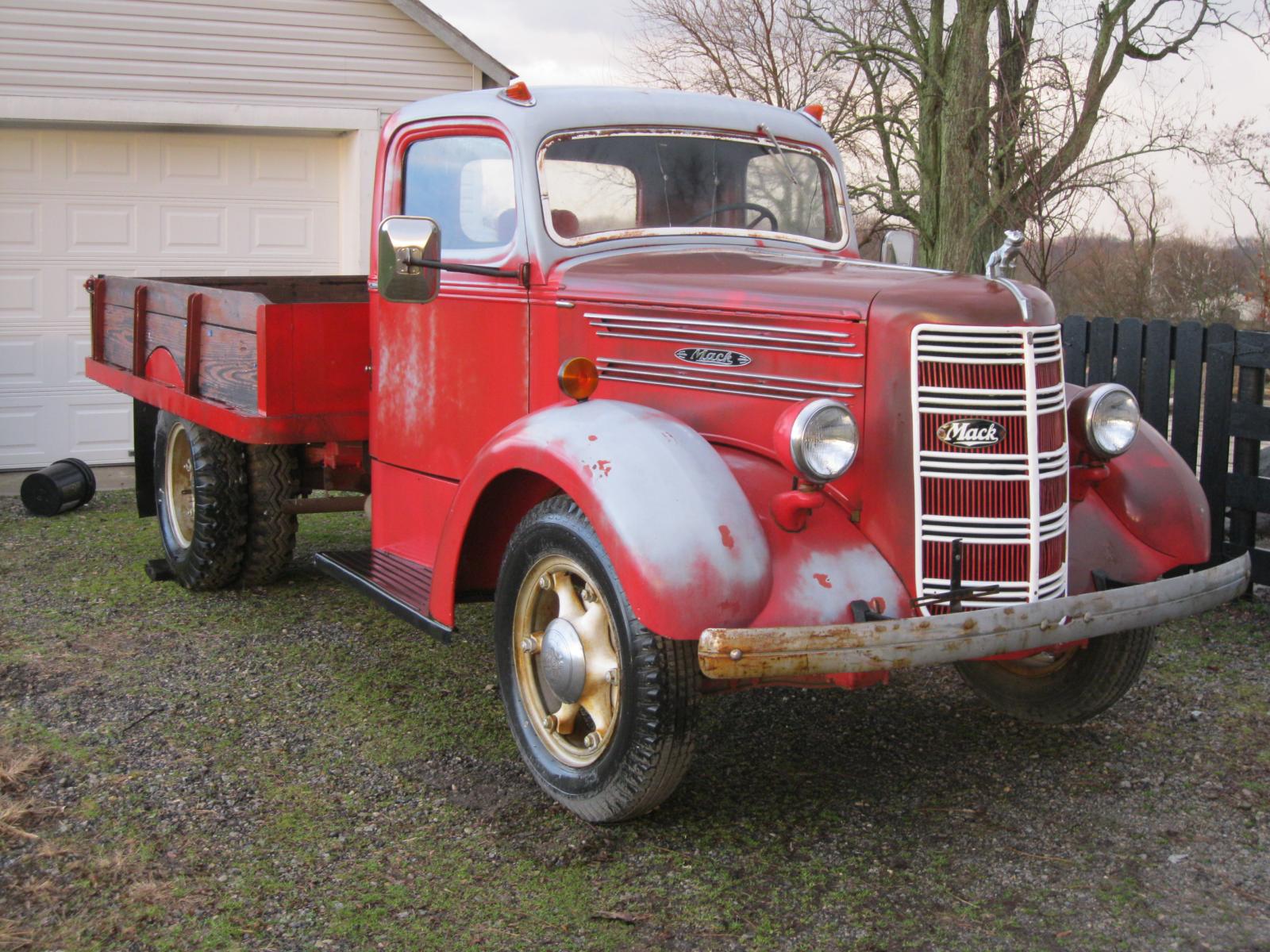

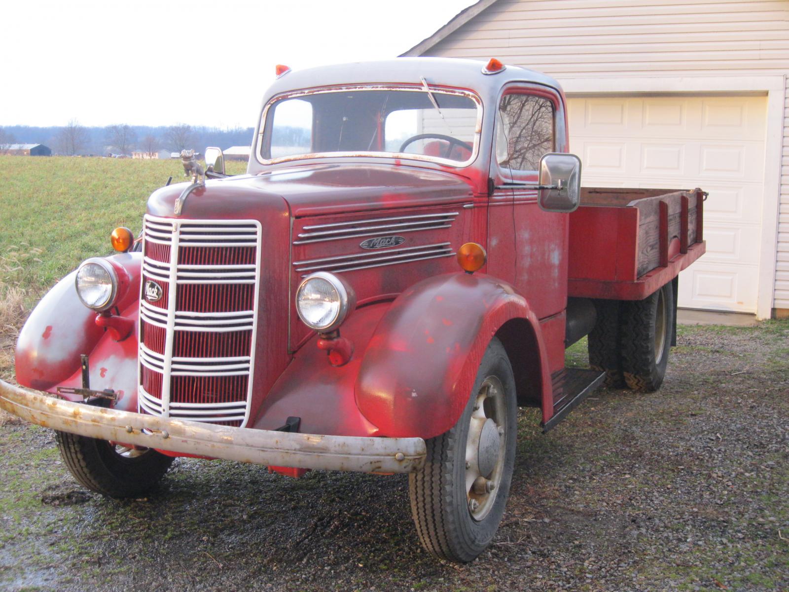

I recently bought a '41 Mack EE. The previous owner put a 300 ford motor in the truck. The vacuum line to the manifold was disconnected when they replaced the motor and was not hooked back up. I don't know if the vacuum pump needs anything (new diaphragms, etc.), but would like to know if and where I could take it to get rebuilt. If its not worth rebuilding, is there a system comparable that I could replace it with?

Hi Tymack, that's a really nice EE. It never ceases to amaze me how good original-looking trucks like that continue to survive. Is she an older restoration or was she retired and well stored?

Thanks Andy in West Oz, I am really blessed to have found such a clean truck. Only 20 miles from the house! It has never been restored( a little primer over the bare paint) just stored well for a while. It has 58,000 miles on it. and most of those were off road hauling trees at a nursery, before that it was a fire truck. The previous owner added a dump bed. I plan on getting it running and maybe down the road paining it. I think it looks good in its work clothes. I will register it.

Truly superb, tymack. Just amazing. Her VIN should be on a tag on the passenger's seat. If she's missing that (doubt it going by the rest of her!) it should be stamped into the right-hand chassis rail behind the rear spring hanger (or in that general area).
I get excited by a lot of trucks but this one truly warms my heart. Magic stuff. She does look good in her working clothes.
