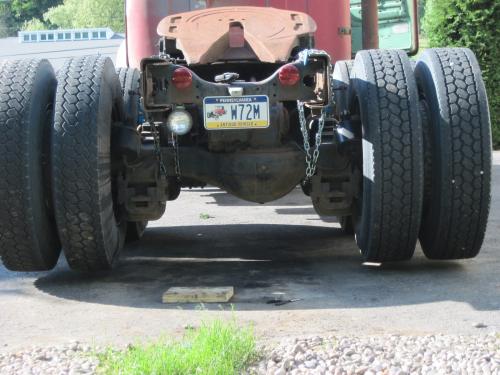

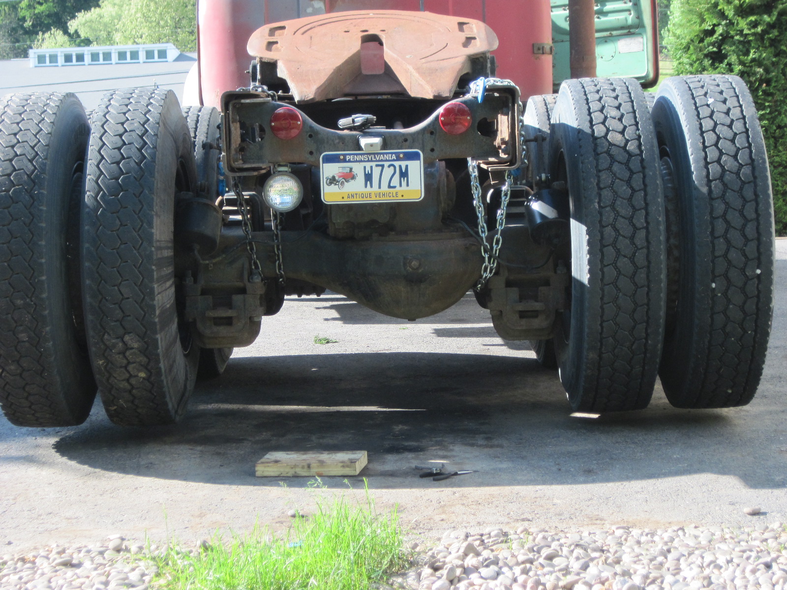

Desperate to figure out what is making my truck bounce...I came up with an idea to check the rear rears to see if they were causing it, also, this would check to see if the "peanuts" were the root cause. My plan was to chain the rear rear up off of the ground and go for a drive...
Okay, I thought, this idea is dumb, but is it just a dumb idea, is it an idea that will get me hurt, or is it an idea that will break something major...anyhow, I decided is was just a dumb idea so I tried it...
Got the rear rear jacked up and chained it up so that the rear tires were off the ground by a few inches. I knew they would drag where my driveway meets the street, but I figured I would release the parking brake and let it roll into the street...so far so good...I got about 1 mile from the house, not yet having a chance to get to "bounce speed" when the chains shifted, stretched, whatever the case, the rear tires dropped down and partially contacted the road and the front rear or transmission started growling and shaking...got it stopped pretty quick...I was on a slight hill, and the tires were not up high enough to slip on the road with the park brake on, and not getting enough traction to move the move truck with the brake off....couldnt even set the parking brake as the truck kept rolling (slipping the rear tires)...to make a long story short, I got it chocked and because I was smart enough to bring the hydraulic jacks just in case, I got the rear end back on the ground...then drove around a while to make sure no strange noises...so back at square one...

I don't think it was a dumbass idea but am surprised it worked. I would have thought the torque bias would have been routed to the axle that is off the ground causing it to spin. Of course with you not hammering the throttle there was probably enough preload to not let it slip. I'll bet if you would have asked for hard acceleration it would have been really loud as the peanuts started skipping from the slip of breakover torque.

I had the rear brakes locked...that's how I got it to move...had I released the brakes, I would have went nowhere! I figured if I moved it with the rear driveshaft not turning, all of the torque would route to the front and the peanuts would not be trying to dig in and engage, which may have been causeing the truck to bounce...that was my theory anyhow!

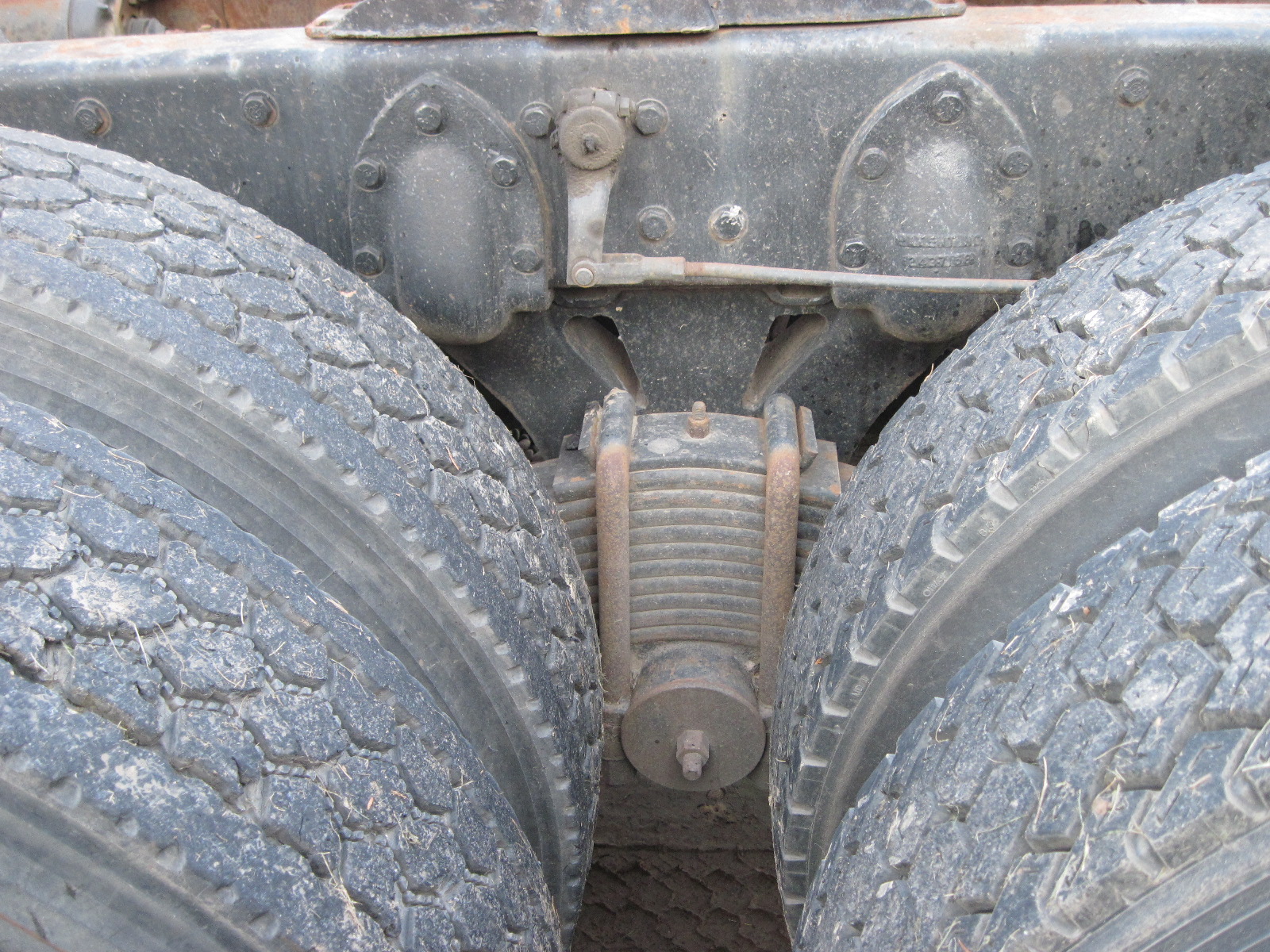

That makes sense. Your spring brakes are on the rear drive?

Yes...on the rear...

I can't reason that this would do any good on mechanical parts involved. The inter axle power divider would be 100% slipping all the time and this would seemingly rapidly cause wear to the cam and plungers from this slippage. I may be incorrect but it sure seems this thing is going to try to keep the differentials together.

You are right of course, my reasoning was that if the power divider was jumping in and out at a certain speed, and my tires were average different diameters front to rear, this might be the cause of the bounce as the frame is loaded and unloaded rapidly...it was just a test, as I am sutck unless I starts chainging BIG parts!
I was thinking of having it towed with the front end up to eliminate or confirm that the front end is causing the issue...lots of wasted money on that though!

The drive tires really do need to be within 1/2" diameter of each other on the rears to not induce problems and if yours are different in height by much, they need changed. I never really put a lot of thought to it until your photo of the axle chained up. I was thinking since you replaced them, they all matched.

Have been going to get my wife and son to video in "chase" mode from different angles...unforturnatly, only six of the eight rear tires match, two are a different brand, BUT. the problem was happening before the new tires, not to say I didnt "swap" the same problem between the old and new tires...
They really don't have to match as far as tread design. They do need to be round with no flat spots, (as in skidded) or out of round. They must be the same in diameter on all four corners.
