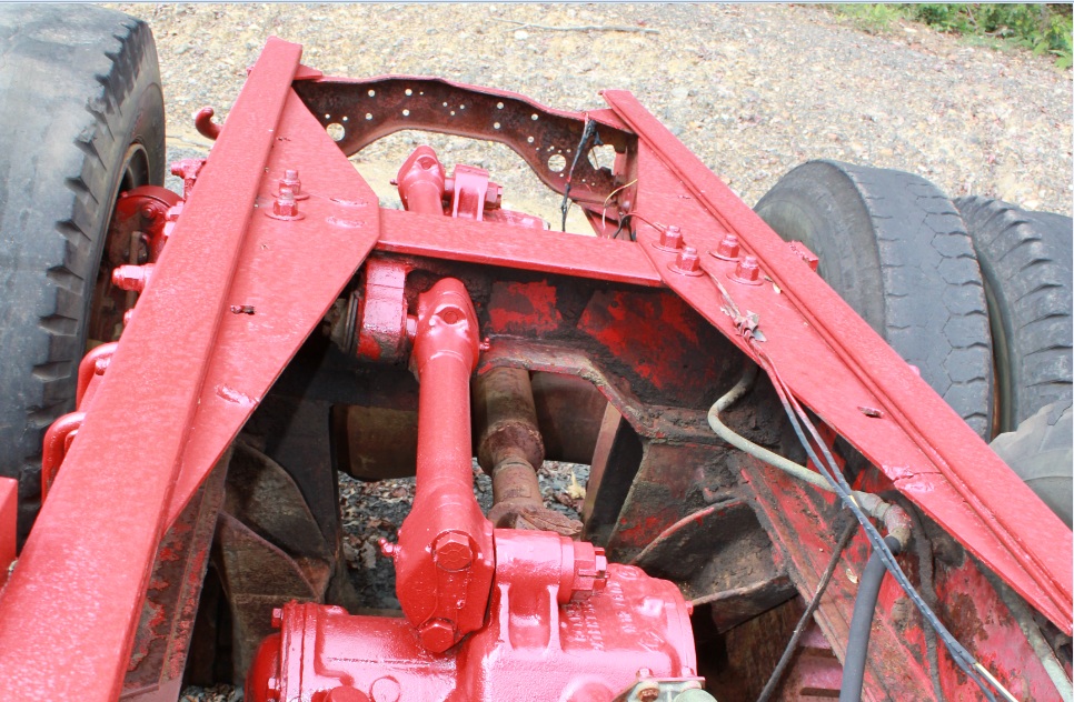

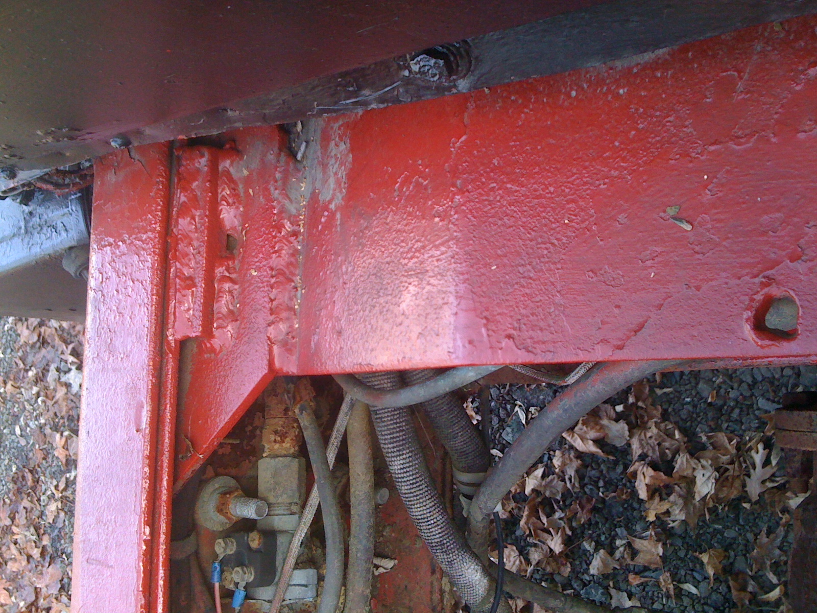

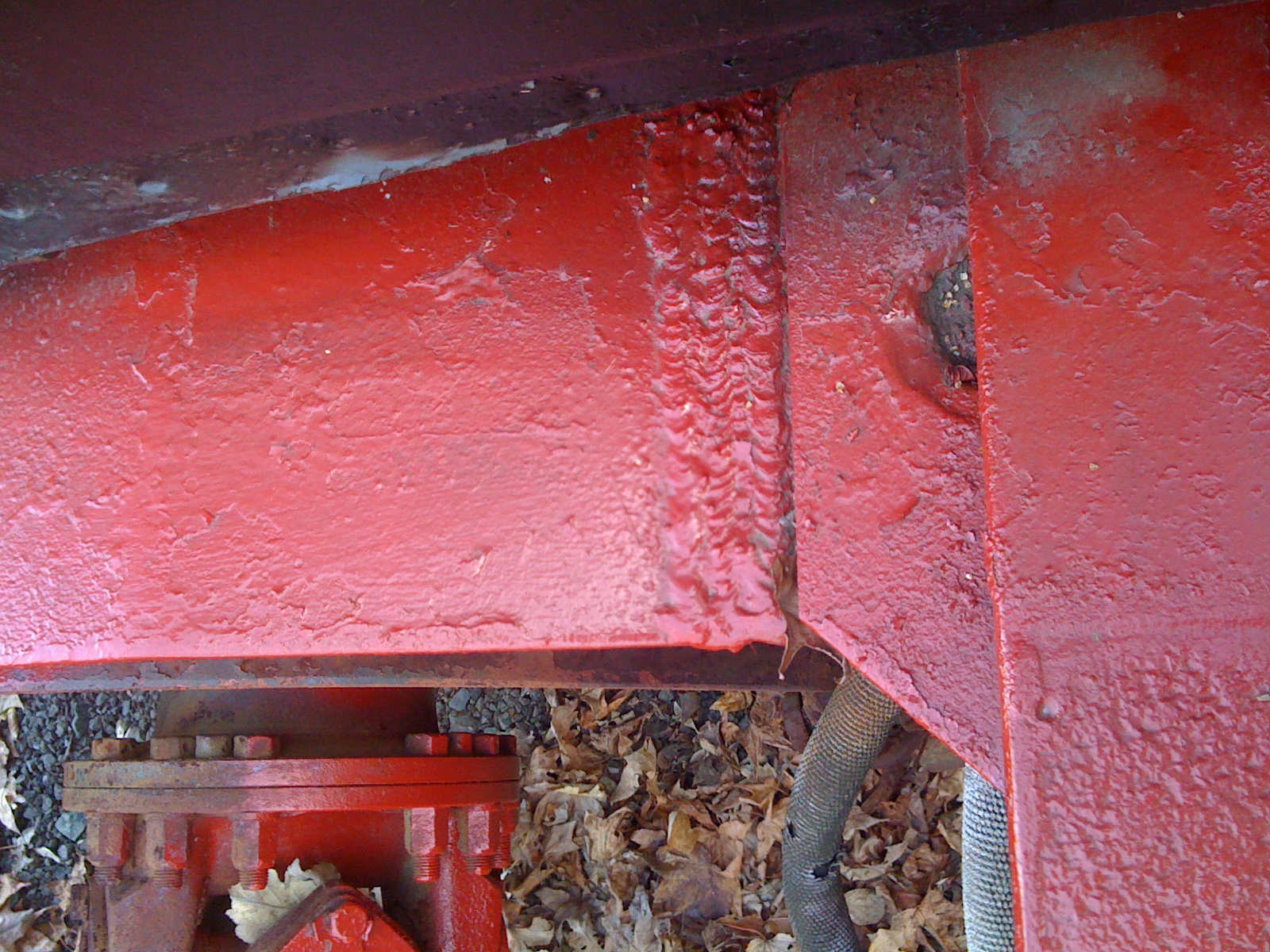

Cab cross members cracked.
The cross member behind that is a I beam with a 1 inch thick flange (who ever built it did one hell of a nice job).

I would weld up the cracked crossmembers myself.

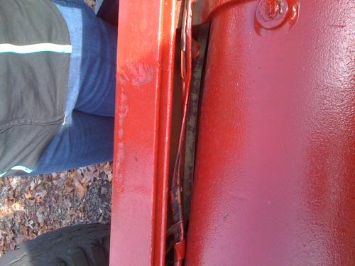

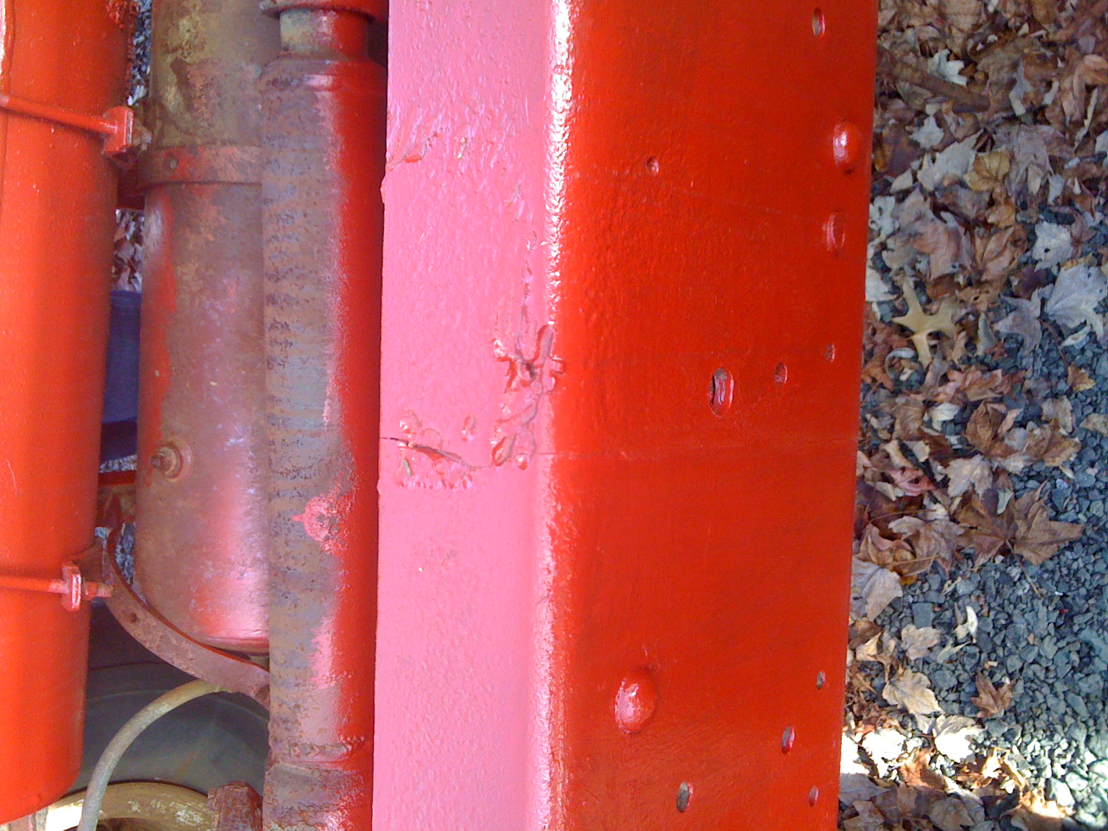

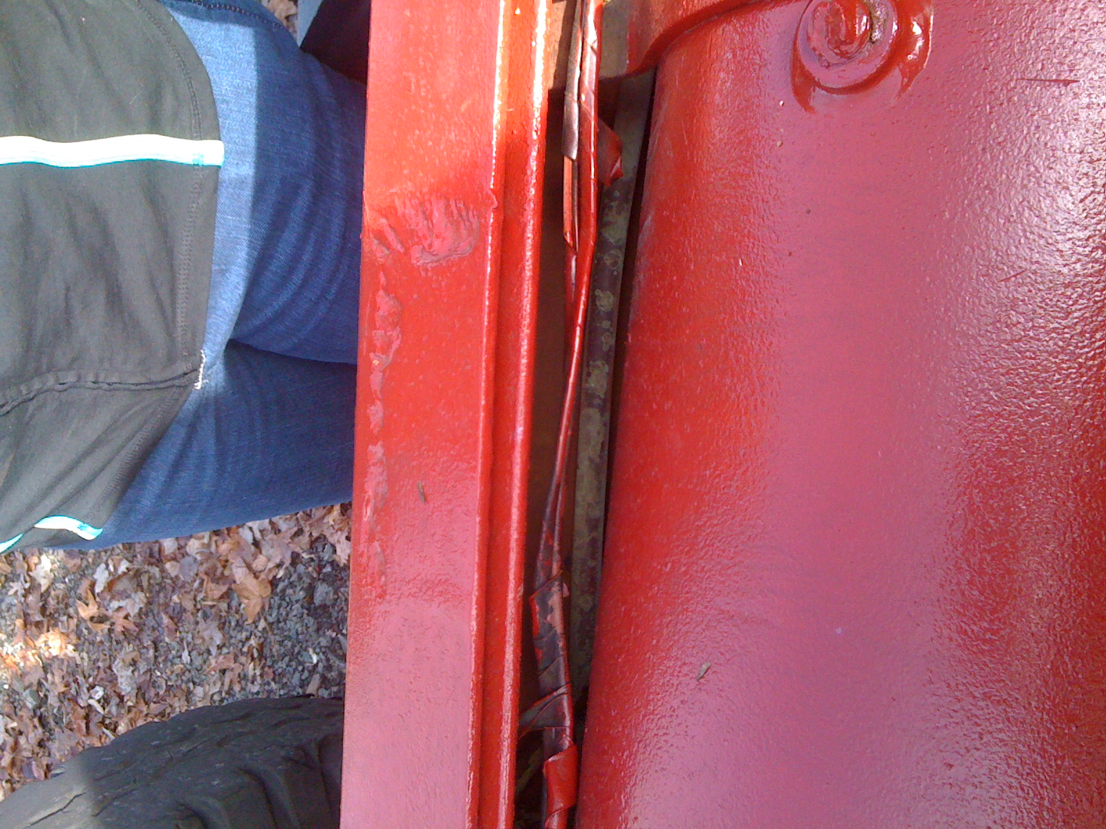

I was going to add on to the end but the rails cracked in 2 spots on one side a one on the other in the center.

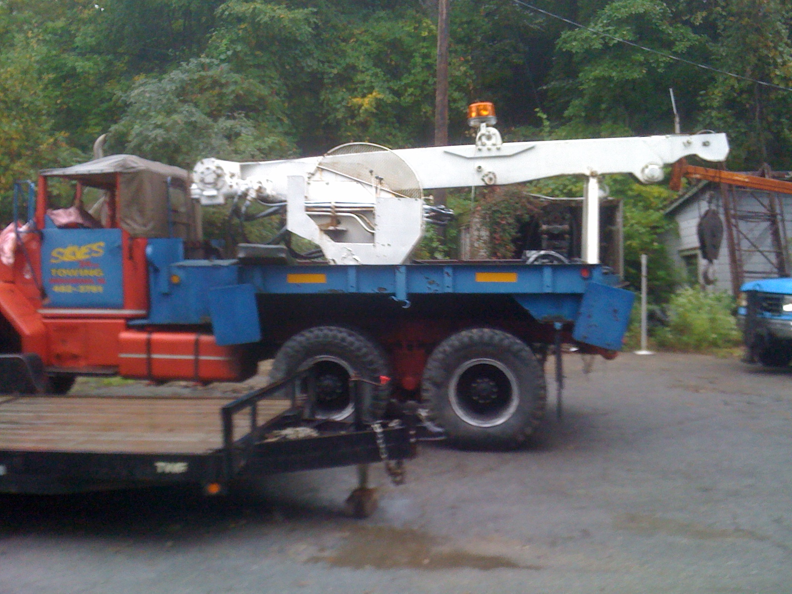

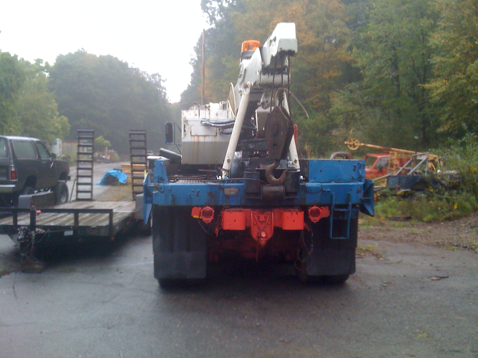

Was going to start on the LJ but i need to get the 5 ton wrecker off to its new owner soon. So i might as well put the wrecker body right on the frame its going on.

I agree with what's been said here already. As far as replacing the rivets, you really don't have a choice, grade 8 bolts into ream-to-fit holes. For what you're going to do on a truck like that, I think to weld the cracks would be acceptable, cut the inner frame back farther so as to stagger the joints, and to get weld inside and outside of the outer rails.

you are making the b-81 into a wrecker?
