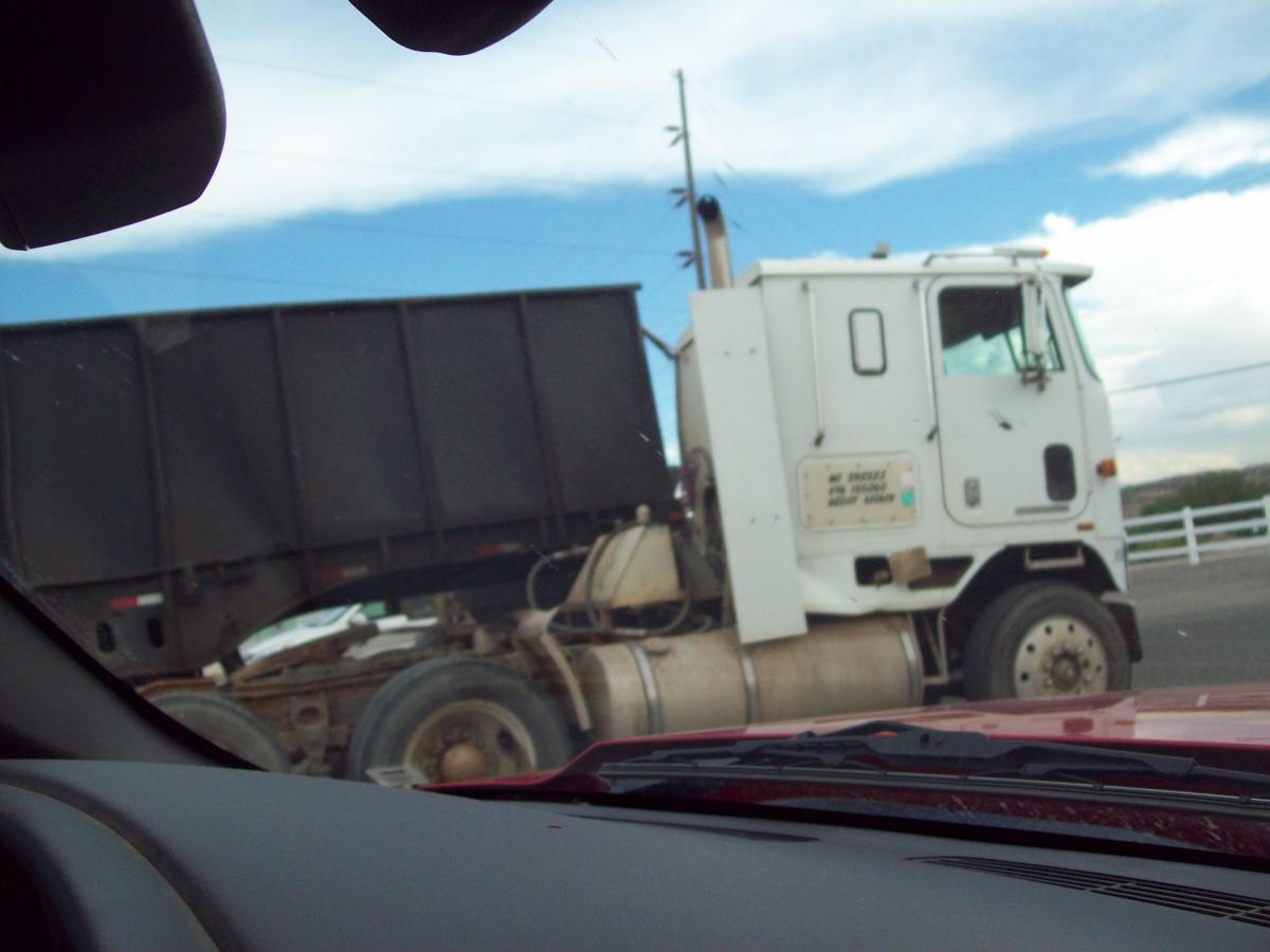

Same thing happened in front of our building yesterday afternoon just before leaving work for the day. Apparently he didn't have sense enough to make sure the fifth wheel was locked before taking off. He got really lucky, he was only about 30-40 feet from entering the highway when the trailer came loose. From what I heard today, the cab was jarred badly enough that the doors were all cattywampus and wouldn't open so he had to crawl out the window ala the Dukes of Hazzard
