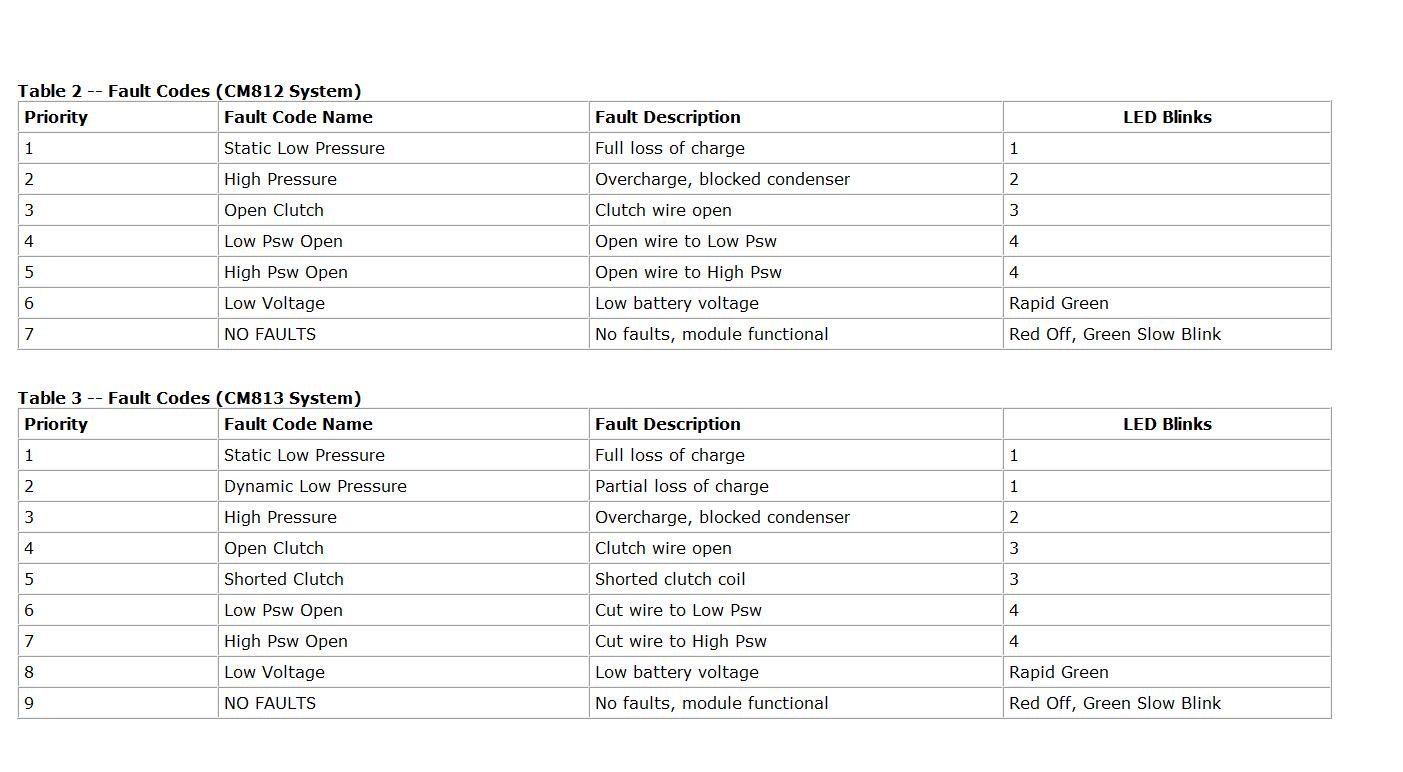

Rob, this truck probably has an APADS system. Basically an independent controller for the A/C system that communicates various system conditions through a series of flashing lights.
I certainly wouldn't have any knowlege of anything like that. What is APADS an acronym for?
Rob
Rob
It stands for air-conditioning protection and diagnostics system (had to look it up myself). The system works more or less the same as traditional systems, it just has a controller wired inline to all of the inputs from the various sensors and switches that controls output to the compressor clutch.

Ok guys - he got to the shop today and they changed out the sensor. It worked, for about 10 minutes and now it isn't working anymore.
He has played with some of the wiring on it as well, and it started workin again for another 5 minutes and it is now not working again...
I gave him the list of the codes you posted, he is going to see what he can figure out there, but if you have any other suggestions - please let me know.
