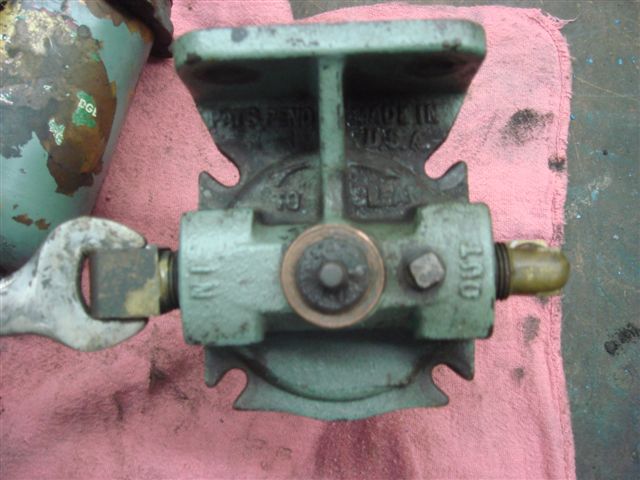

this is fuel filter off of a 1961 b-61. end673. i assume some part is missing off the top where the small bolt is. like a knob or something that would screw onto the 1/4" threads. the serevice manual says a cup nut which would be inverted and screwed back onto shaft to rotate windings to clean. does anybody have a pic with this all intact?
i see on top it says "to lean" with an arrow. does this mean there is some type of adjustment or something? service manual says this unit is a manually operated self cleaning permanent element inside. post-3642-127207661287_thumb.jpg

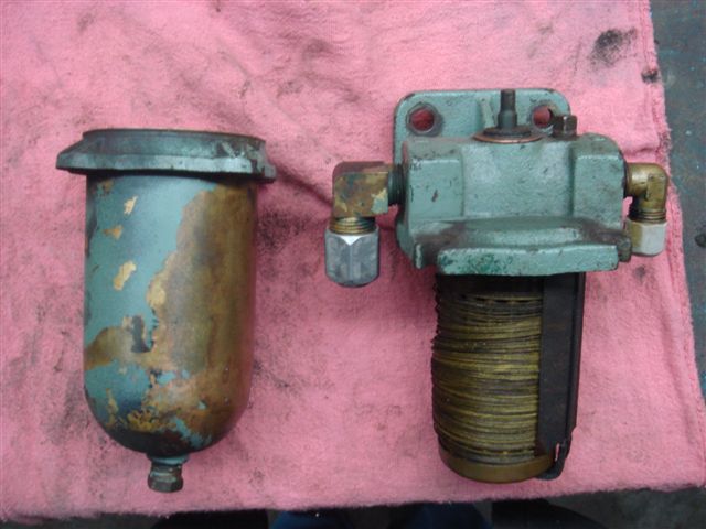

It looks complete to me. I just bought one of the primary fuel filter units for my truck from Kevin of AllMacks.com about a month ago. I don't see anything missing. The filter is scrapped off when you turn the nut on top clockwise or as the arrow shows on the unit. I'll have to look at my unit now because a faucet valve handle might be a good idea to use to turn the scrapper. I tore mine apart and all this crud was inside the filter. Looked like mud. But NAPA has the numbers for me to use and order a new filter. Also they have the Mack numbers and crossovers mostly Wix Filters are what is used by CarQuest, O'Rielly, NAPA etc.

It's been a long long time since I messed with one of those, but I think there is supposed to be a 3/4 inch (roughly) hex nut screwed onto that threaded part on top, and then you put a wrench on that nut to turn and clean.

And the way i remenber the scraper filter was with a 7/8 hex head on it.I had forgot about them till today.

thanks for looking. we are getting ready to paint the engine, so we have taken off everything that is easy to remove. air pump,water pump,fuel filters,exhaust man...etc.
we will replace all lines also. i matched a color from a little spot of paint left on the transmission breather. we should be ready to paint in a week or so.
