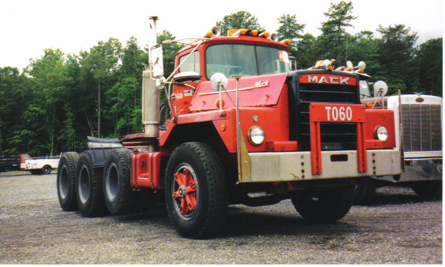

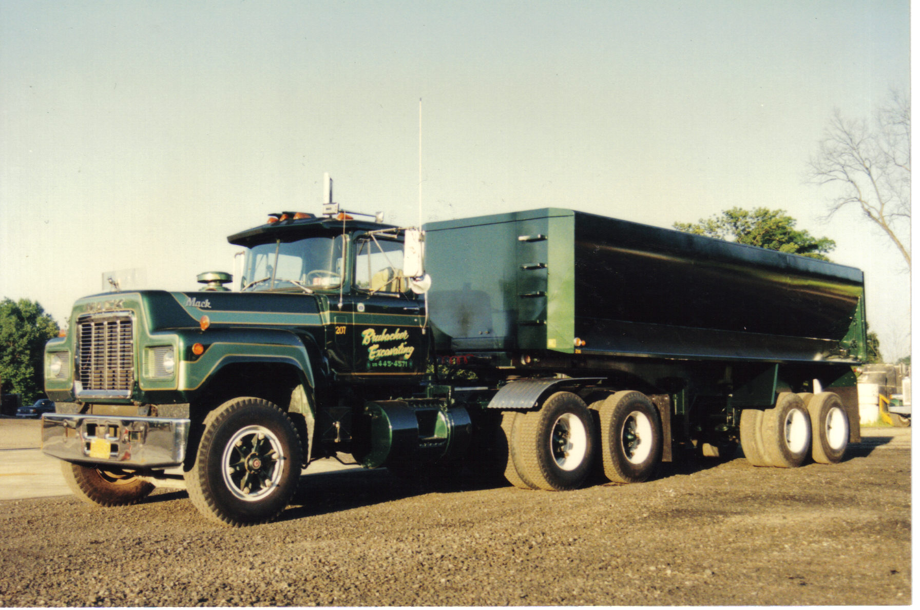

Durkin contractors from Philly ran a DM 800 (unit # T060) with a 3406A with a 12 speed. Also, whem I worked for Brubacher excavating, They had 2 R 754's that ran 12 speed's behind 3406A Cat's. Both trucks came from Canada originally. As a side note I currently run a CL 733 with a Mack 18 speed trans. post-4550-12649022684527_thumb.jpgpost-4550-12649023485482_thumb.jpg
