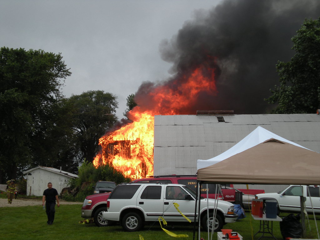

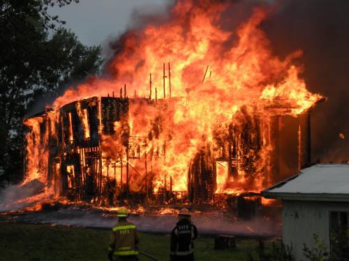

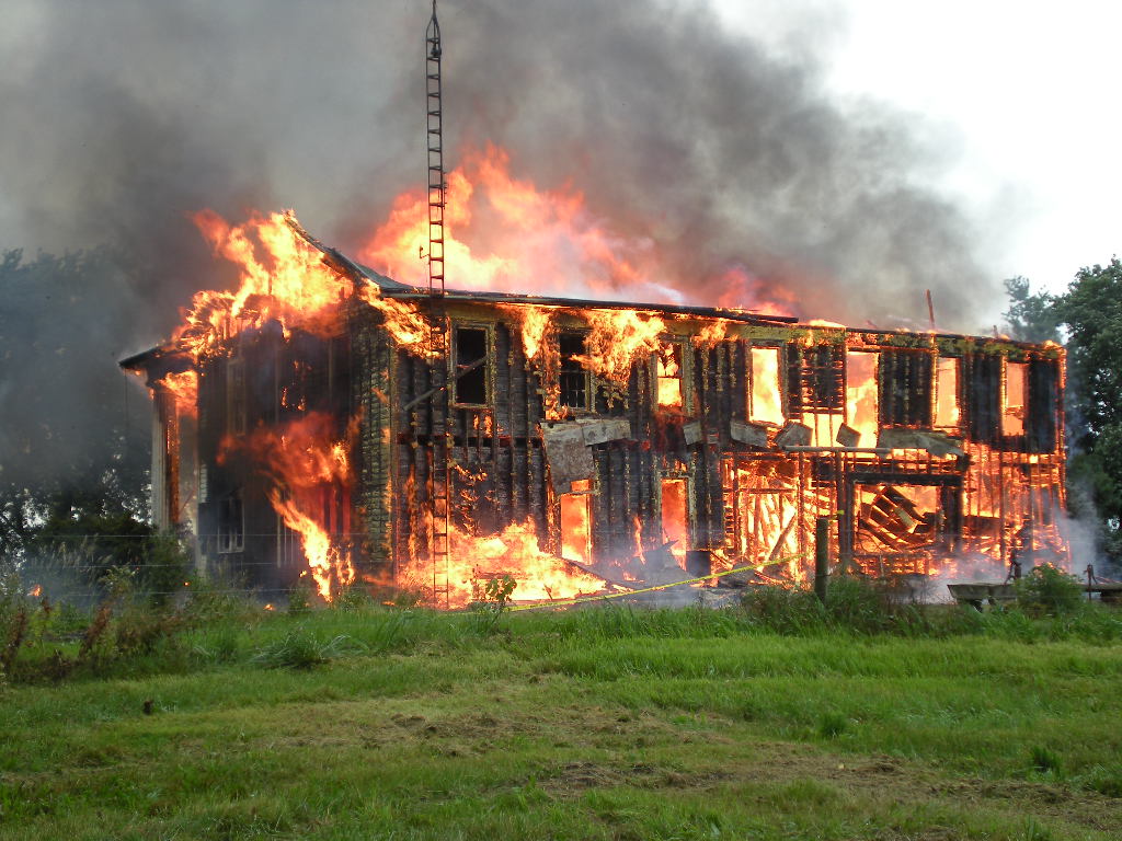

We burnt down the house that was out at that farm this past august. Someday I'd like to build out there, but that's a whole 'nother story...the local and surrounding fire depts did a practice burn and I had the chief talked into letting me suit up and go into the fire but the head training guy nixed the idea...some pix of the fire...
