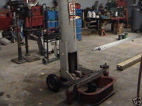

Some of you guys that work in truck shops should be able to answer this but how much would one of these types be used in a shop on older trucks? I've talked to a couple of places that service newer stuff and am told they are obsolete due to clearance issues, but they used to be quite common.

they use one similar to that, only a little smaller looking, a lot at the shop. They use it to lift the whole back of a trailer off the floor, and under the back of the frame on trucks when changing tires and lining brakes.

Hi Tom, I've seen in days gone by the same type used for full frame cars when they had a bumper on the front for the same purpose. A young cousin of mine likes to chain a truck to the upright where he works and lift the rear of the truck when doing clutches. Says a lot of times doesn't need to remove the plastic, or fuel tanks on new trucks for clearance. I don't anticipate doing that often myself, but more for tire and front end work than anything.
The photo is off of ebay. I know of one close to home but don't want to purchase it is not going to be used. It takes up a bit of room.

It saves a lot of time because you can do a whole axle, sometimes both axles, at once instead of jacking up one side at a time. It'll free up a jack and stand or two if you need to jack up something else and when you're not using it you can lean tires against it or even use it like my old excercise bike, to hang clothes on.

Hi Rob.
We had a jack identical to the one pictured when I worked in the shop at Van Handels (1986 - 87).
It was handy for clutch jobs & trans removals as you could jack the front of the truck way up and get enough clearance to roll the transmission jack & trans out from under the truck.
One thing you had to watch out for was damaged bumper brackets on the DM 600's. If the brackets were cracked or damaged they would not take the strain of lifting the whole front of the truck. (this was the old type DM bumper brackets 87 - back).
With a tilt hood, you cannot open the hood while the truck is on that type of jack.

We inherited one of those end lift jacks several years ago.
It has been collecting dust since! I don't think we have ever used it!
It might be useful for getting the front end off the ground with a non-tilting hood,
or maybe getting the rear end off the ground if it straddles the frame rails in a stable fashion.
With the old trucks, you might find an occasional use, but if you don't need it - it really isn't
worth going out to get.
Many, many other ways to spend money!
Paul VS
I agree with a lot of ways to spend money, that's why I'm trying to be "thrifty" rather than jump at the chance for more tools. Don't want to buy what won't be used if something I've got will suffice.
I thought about not being able to open a tilt hood and that is a detriment to the purchase in itself. I think I'd rather have an air assisted floor jack and more floor stands as most work on these things is performed on the floor anyways.

i'd say the trailer work justifies it's being at the shop, that's mainly what they use it for. Gotta get 'em in and out quick sometimes, and they have over a hundred trailers.
Friend had the car/pickup hand jack version of that jack growing up. Of course that was back when cars had real bumpers on them. We used that jack til the paint was wore off it! Changing tires on his 7" lifted Suburban was much easier with that jack. 38" tires on it to boot! We used to call it the "schoolbus" cause it was so freak'n tall/long.
