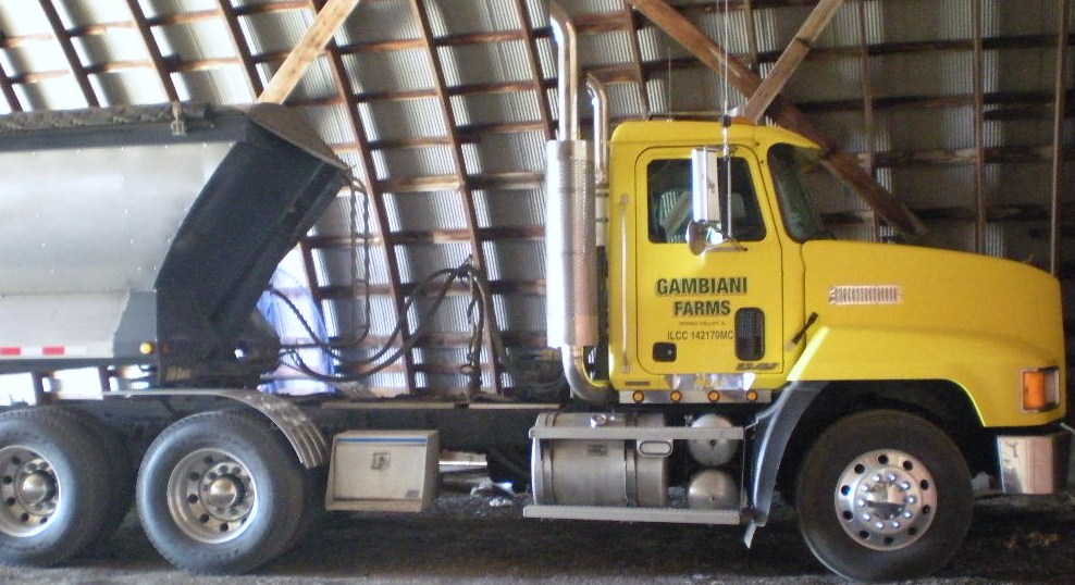

Nice welding! You just saved yourself a ton of $$$ too. New mufflers and stacks ain't cheap. Just replaced mine a while back ($500 give or take) and I just have a one-stack Mack with a window in the back.

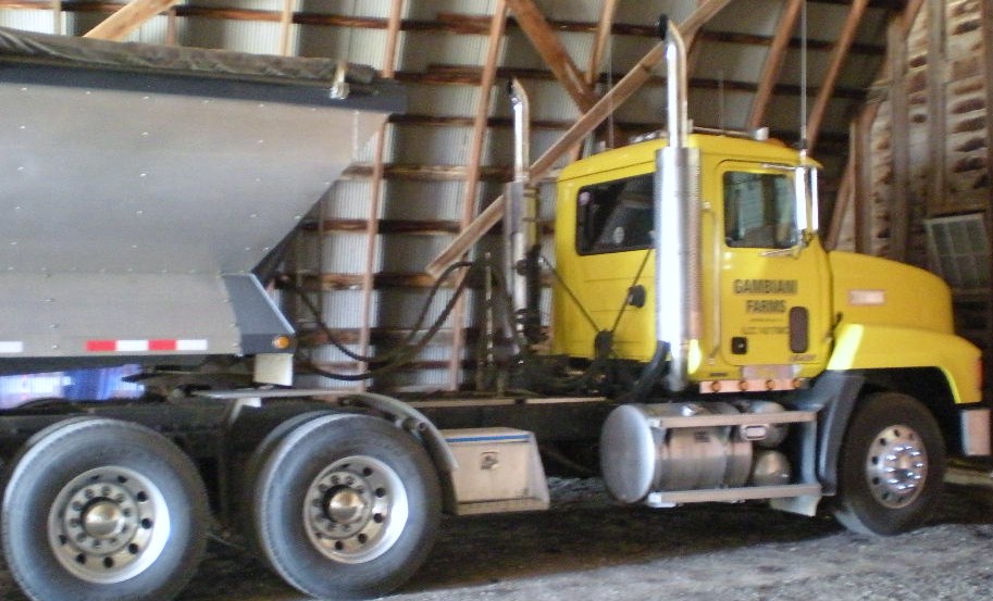

I used the old muffler clamp as a patch. Wasn't too tough welding around the bottom edge where the steel was still good, but the top where the muffler was rusty and the metal was thin...and the fact that all I had was a .35 gauge flux core wire...wasn't nearly as easy. Had to set it on a real slow wire feed rate to basically rapidly spot weld to build up material without burning holes through it...then once I had enough built up, I could run a decent bead on it. I really needed the shielding gas and a .24 gauge wire...would have made the job MUCH easier.
I've wanted to shorten the stacks since I bought the truck...always liked the low-profile look...especially on a work truck. The passenger side was dinged at the top when I bought it, and I made short work of making the driver's side match at a shipper...danged catwalk wasn't quite over far enough...:angry: Anyway, tried doing the job last fall, but couldn't get the stupid stacks out of the top of the muffler. This time, I just cut 'em off even with the top, then used a chisel and a BFH to get that last few inches removed. While they were off, I straightened out the dings, then I marked 'em and cut 'em to the size I wanted.
FWIW, the Mack dealer quoted me a price of around $150 just for one muffler. I don't even want to know what they'd want for the stacks.
The one thing I find confusing, though, is that the passenger side exhaust (muffler, heat shield, etc.) seems to be mounted 1" higher than the left side :blink: Found that out when I was measuring to make sure both sides were the same. I ended up mounting the stacks relative to the mufflers they are inserted into, rather than to the ground in case there was just a low spot in the driveway that I was measuring to. I need to double check one of these days on a concrete pad...seems odd they would mount one side higher than the other...
I got a brand new 9400 International when I drove for H.H.Moore and it was 13'3" to the top of the stacks. First thing I did was take 'em off and shorten them a foot.
I took about 2 feet off of these. I had been up around 12' for a clearance height. Now I'm a hair under 10'.
