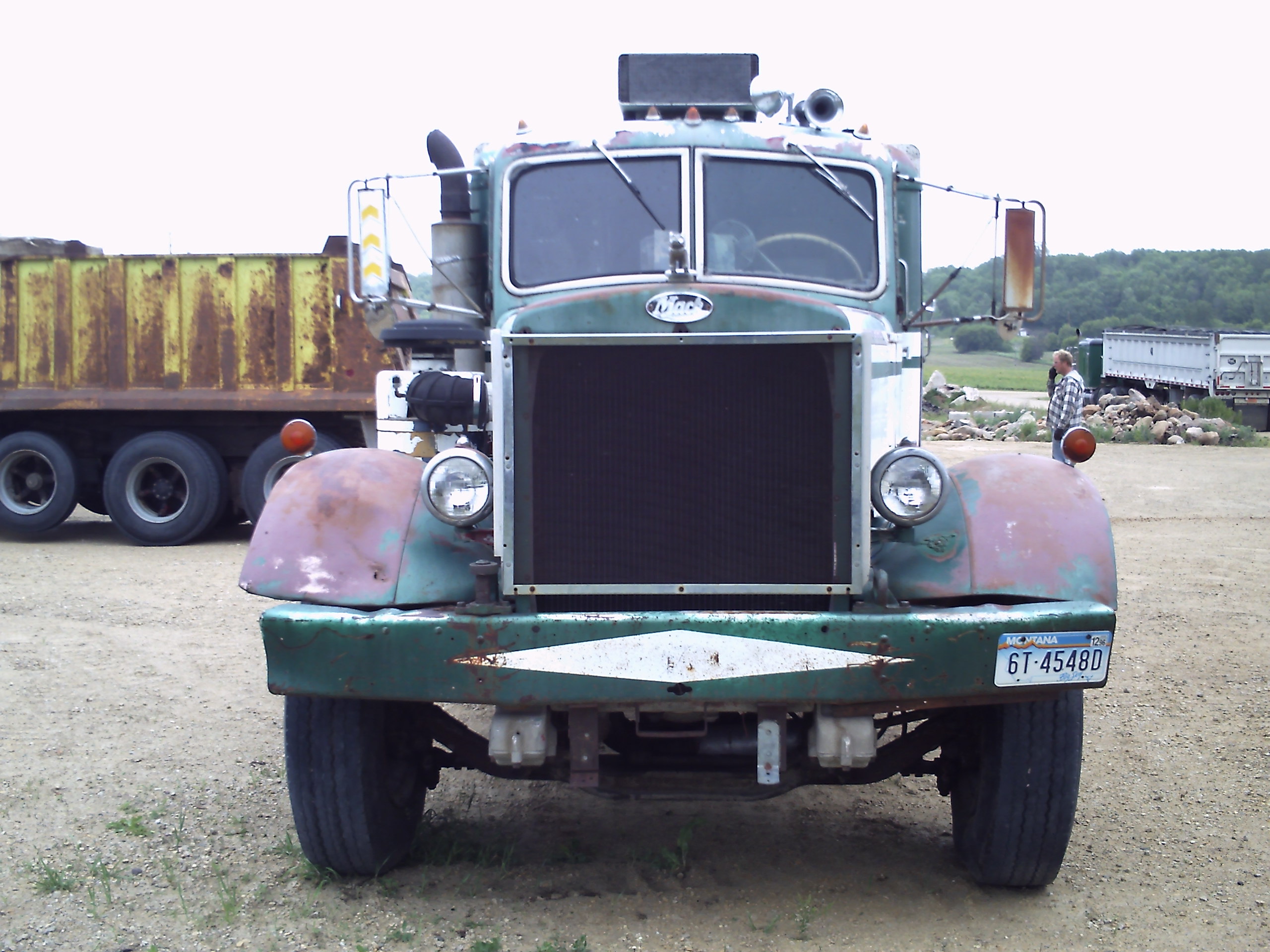

  4. Thanks Superdog. That's the plan to leave it just as is. I may get rid of the headache rack. that thing is ugly. Other than that it needs the belt tightener on the Cummins fixed and one spring leaf replaced in the camel back Also it needs both door glass replaced along with new channel. It's really fun to drive. It has air assist stearing, 5x4 tranny, and a jake. Also has a pto with awet kit. I was told the guy that bought it new drove it until 1994. She came from Montana. Wish she could talk. Jakebrake

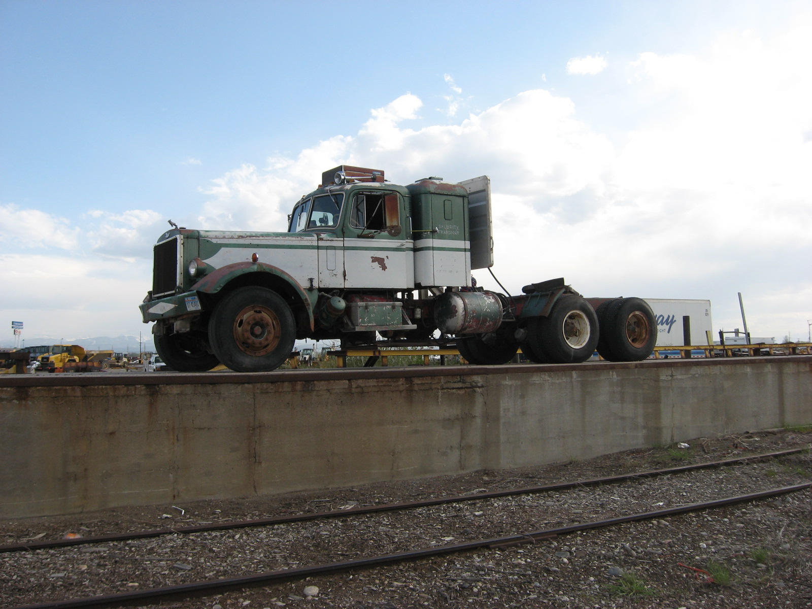

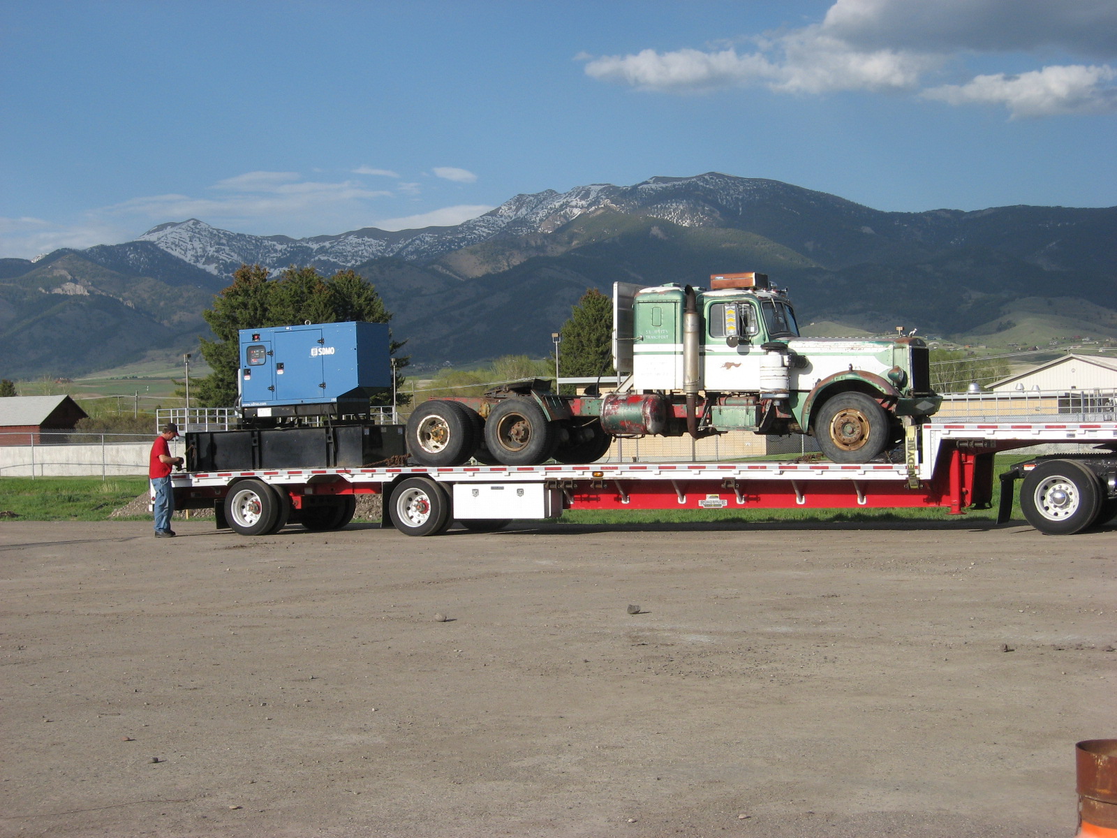

  5. This week the L T was deliverd that I bought and to my suprise it was an LTL. I bought it from a picture and from the looks I thouht it was an LTH. I didn't even know what year it was but the title says '53. It has a 335 Cummins which is not original but it runs like a top. Now my B61 has a big brother in the shed.
