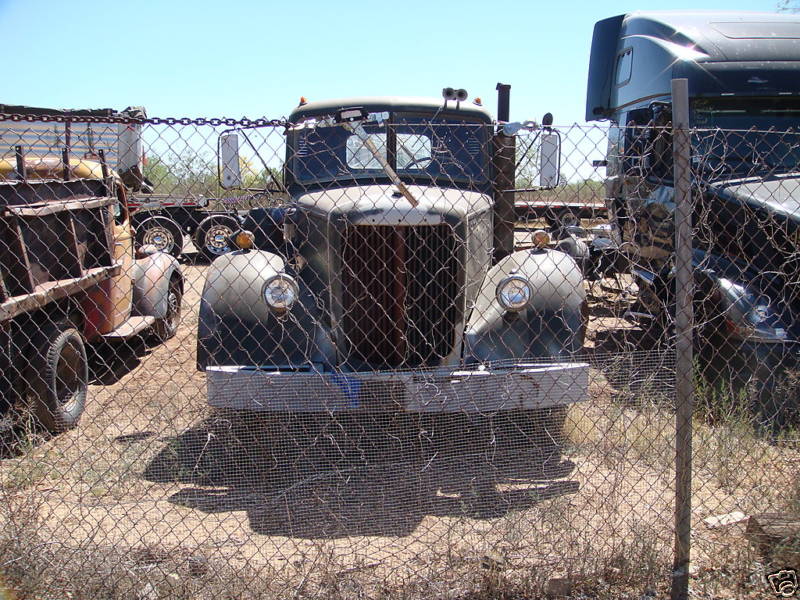

  5. The one at oldMacks.com looked to me like it was in pretty good shape...it was $5000 last September...I climbed up in the cab when I looked at the B model that I bought...It is still on his website...shoot him an email...

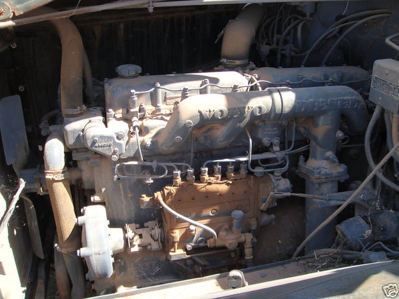

  7. There is a machined pad just above and to the rear of the compressor, here should be stamped the serial number for the engine. A quick not to the museum with the serial number should get you all of the infor you need...

  15. It is an ENDT675...dont know what year, havent found the serial number yet...

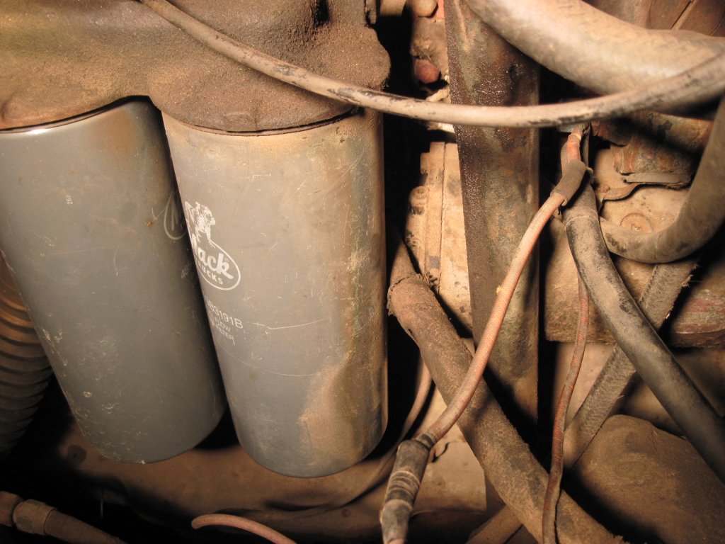

  17. Starting seeing sparks flying behind the oil filter when it was starting hard...jiggled the cable and it came out of the terminal! Gonna take 'em both off and have new end ends put on... I am proud though, today I "shoved" the end back in its hole and the ol girl started today at 20 degrees with no block warming! Rewarded her by taking her around the block
  18. What kind of sadist would design the starter placement so that you had to remove the oil filter to get to the starter ground?!? I could do it from underneath, turing 1/360 of a degree at a time!
