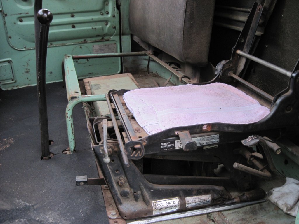

  3. Bottomed-out Busted Bostrom...This is what you must endure when you are a lardA$$! Hopefully I can lay my hands on a stock Mack seat soon...maybe get it re-apholstered a little thinner...Also on the lookout for an R model steering wheel...It is especially fun at speed when the front and rear wheels' flat spots get out of phase by 180 degrees! With the loose cab mount (another story) it is like an amusement park ride! Only a few fillings left in my teeth.

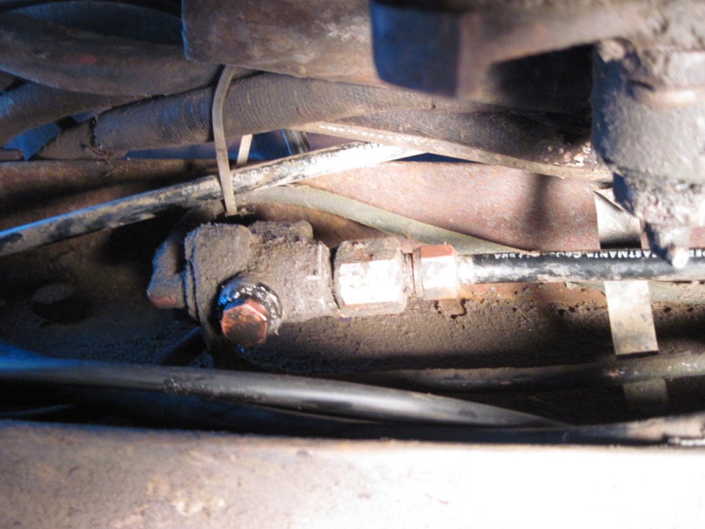

  16. Wondering what this is? One line comes from a service port on the treadle valve, the other goes to the column mounted trailer brake lever, and it has the brake switch. All of the diagrams I have show the column lever gets full air from the tank. Why would the trailer brake test valve get air only when the brake pedal is pressed? Confused... Thanks

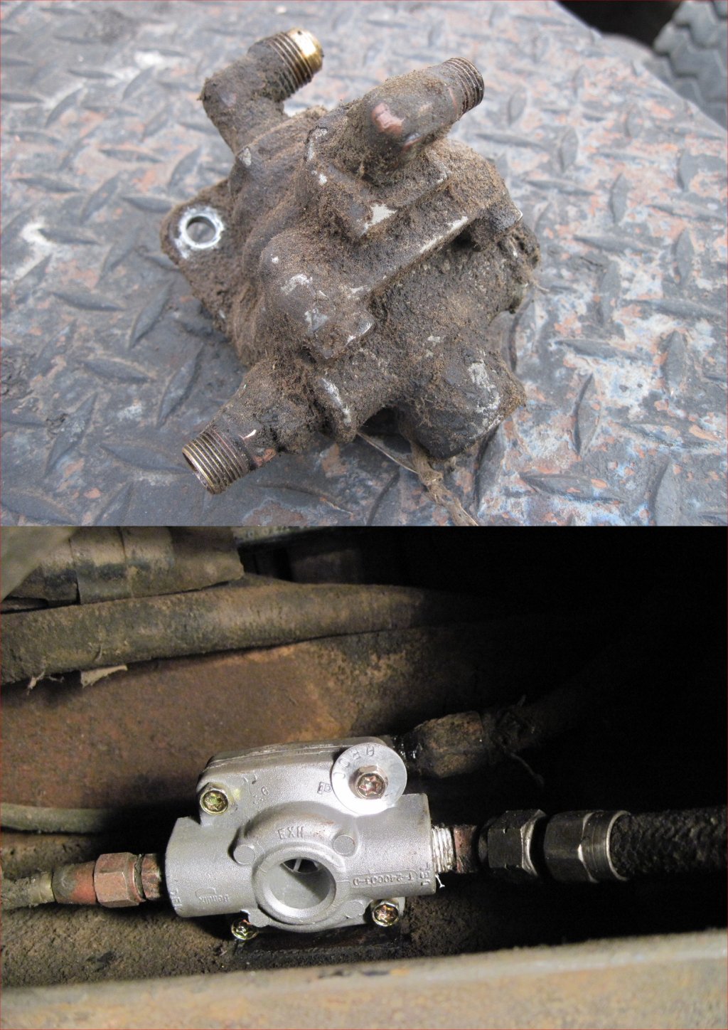

  17. Got it! Truck stops much better with front brakes! It was the limiting quick release valve...will take it apart tomorrow and check it out...

  22. So, with the small "control" line from the dash switch disconnected, the front brakes should recieve full line pressure correct? Maybe the limiting valve is bad 'cause I got nuthin' on the front! I think I will replace it with a new plain jane quick release valve Thanks
