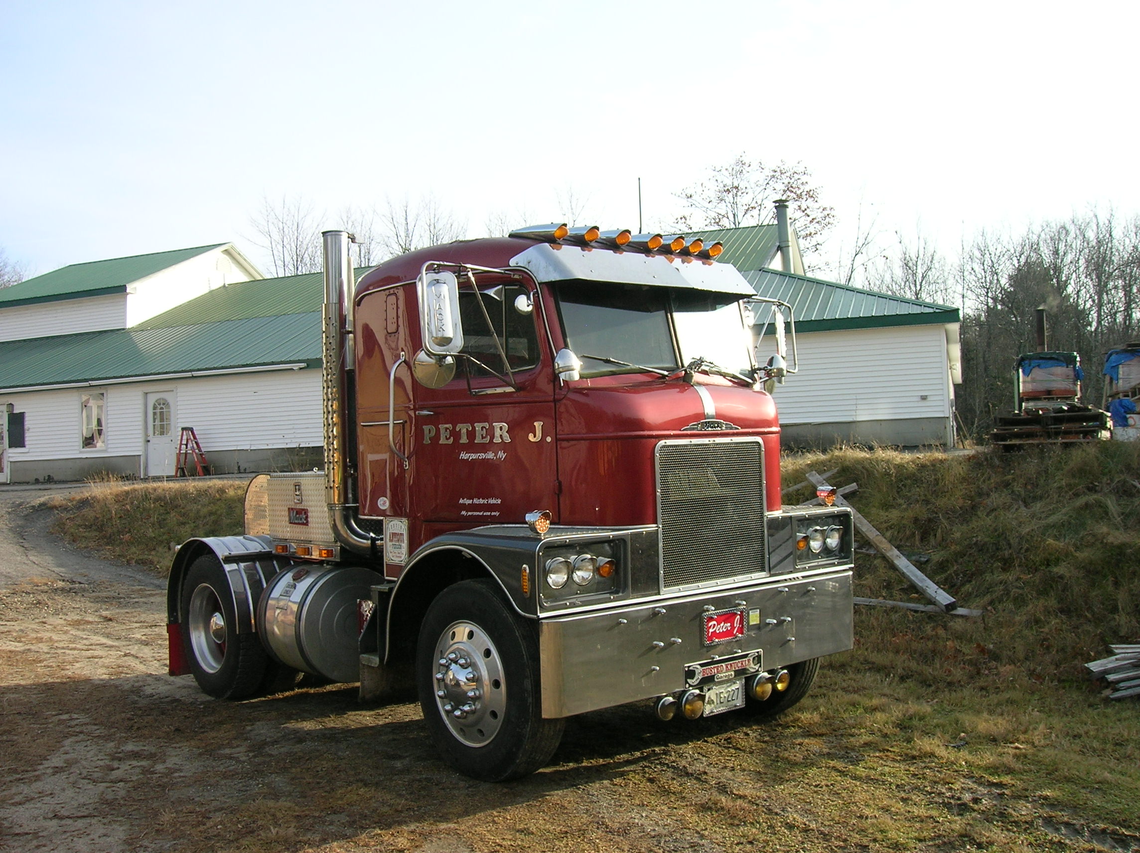

	Just curious, before I call any parts houses, to see if anyone knows if the E7s used the small input shaft like the E6s did or if they used the bigger shaft like Cat and Cummins ?. I know the FRO10s were avaliable behind the E7s because I drove a '97 CH with an E7 400 and an FRO-14210C. I've got a line on a cheap FRO-15210C, with the wide ratio spread I'm thinking it will work better behind the 237 Maxi thats in Peter J's H model instead of the RTO13 speed thats in there now. The 13 has some issues, I'd just as soon find a good used 5 or 6 speed to put behind it but its already rigged for a road ranger so it will be cheaper to stay that route. If I cant put a small input shaft on the FRO then I'll probably look around for an older RTO15 or just patch up the 13 speed. Thanks

	Thats Gordon Chase's old H model that he built for his wife to drive back in the '80s. He stretched the cab and put it on an mid '70s Astro chassis. Cummins powered with a 13 speed, it had a second, smaller radiator with an electric fan behind the cab. She embarrassed a lot of "big trucks" with that little H model. I always wondered what happened to it, nice to see its still alive.
