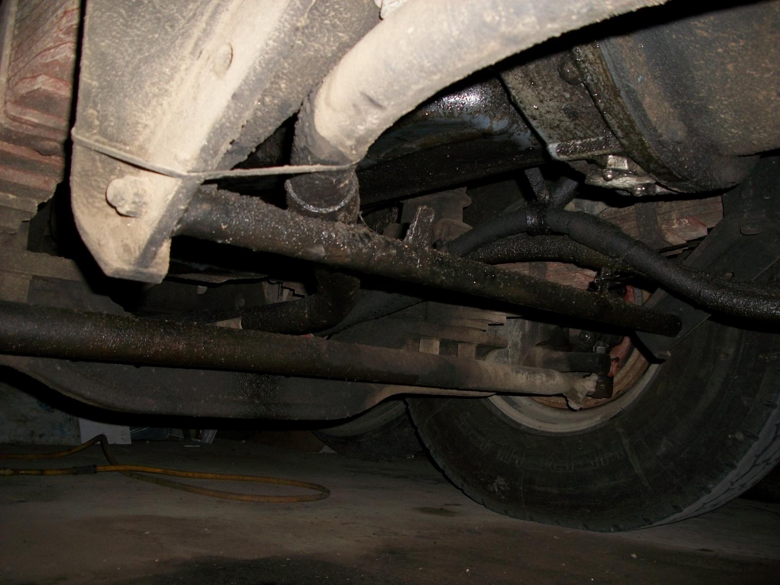

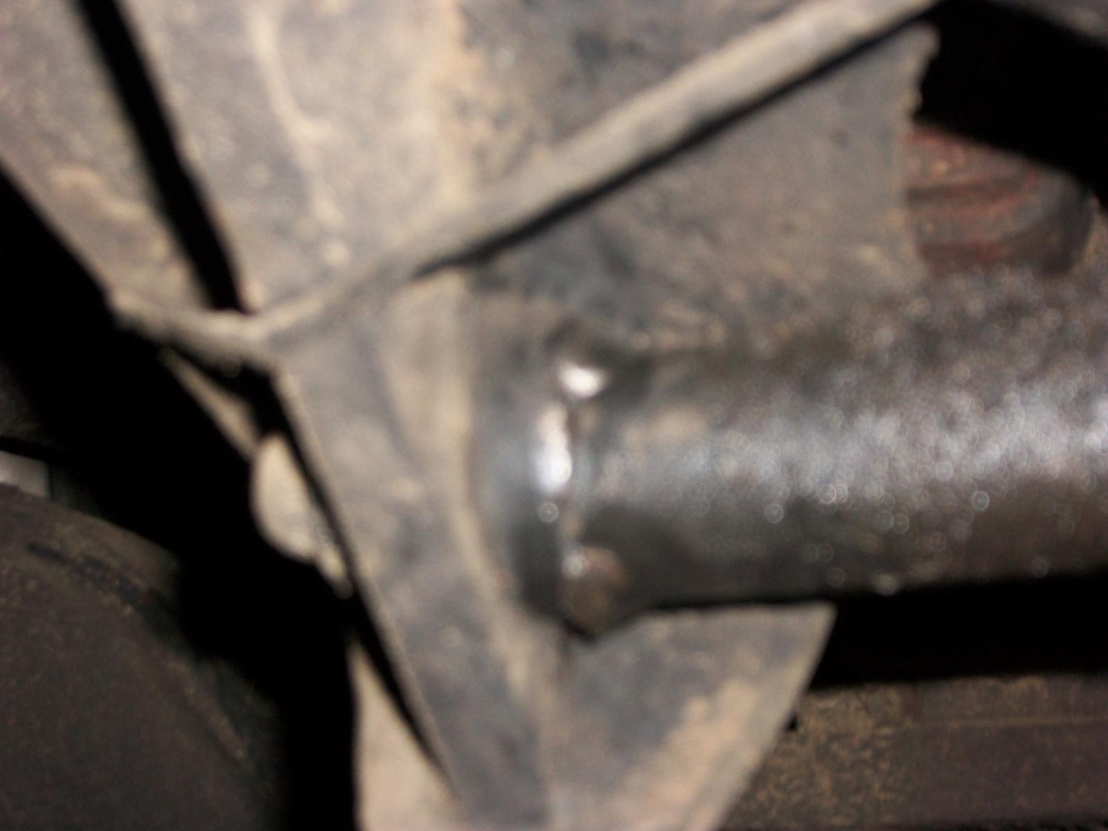

well took it apart today and noticed only one washer on one side none on the other. the previous owner put the washer on the wrong side of the tube. repaired and reinstalled nice and snug now. thanks
thanks. gonna do a rebuild.
the washers are welded on the inside on both ends rite?
thanks guys. i think i am gonna reweld as is.
on my mack 688s mr i have a rod that goes between the front springs on the rear hangers. it is held by a nut on each end. what i noticed was it looks like its also welded on the inside. is this correct? looks to me the weld let go on each side. could i remove and just reweld the rod? you can see the weld spots on the rod. dont know if i should reweld it or replace. thanks
