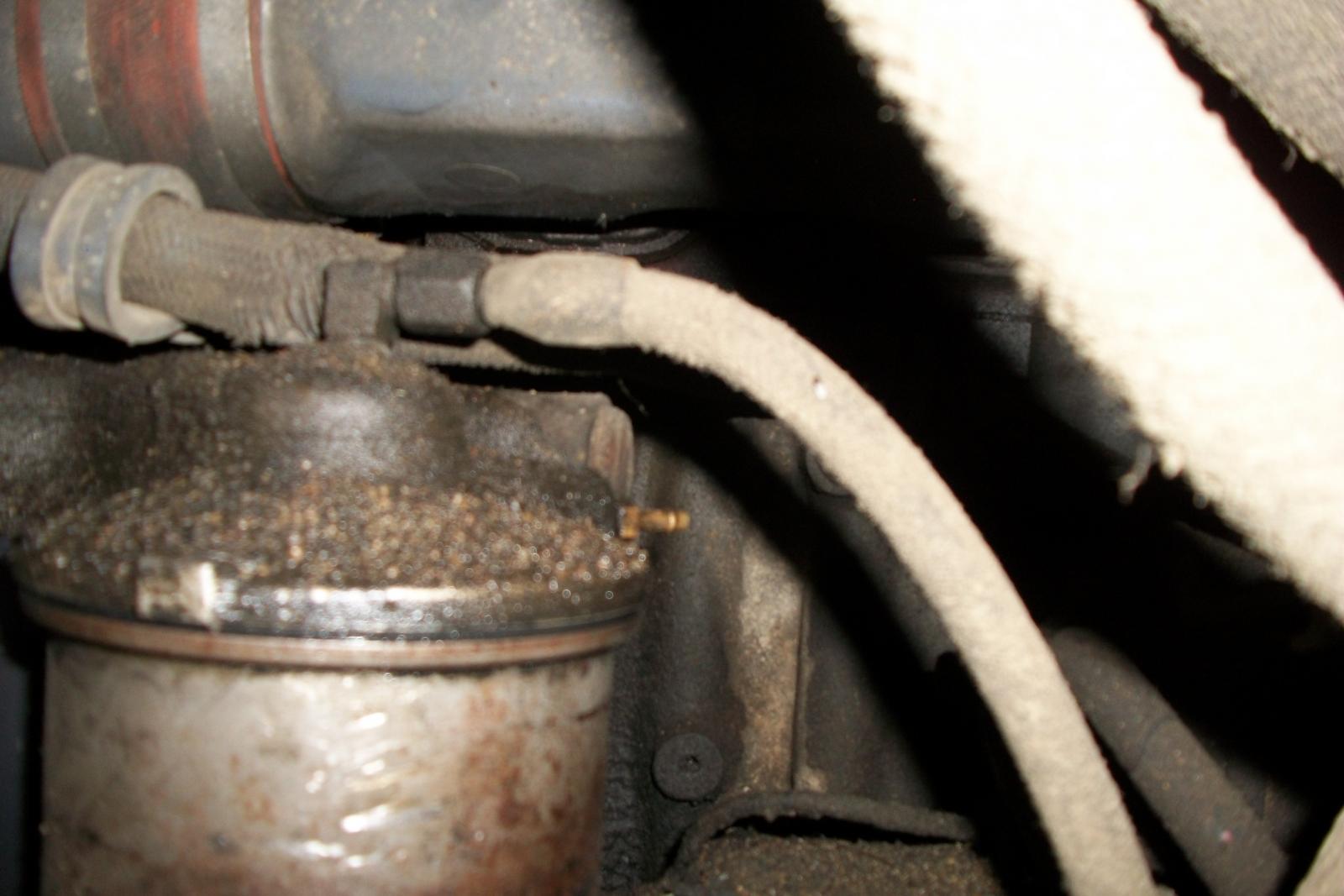

  1. thanks for the pic,but mine looks different. here it is. and she seems damn tight too.. should i try some heat??

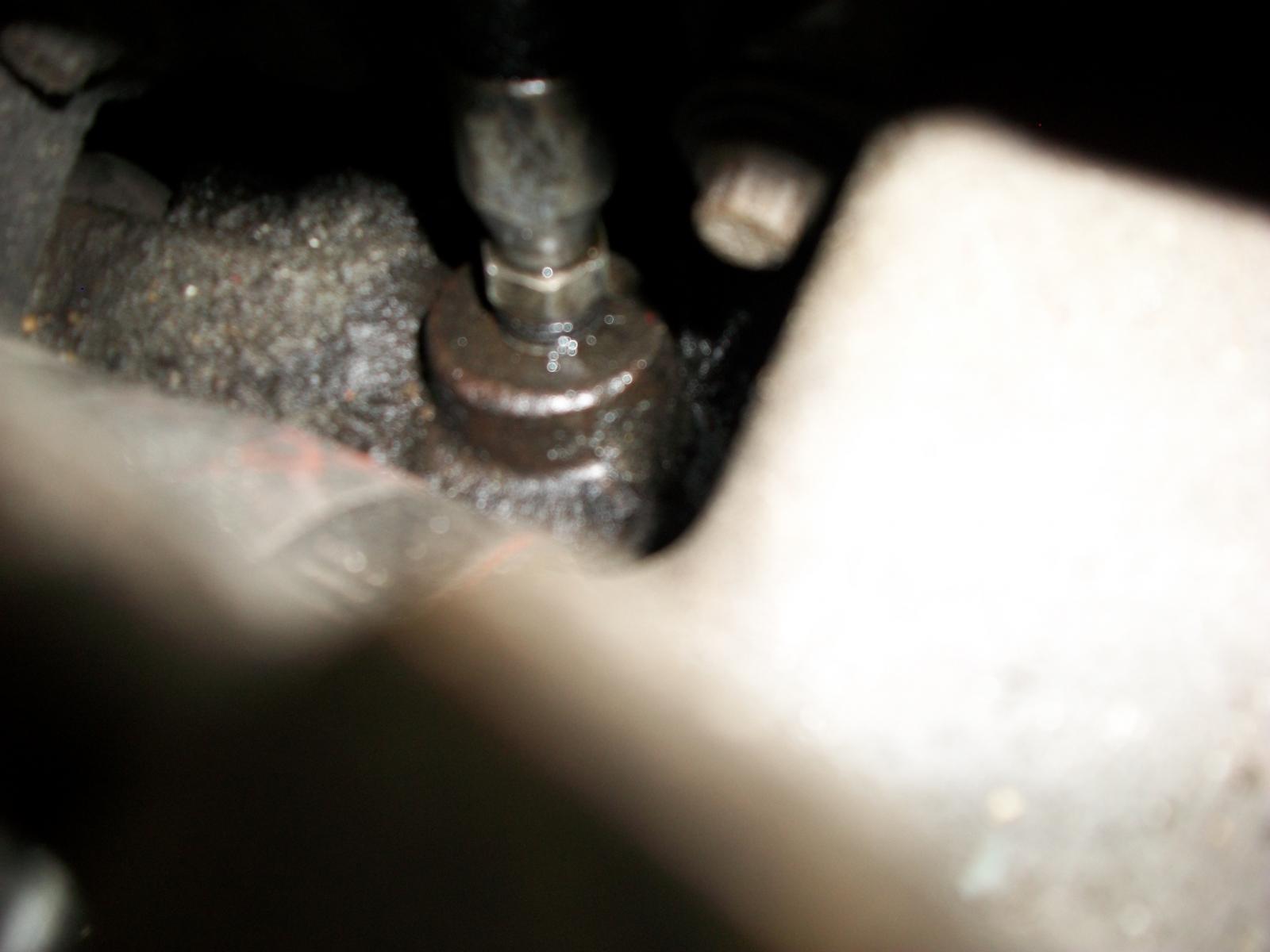

  2. i tried again today and no luck. i was told to try some heat, but kind of scared because of its closness to the filters etc... to me its a swivel at the turbo end, but not at the oil filter housing end. i will try to get a pic.
  3. got a chance to take a better look. its not a swivel at the housing end. i got some nut blaster on it to see if it helps to loosen that up. she is dam tight. anybody else turbo oil line that tight at the filter housing?? i am afraid i will pull the threads out or break something.
  4. thanks. yes a mack e7, sorry for missing that. what it looks like is the swivel end is on the filter housing. and on the turbo end of the hose its a swivel. so i guess i was turning it the wrong way. duh!! thanks again
  5. need to replace my oil line from my turbo to the top of the oil filter housing. does the hose have a special connection at the oil filter housing? the reason i ask is i quickly tried to take it off at the housing but damn dont know if it a special fitting or i am just weak. could not get it to move. ran out of time, but gonna try again tommorrow and see whats up. any tips?

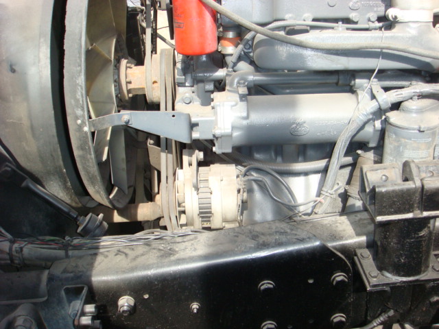

  10. hey gang. i am about to replace the oil cooler in my 96 mr688s truck. it has the e7 300 engine non electronic. i changed my tranny cooler a few months ago and would like to replace the oil cooler also just for piece of mind and easier now with nice temps. my question is. do i need to drop the oil? any tips on replacing the cooler? also in the pic i believe the cooler is located inside the long cylinde just below the filter and above the alternator. attachment=58897:Engine pictures 006.jpg]

  15. probably oil cooler. check your oil level if she is going down. its the cooler
