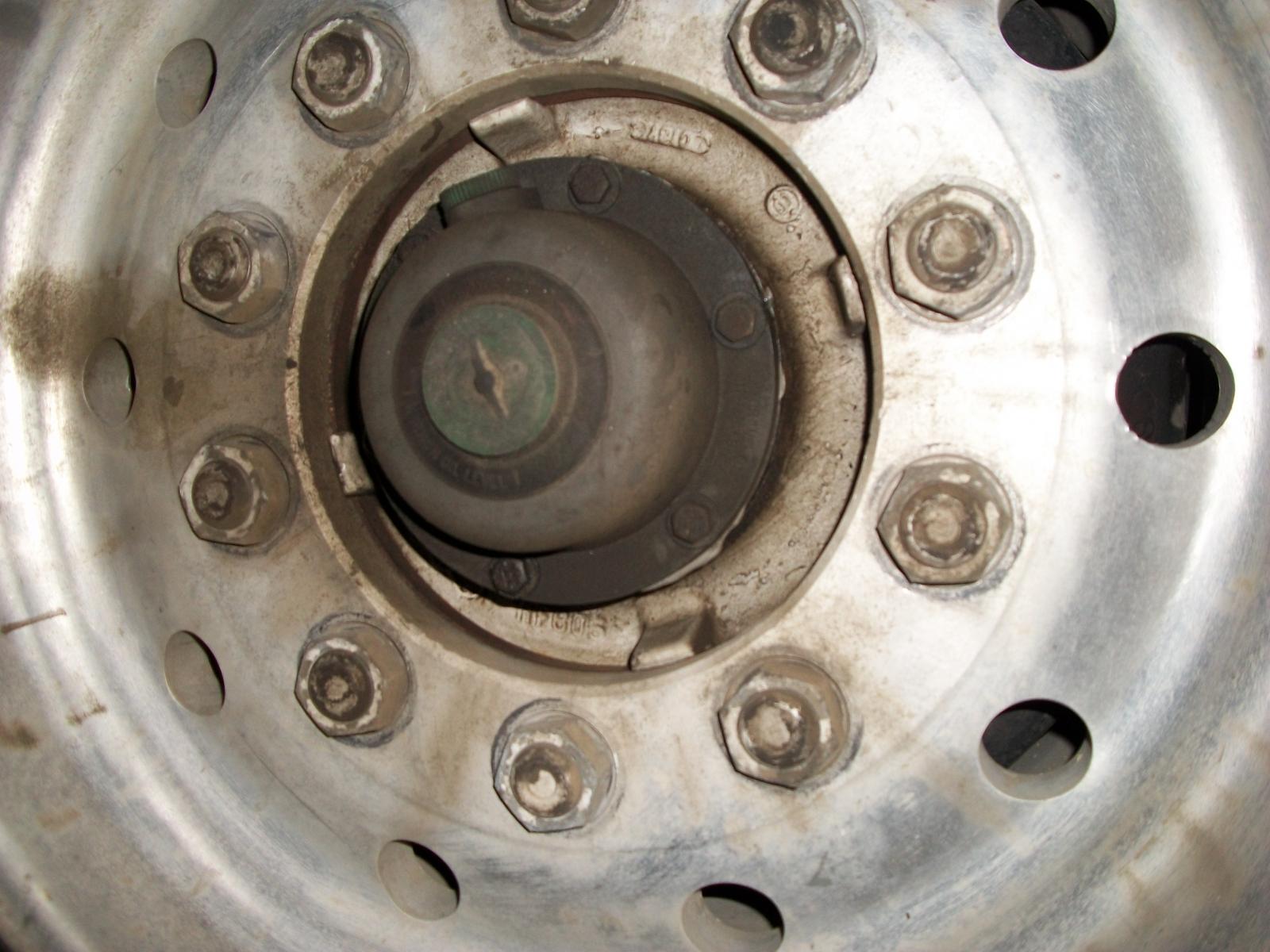

  8. just wanting to know if these lug nuts look correct. should they not be nuts with washers? thanks
