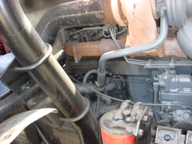

  13. can a spin on filter be installed instead of a centrimax cartridge type filter? also the small vent tube on the top of the filter housing, can a guy just put a hose on it and direct it to ground? thanks

  17. just noticed on my 96 e7 engine that on my centrimax bypass oil filter housing my small vent line is off and no where to be found. where does this line hook up to. thanks everybody. one hell of a great website!!
