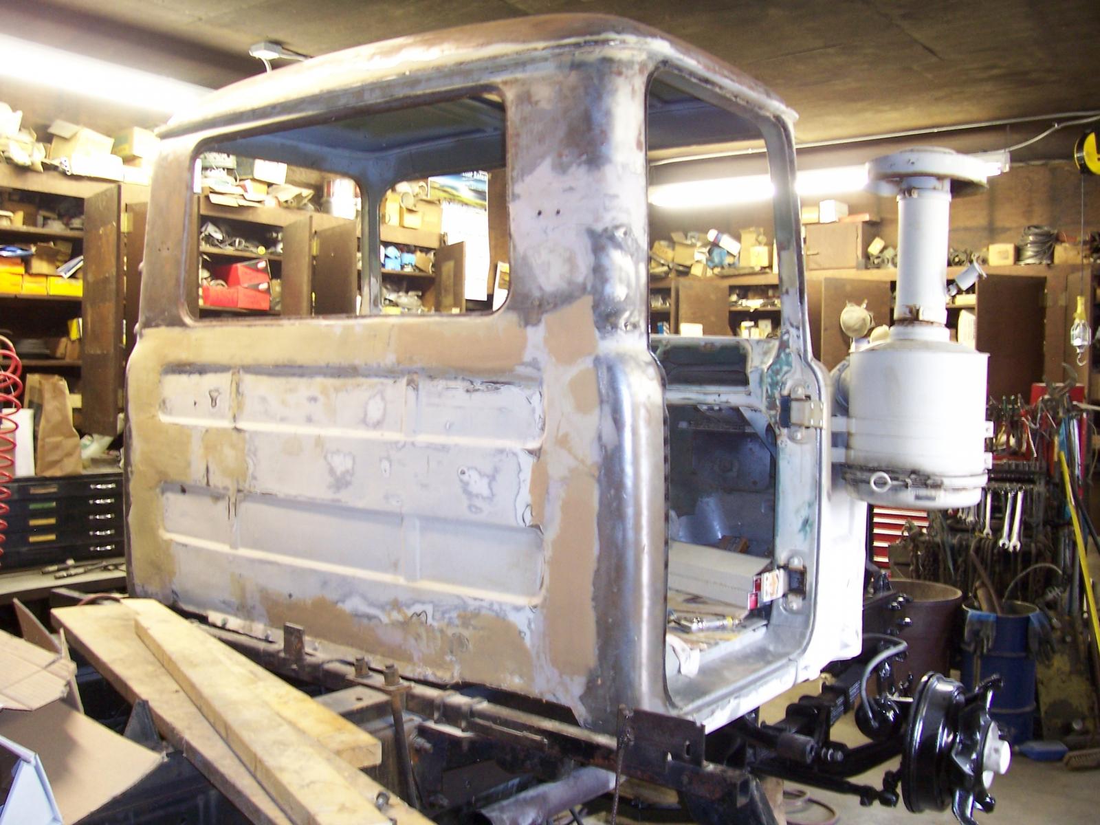

  18. I only have a hood leftover, All the rest went to scrap. The doners were not in good shape when I got them, bad engines,junk drivelines and bad cabs. I cut the cab top off of one and cloned to my cab. The other gave up dash parts, door hinges and headliner. Thank you, Jeff
  19. Name: Mack R600 (1968) Date Added: 06 September 2010 - 08:59 AM Owner: New2Mack Short Description: I picked this truck up in April 2009, Told wife I just had to change fluids and hoses. After seven months and two doner trucks it rolled out of the shop. View Vehicle
