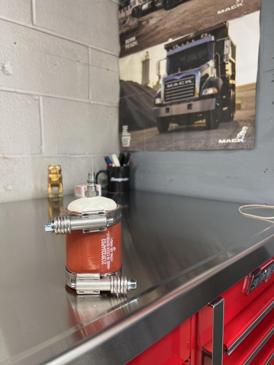

  19. But no there should not be, these valves are notorious for taken a shit.

  23. Got this idea from Mackpro/FJH, mine is just different than theirs. It’s a piece of egr cooler hose, a pvc cap, and air fitting threaded in it and epoxied. Stick it on the cold side of cooler and put 40psi of regulated air to it and you can check for exhaust leaks up to the valve and or check to see if valve is open. Also check for cooler coolant leaks. That way you don’t have to keep taking the diffuser pipe off and fighting with all the other shit.
