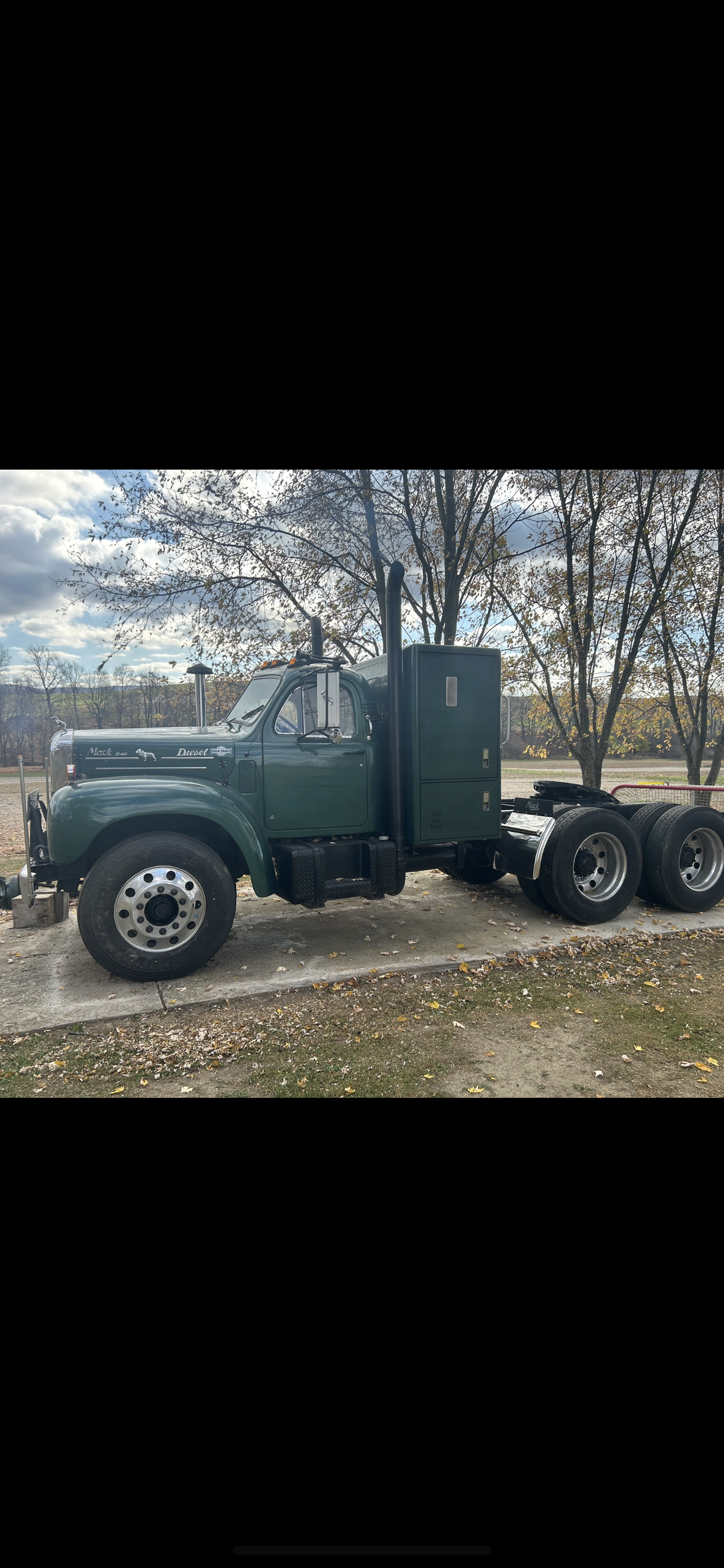

  3. I was in the same boat you are in I have a b42 converted to diesel I used an air ride cut off from an international it’s now tandem air ride instead of single with springs . It had 6.17 gears when I got it had original gas rear in it then changed to 4.61 gears that let me go a about 55 with a tall tires don’t know the gearing of the tandems but it has way more road speed now as for the front axle I used a complete axle out of a school bus so I have modern hub pilot wheels and brakes the engine is just a 673 that I added a turbo to I gave it extra fuel and that was it and it don’t seem to run hot on the pryo I feel your truck would be lots of work to fit all the sheet metal on the newer frame but it’s doable the steering box in front of the axle would not work because the b model front clip ends at the front spring mounts Maby you could move it back to have power steering as for the axle widths the newer frame slipped right over my frame and I just bolted it but my frame rails are not as tall as a modern truck I lost most of my pictures of when I did the work but they should all be on here congrats on the cool project

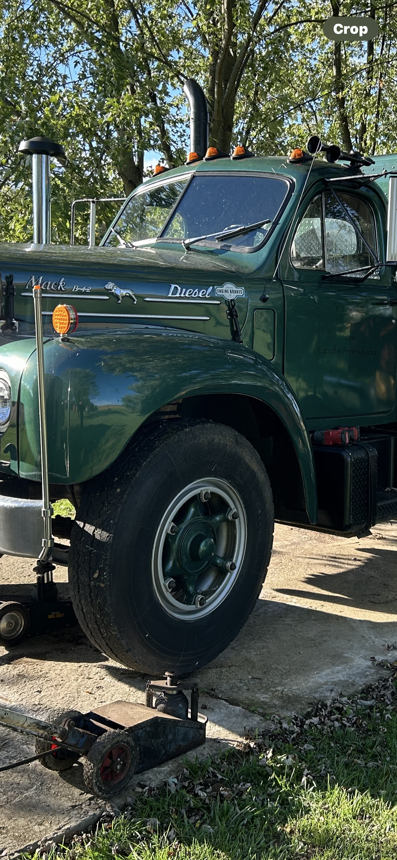

  5. here it is finished up
  6. My b 42 had 6.17 gears in it the owner before me put a 673 diesel in it 45 was top speed I found a different rear I think it was 4.56 somewhere around there 55 top speed then I switched out for a modern air ride I’m not sure of the gears in it but it will easily do 65 not even pushing it and all everything is more modern and available

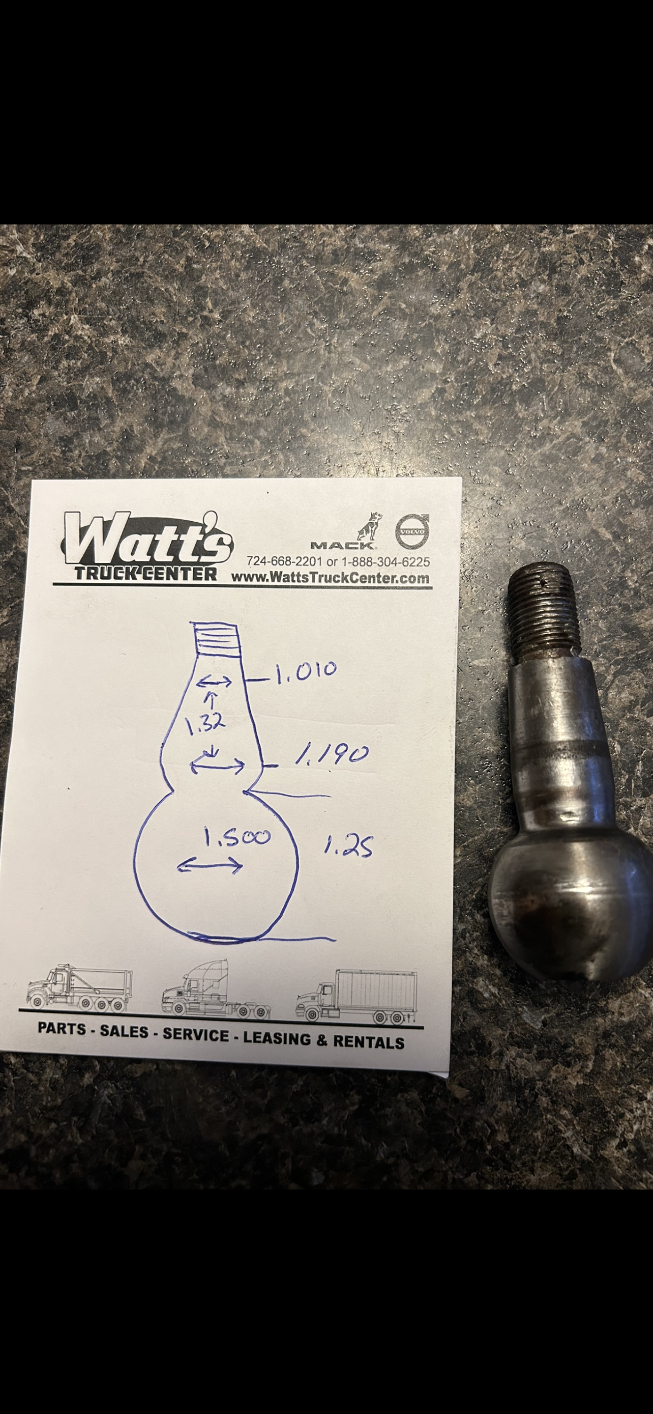

  8. I ended up taking a piece of tubing heating it red hot and beat the drag link end into it making a cone then cleaned it up and pressed it into the stearing arm with some bearing mount on it once tightened it should work out good

  12. this is where I hit the road block I have the rebuildable drag link the end that went in the original axle is too small I need the same size ball but a bigger tapered shank to fit the bigger axle the paper has the measurements I think that will work . Where can you find thes ? My idea is to cut up a tie rod end and take this part out of it if I can find the correct size any other ideas ?

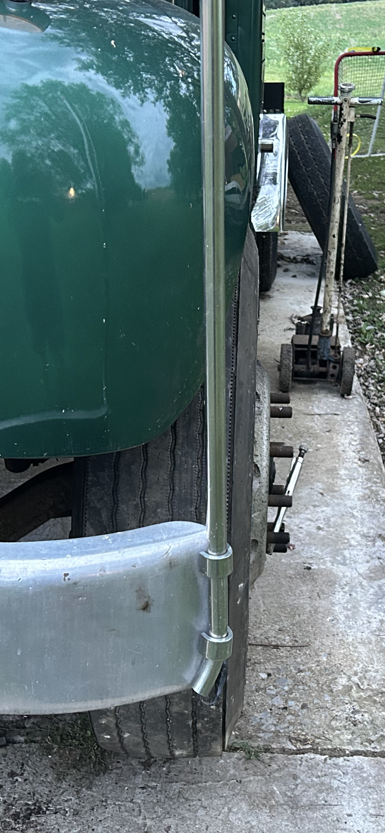

  13. here is where the tire ended up in the fender I’m using Alcoa 11r22.5s in the front and 24.5 in the rear of the truck

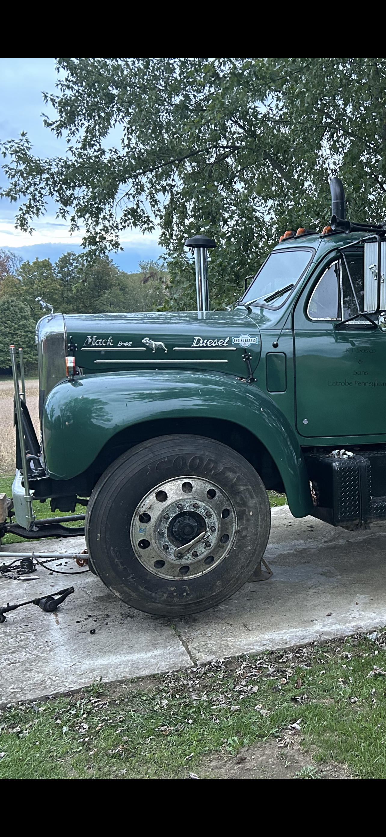

  14. here it is with the new axle in I did use the 3 in spacer that came with the axle to give some more fender clearance

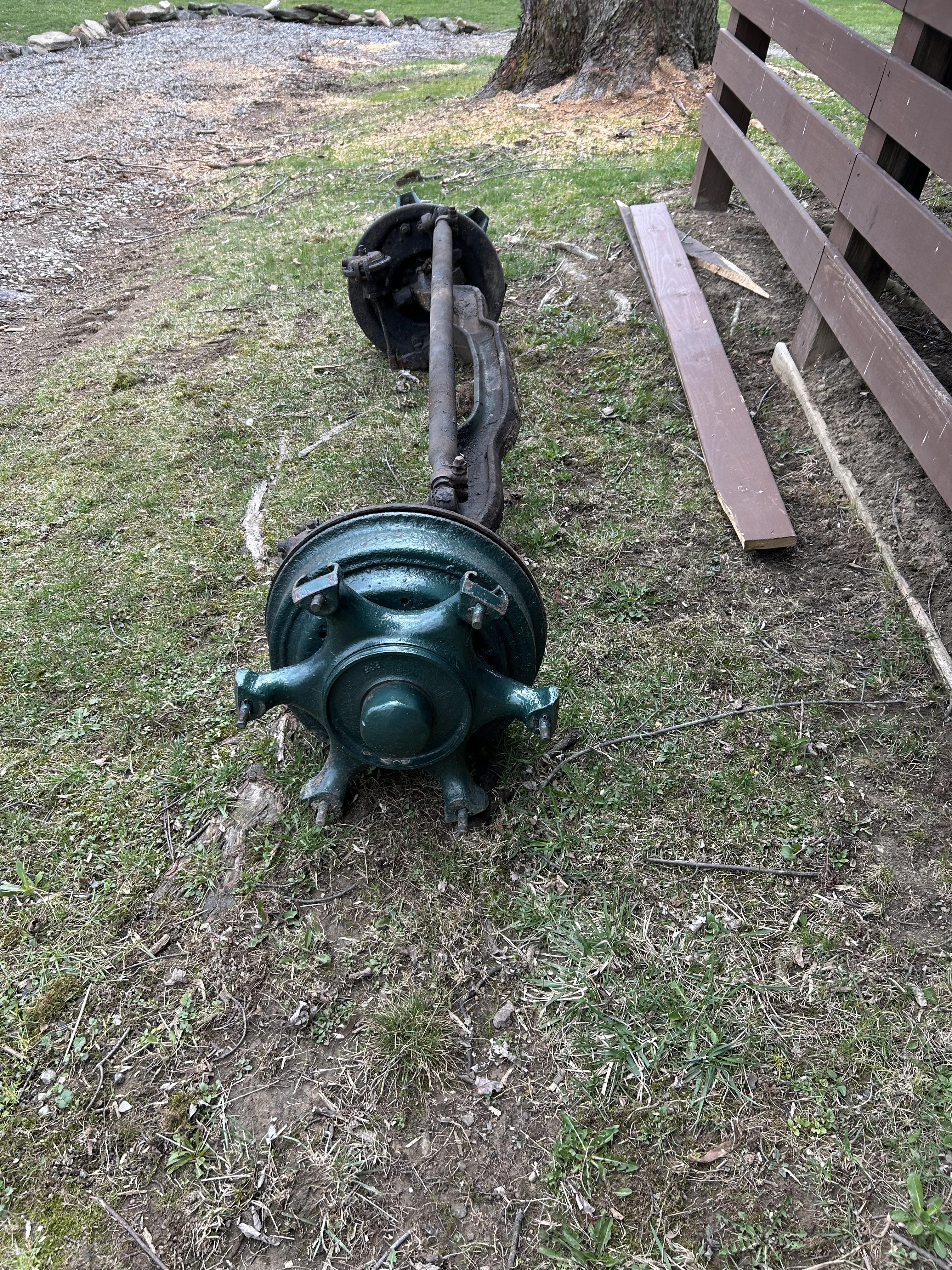

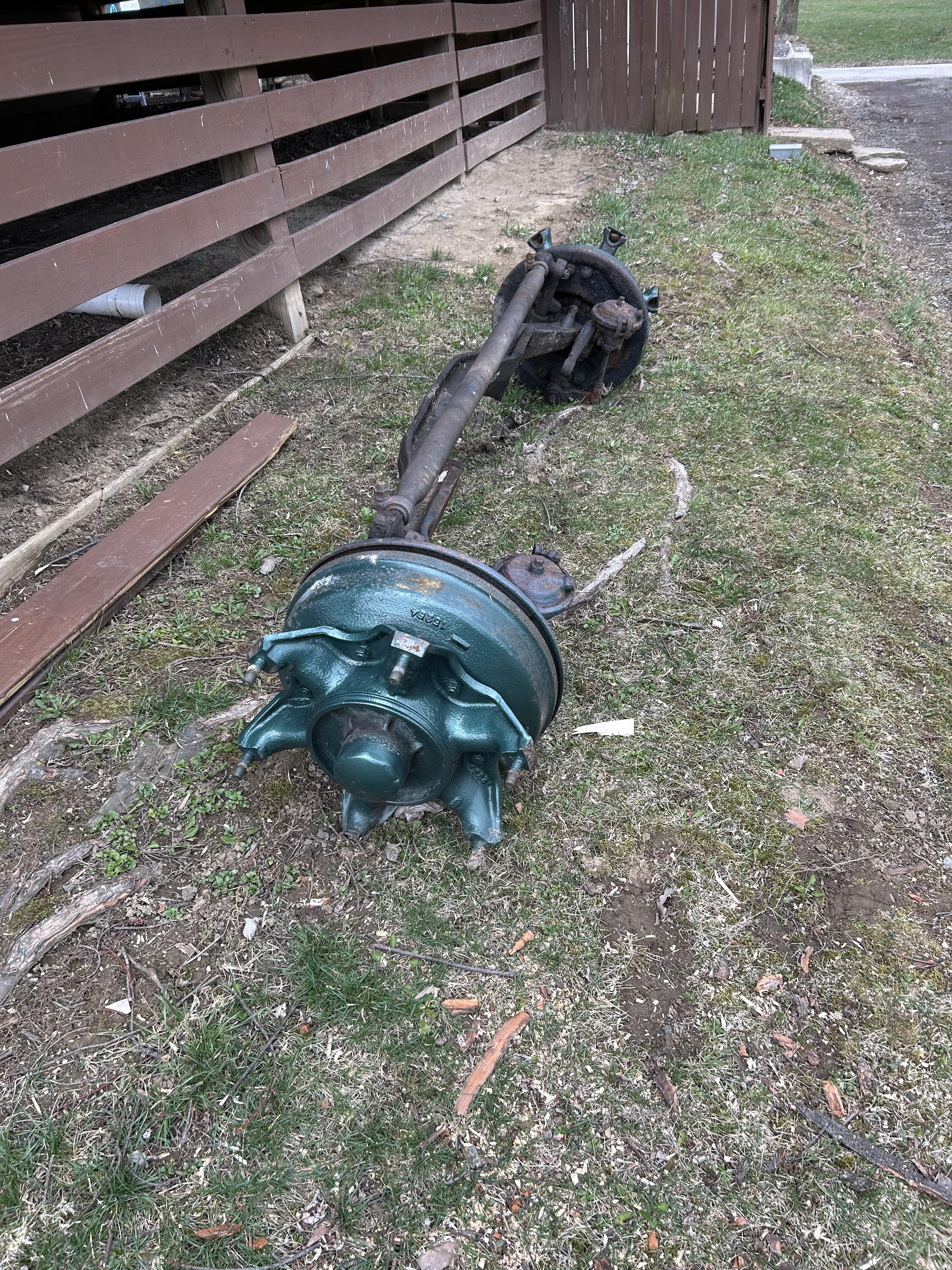

  15. he’s the original axle wheels are just lifted off the ground
  16. After a bunch of hunting I found an axle I felt that would fit the b model got it for 250 bucks so it wasant that bad came out of a Thomas cab over bus the center bolt holes were only 1/2 narrower so a come along pulled the springs together into place the u bolt holes were close too biggest thing was trying to wife out where the wheels would sit in the fenders being the axle had no wheels on it but other than that it’s going fairly well I’ll post some pics
  17. I’ll be starting a new topic here I have a B42 and I’m swapping out the front axle to one with hub pilot hubs I’ll try and post what I did and what I’m running into I’ll post it it in drive line and suspension
