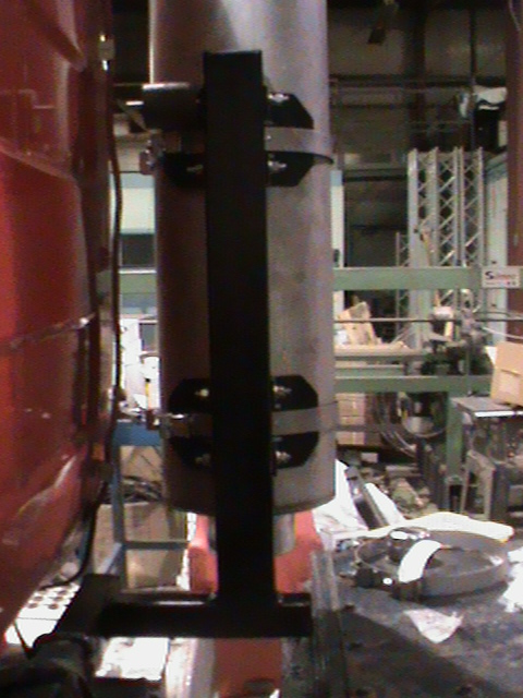

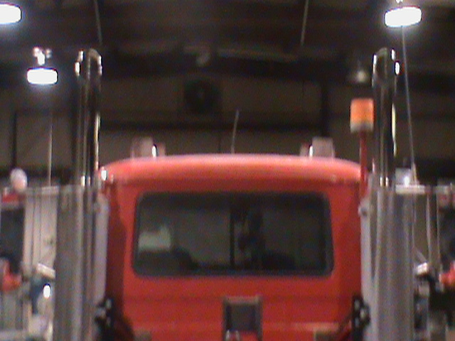

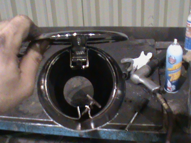

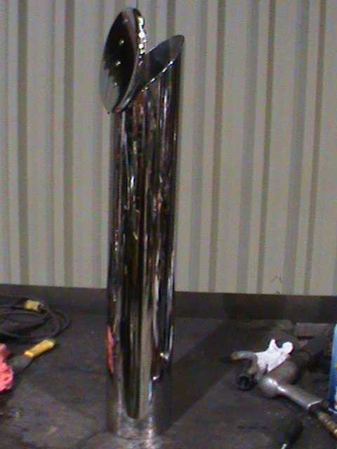

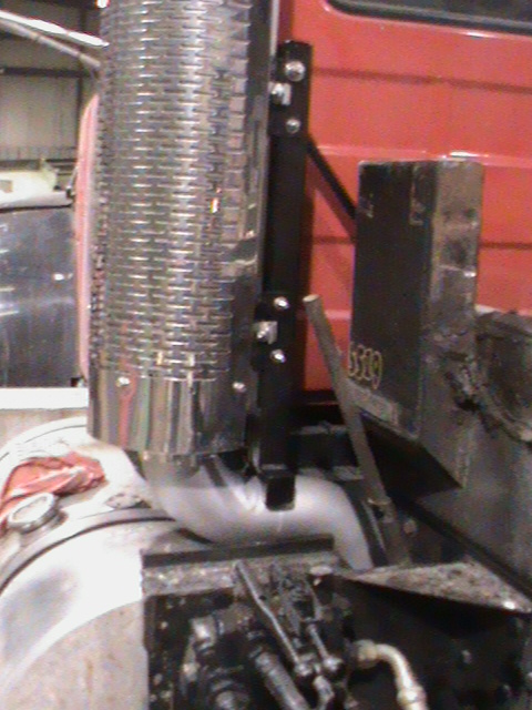

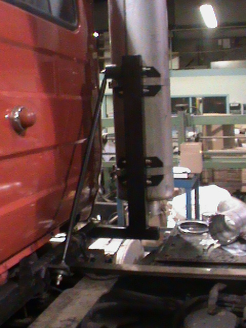

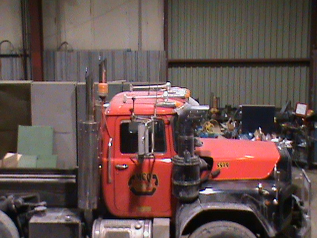

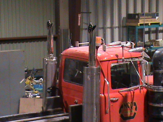

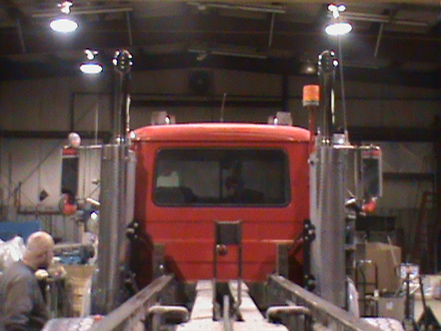

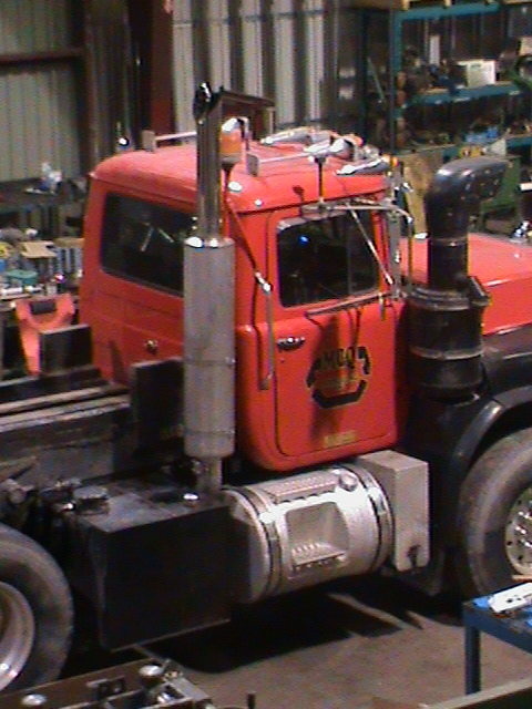

  11. here some pic of what I got done so far, will be putting on left(driver side) stack this week end! The mufflers Im using are donaldson 5 in 5 out 10" high flow, noise canceling(same as PPower) with 30" slash cut w/internial rain caps. I had to make new brackets from scratch to fit around the roll off unit. james

  17. hey, yes twin stacks is my goal. I wish it was as easy for me in the 3rd pic, I have a rolloff and the rails sit 6" from the cab, and hyd. lines underneath. I got it all figured out(me thinks!) have a good day and DONT buy a new truck!!
  18. hi, Im lucky, mine has a front mount pump. I've spent the last two days making battery box's(both are rotted) I will take pics monday of what I've done. thanks for taking intrest james
