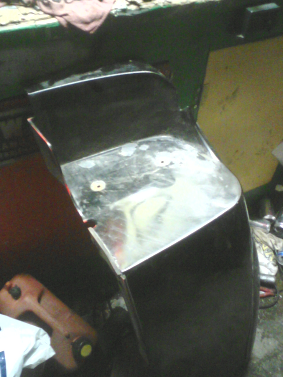

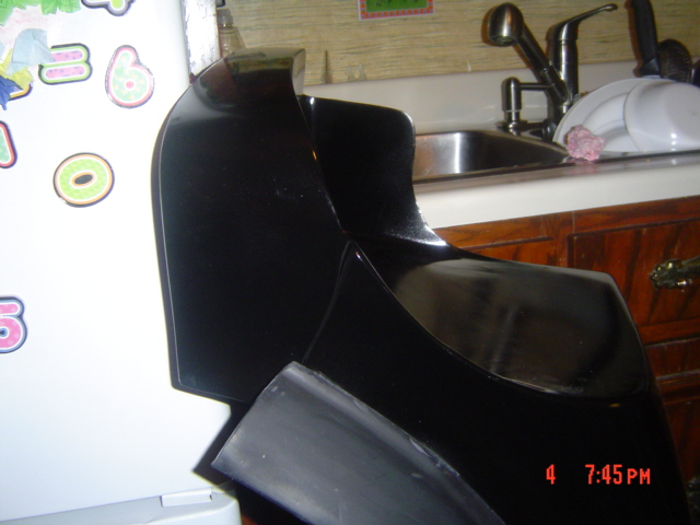

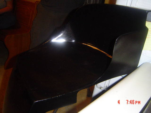

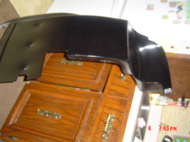

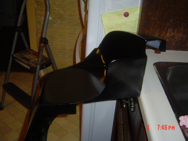

  3. here's the left, we made this out of factory left fender. I think it turned out great! We copied the factory right! bobo
  4. IM so happy I could shit an easter egg! They look awsome!
  5. OH JOY!! the fender is ready to be picked up today! post pic when I get them home bobo

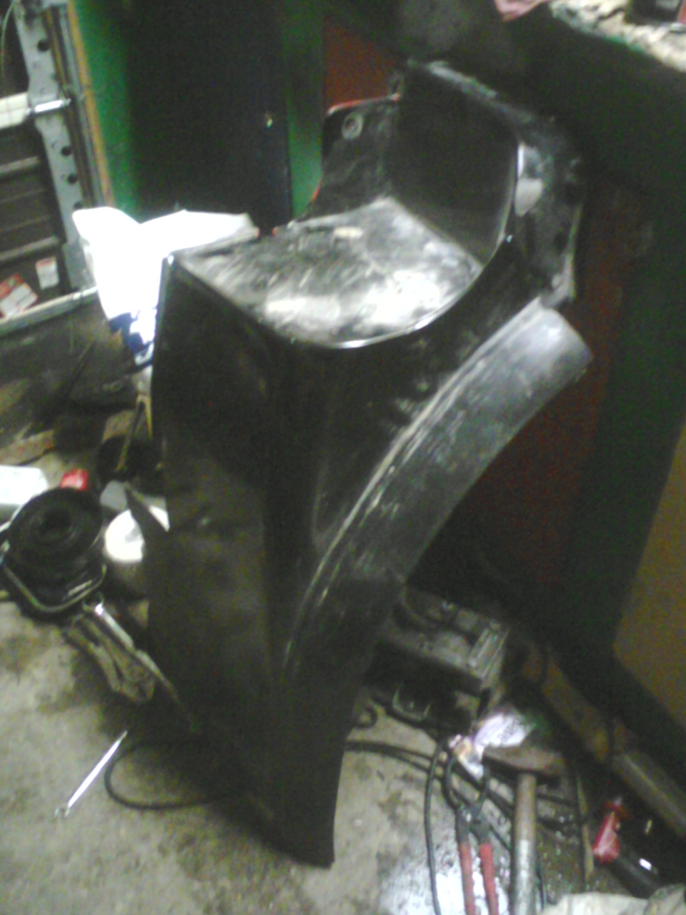

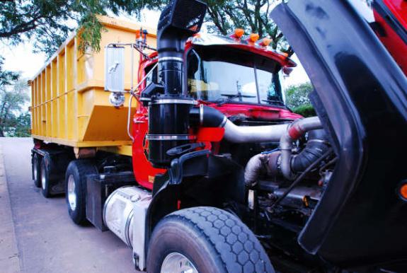

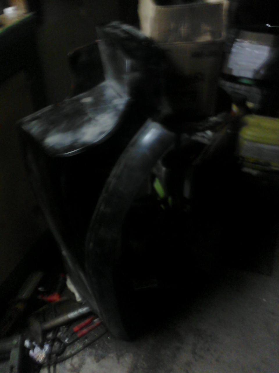

  11. Hey It's a RB(axle back) it has quarter fenders that are attached to the cab, not the hood. You'll see in the pic the cut out Im talking about. Luckly the fender are a mirror image excluding the cut out, making the job easier! james
  12. OK so I've made the bracket, got the air cleaner, bought the clamp rings(258$ APEICE!!) got the left and right fenders off. had to take right off to mimic the cut-out on the left. still need to make stiffner plate, and get alum. pipe for under hood. Im guessing I should make a 45deg or a radius facing forward, where the pipe will join in with the other? james
