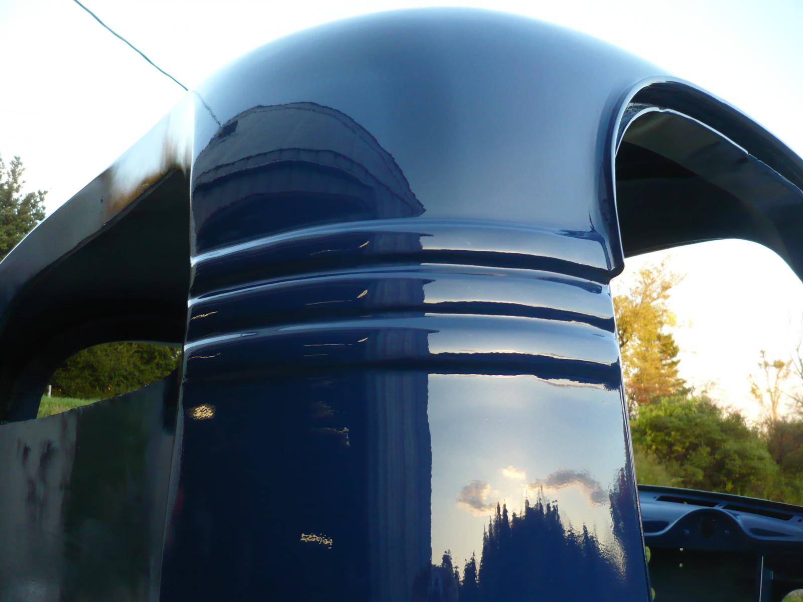

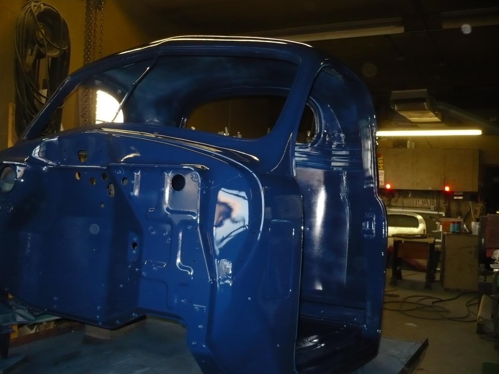

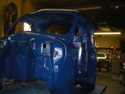

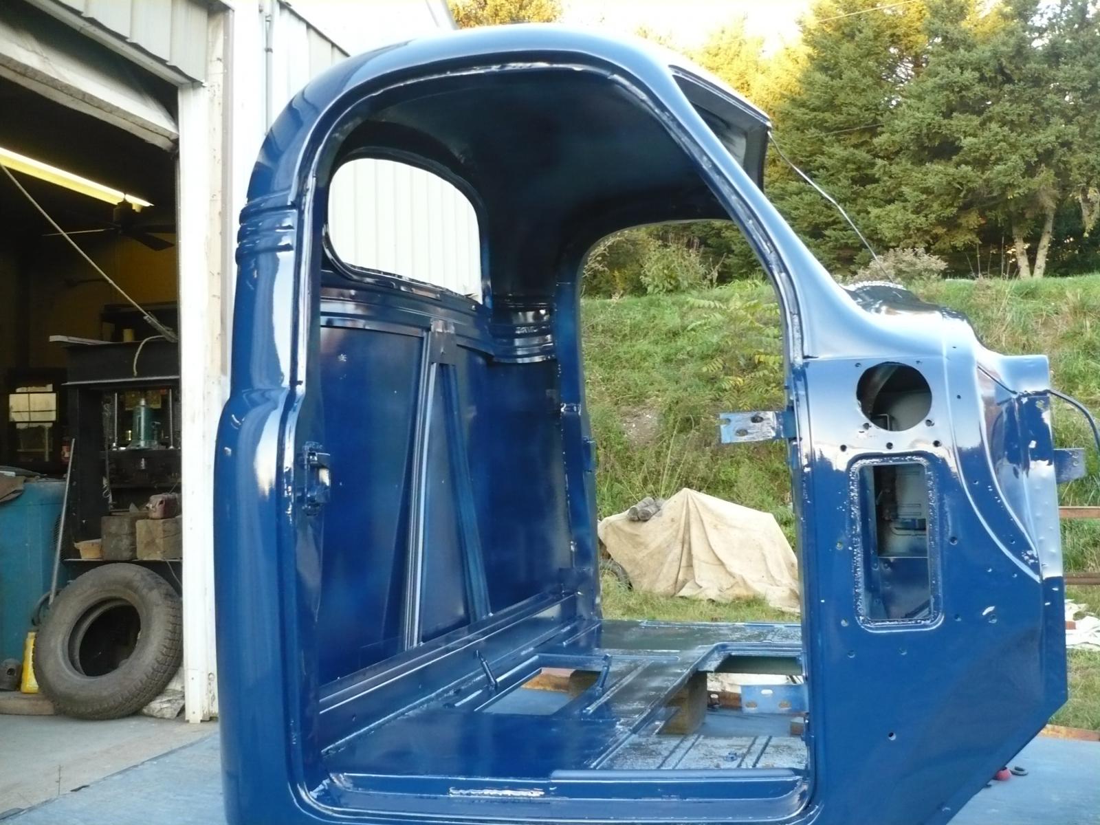

  19. I Missed Gearharts yesterday but we got the b model cab painted, what do you guy's think? I just put a few on here but there are more on my gallery if you want to look at them. Steve
