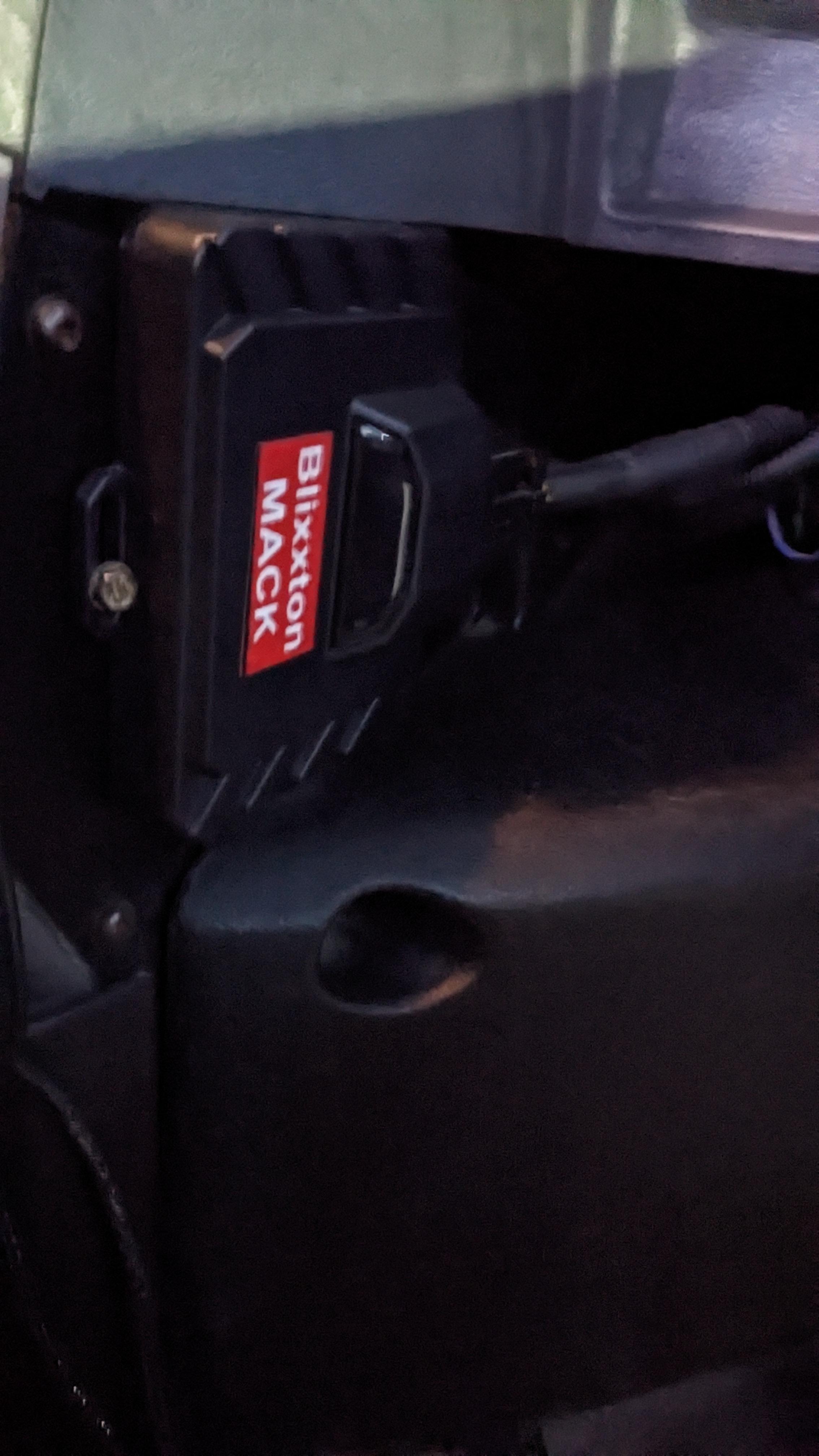

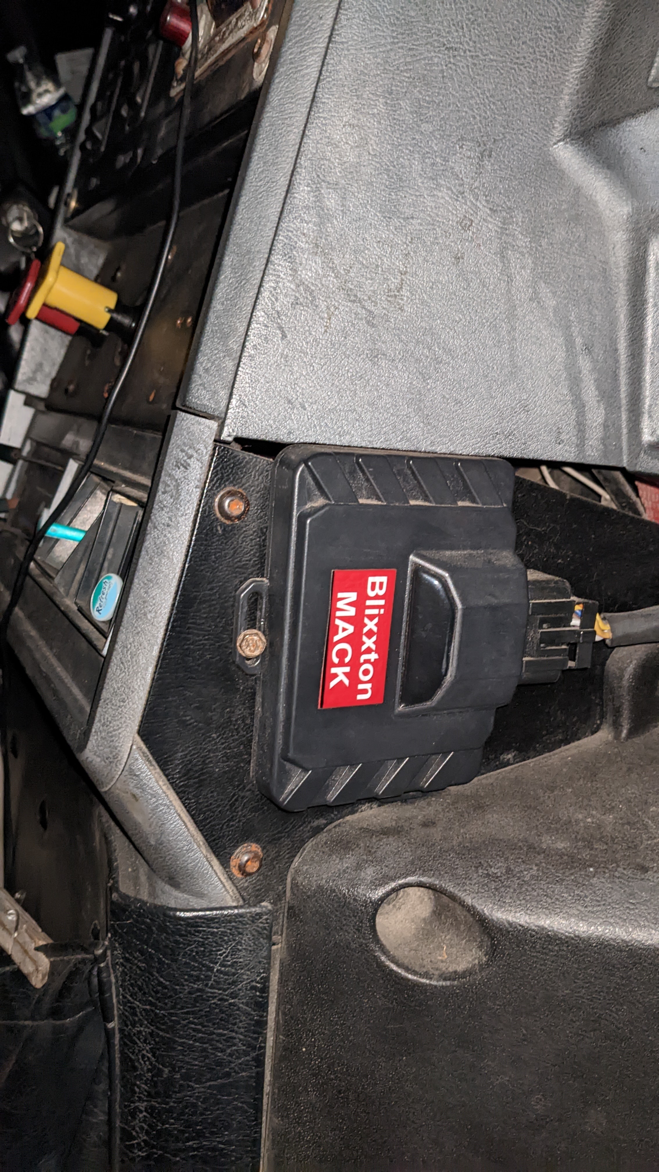

  6. Before the inframe and before we converted it back to a mechanical engine we had the blixxton. The egt's would climb super fast, you had to constantly watch the pyro and back out of it and drop a gear. It would easily go past 1100 if you didn't pay attention.
