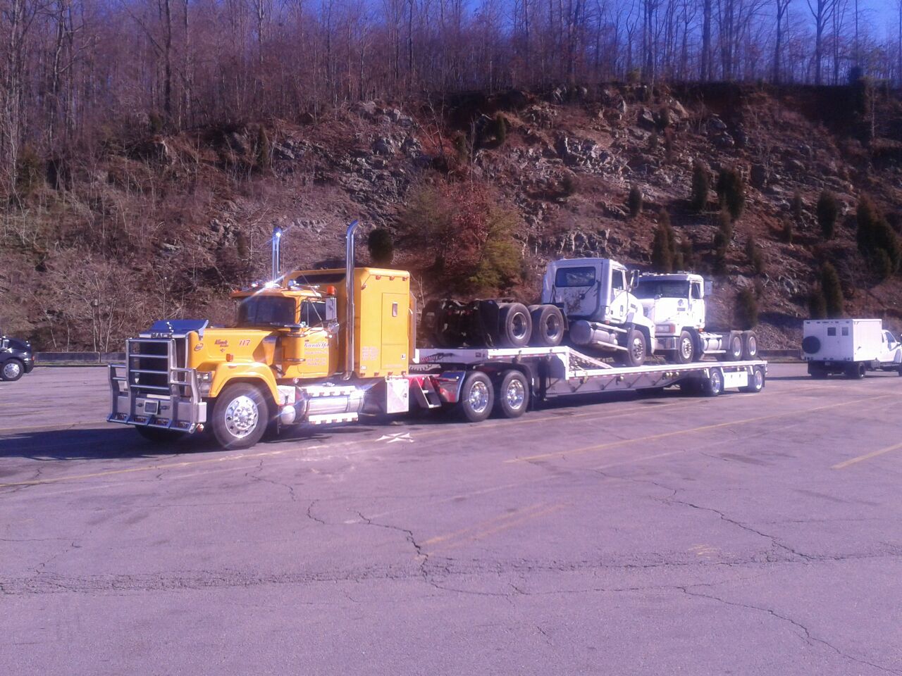

Thanks! I appreciate the compliment. It's a 1990, 613 series, E9, inline pump and injectors spec'd by Steve Trevitz @ Mack Powertrain and work done by Antrim, with a Holset HBT4C turbo. Tranny is a 2180, with 3:87 rears on airride and 24.5 rubber. She pulls about 38-40 lbs of boost and the only thing around hear that will keep up with her is another E9.
It's actually a Bison. It's made by a company called S&V Manufacturing in Winnipeg, Manitoba. I think their web site is sandvgrillguards.com. I have a friend that has an Ali-Arc on a CL and the Bison is a lot better built. I have heard the Ali-Arc and Herd will no longer build bumpers for trucks that are no longer in production. Don't know if that's true or not. The deer population around my home has exploded and Superliner parts are getting harder to come by so that's why I bought one.
