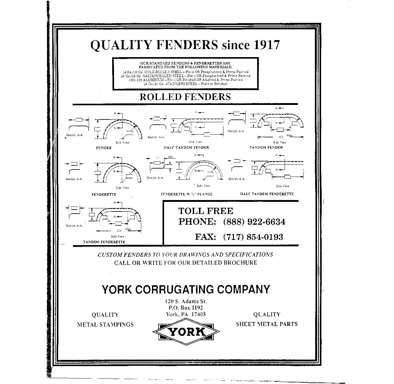

  8. 16390 Mack used a company in PA called York Corrugating to make many of the rolled fenders. These were used used on many L and B model fire pumper bodies. Looking at your H model fenders they look very simlar to the rolled design used on the fire pumper fenders. York Corrguating is still making fenders and fenderettes. They still have all of the original roll wheels etc to make these fenders and make them for many of the firetrucks and trailers you see on the road today. See the info with the typical fenders they make.Contact Jeff Smith at 888-922-6634 ext 253. Hope that helps, Firemack
