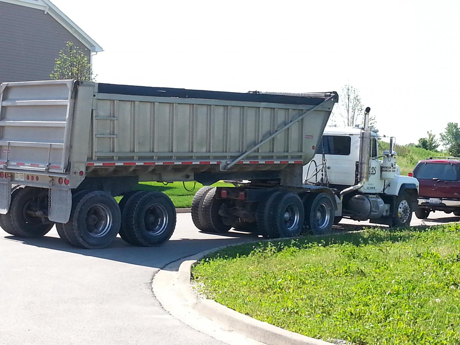

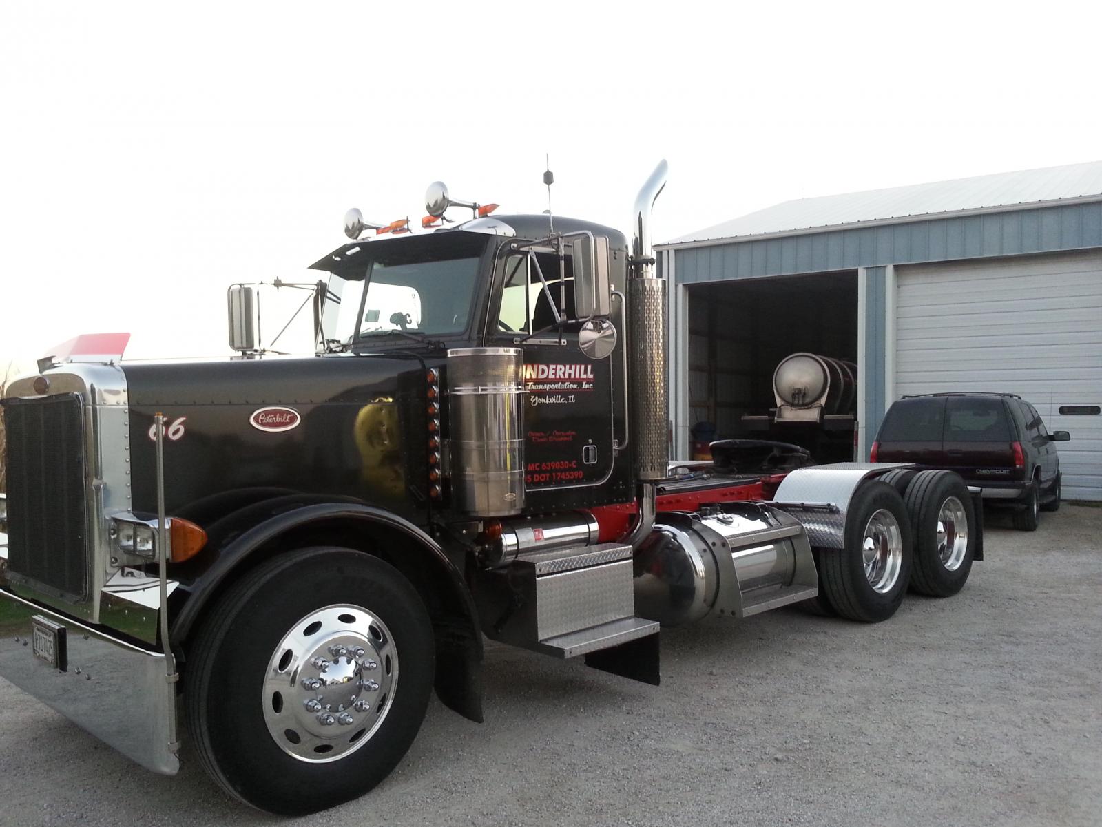

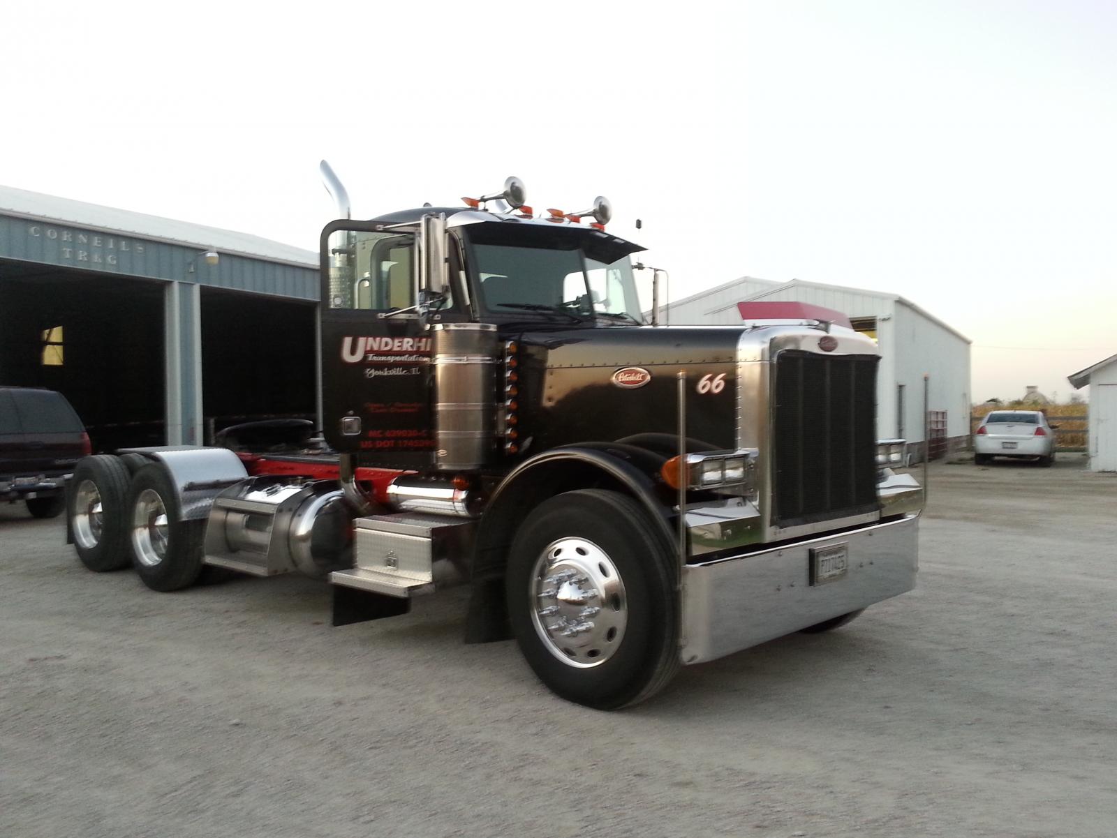

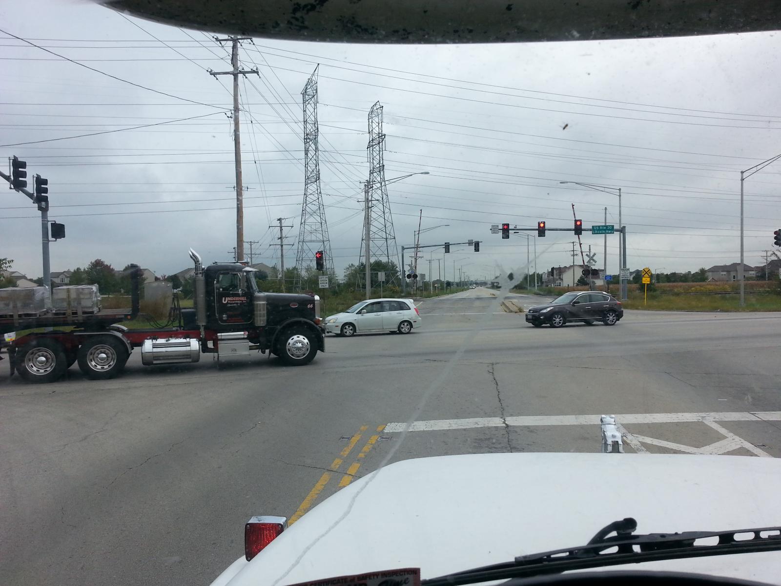

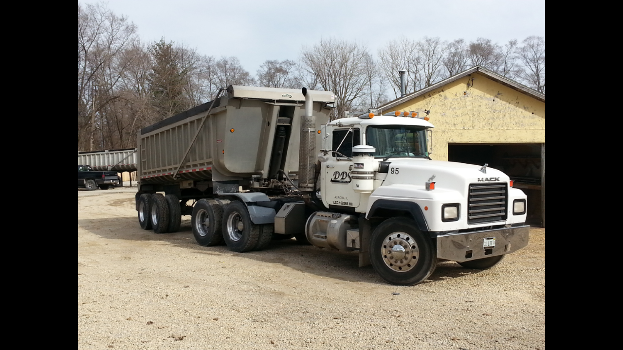

Ok first off I love my 95 rd with a 9 speed and 442 rears. It does what I need it to do and I've made it one of a kind. I have camelback and my trailer is spring suspension. It rides rough but I really love the mechanical throttle over the electronic stuff but it does wear me out at the end of the day. My mack has 480k on it right now. My truck is 188 wheelbase and I haul gravel. So I found a guy the other day that was driving a really sharp looking 98 Peterbilt it has a 3406e engine with 475 horse it has a rebuilt 10 speed transmission where the reverse gear ratio is a 12.12 which is pretty good for backing up at a decent speed. It has 390 Deering which I've always wanted it has full lockers and a Jake brake everything about the truck is awesome I understand that I probably won't make anymore money with this truck then I am with my Mack because it's a heavy truck but at the end of the day it's either choose an air ride trailer and keep the Mack or keep my current trailer and upgrade the tractor which will ride like a dream I think. The guy keeps excellent care of it and was thinking of selling so he could get a sleeper truck. I could go on and on about how its a good truck and would ride a lot better than what I have. the Mack makes plenty of power and I enjoy it for what it is but at the same time I feel like I deserve to have a very comfortable riding truck my dad has a 96 Peterbilt with a 3406b engine and he's 65 years old and still doesn't want to sell it lol I drove the 98 but didn't like the electronic throttle at first. IM sure I could get used to it. My main question is, is a 215 inch wheelbase too long for gravel hauling and new home construction? Should I keep the Mac and buy a brand new Air Ride trailer and be happy or ultimately will just kidding a nice ride in truck be the right decision again I have nothing against my truck right now other than the ride holiday and this truck came up and I know how hard they are to find without all the electronic crap on them
