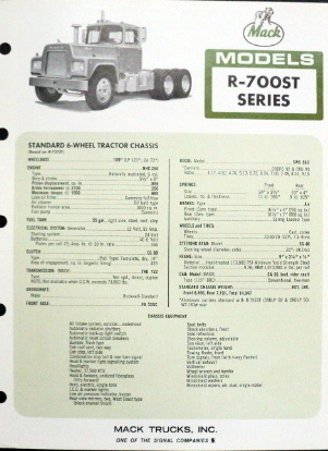

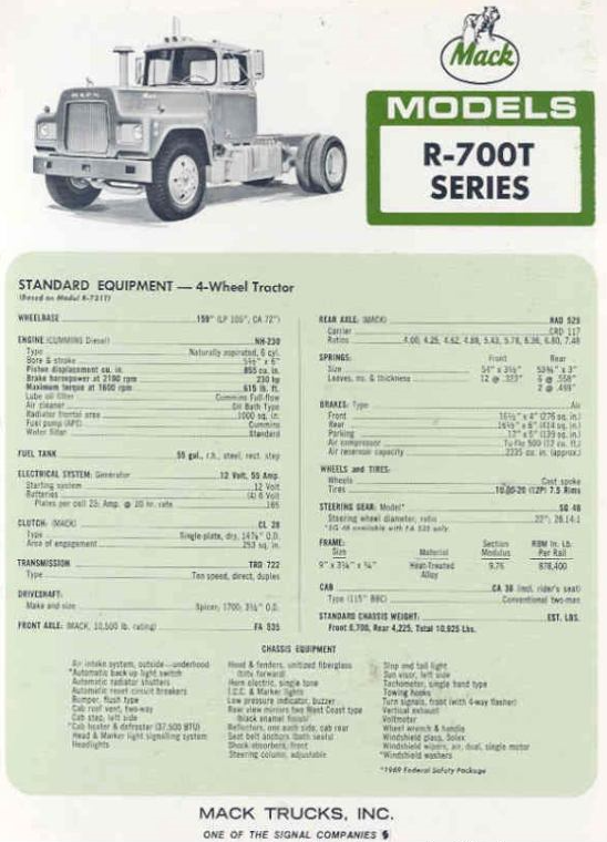

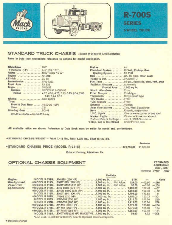

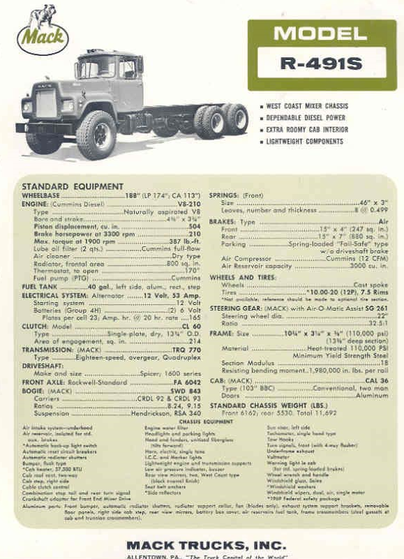

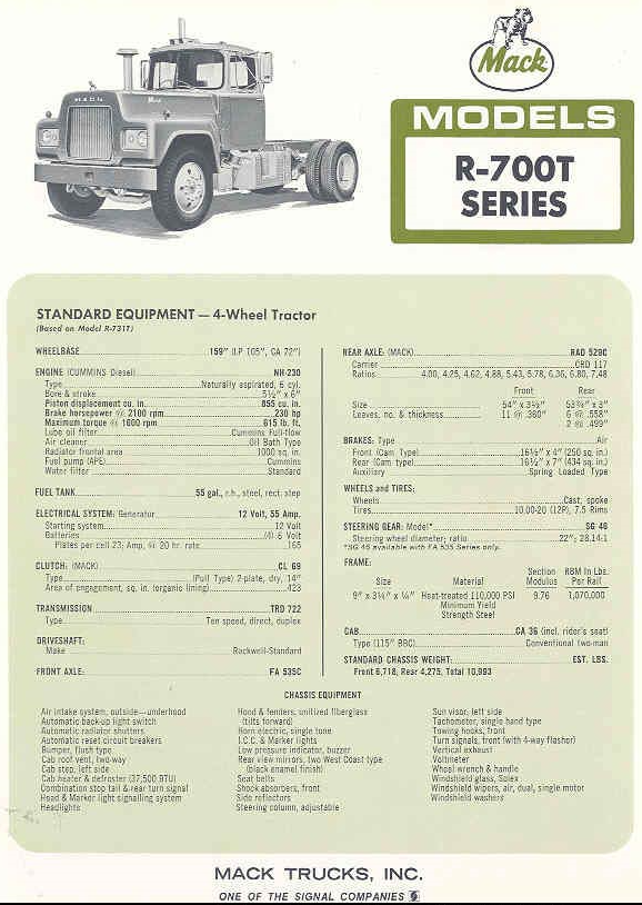

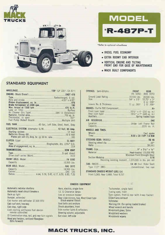

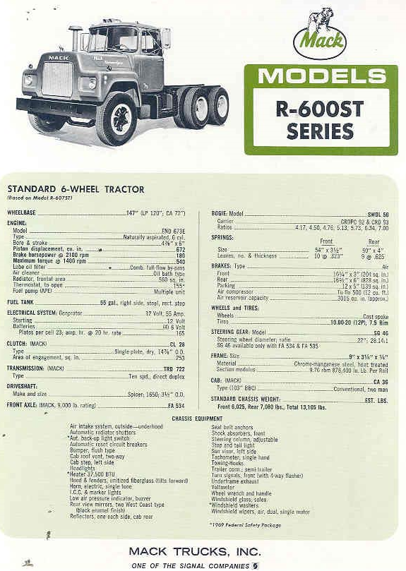

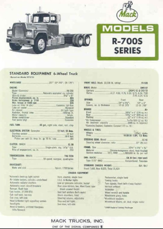

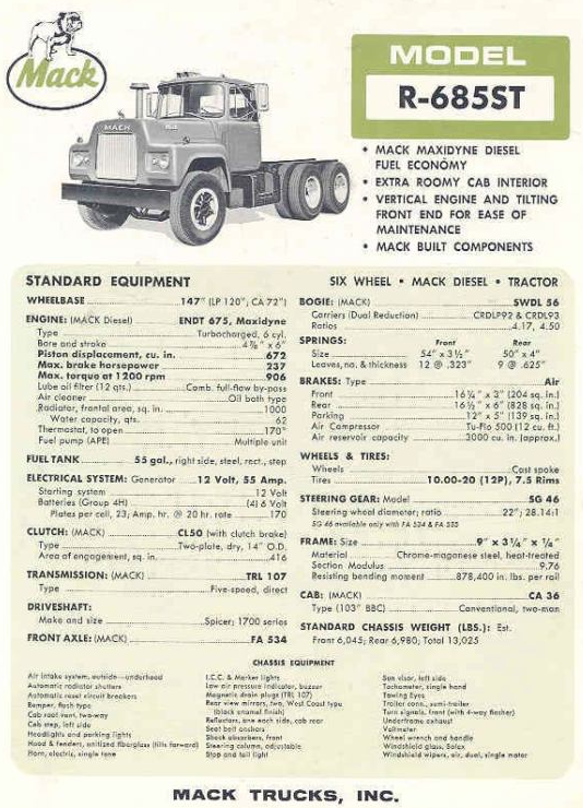

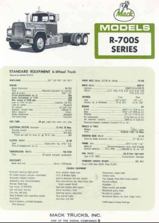

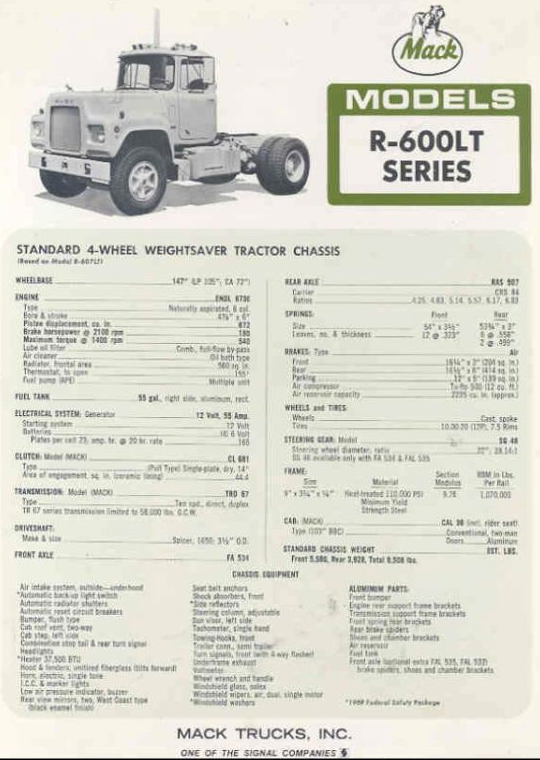

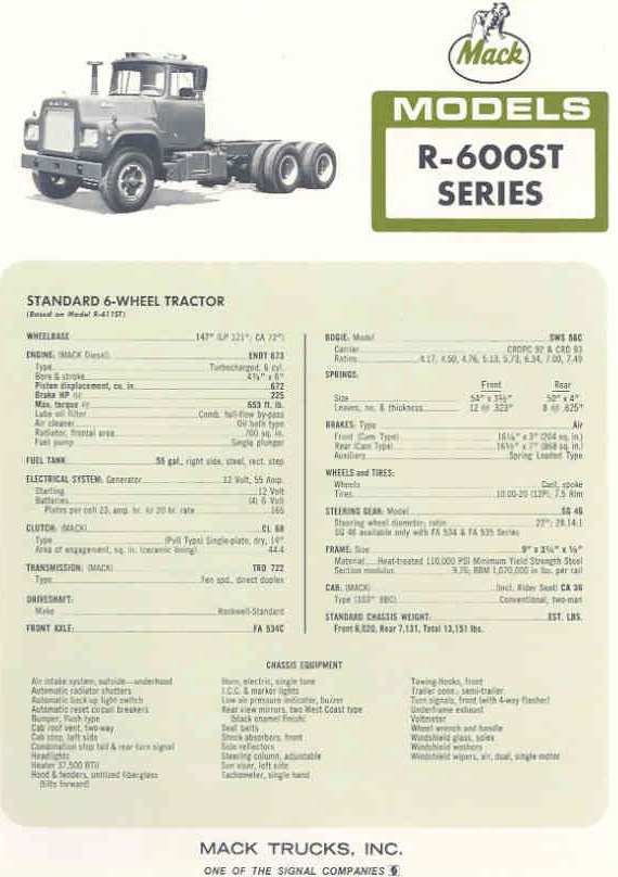

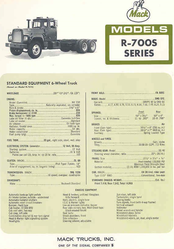

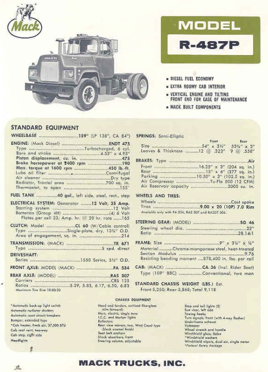

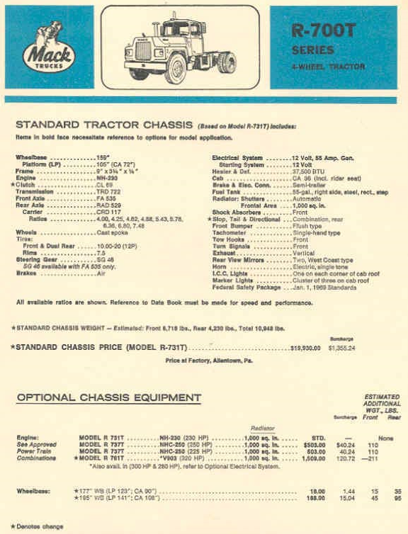

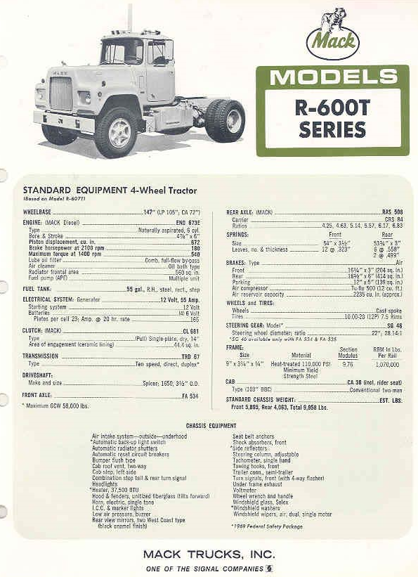

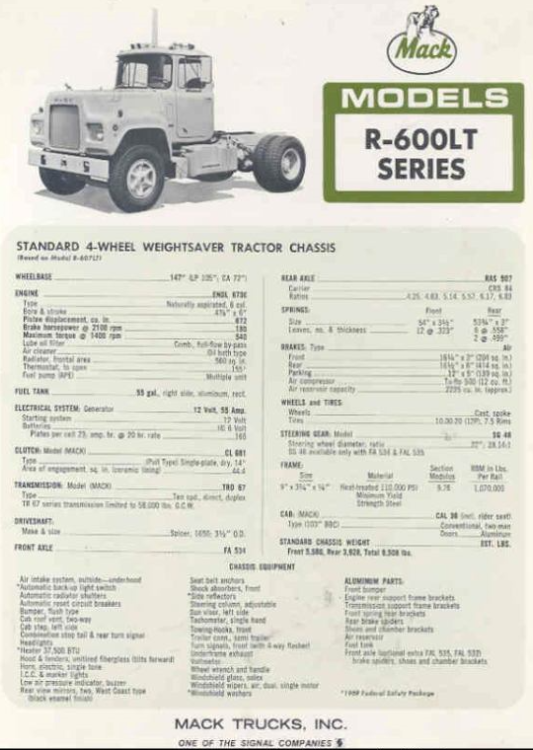

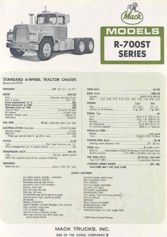

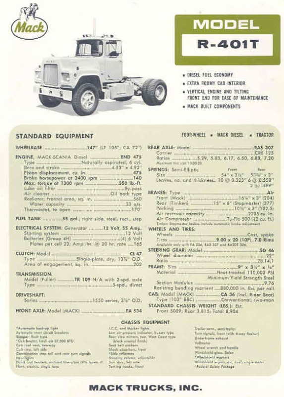

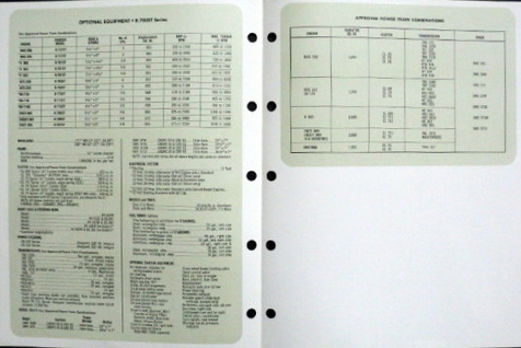

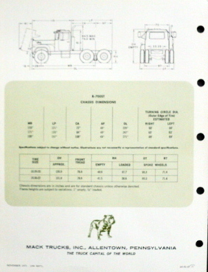

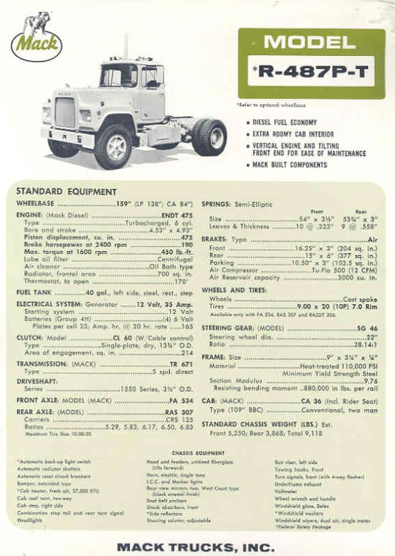

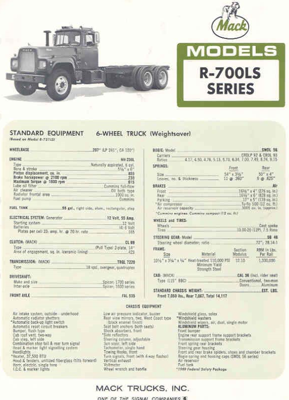

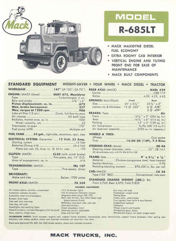

Not so much for the veterans, but hopefully helpful for some of the newer members… The 607 implies what the standard engine was…maybe the n/a END-673P. But, as shown in those brochures, there were optional engines available. Could have been a couple of different engines factory-installed. The “S” shows that it was originally a “six wheel” (tandem) truck The lack of a “T” says it was not originally built as a tractor, but rather as a straight truck. Pretty common on DMs, since the primary market was “Dumper and Mixer”.
