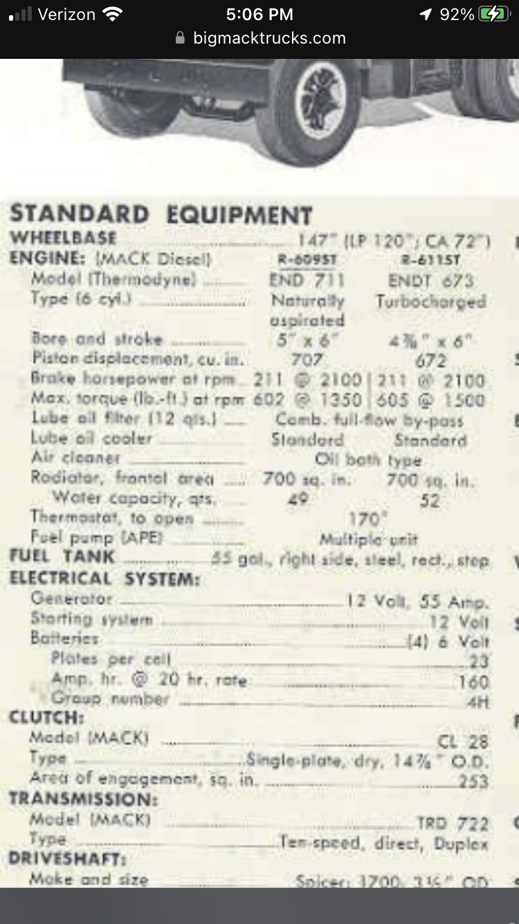

  8. Howdy, Larry! It varied from year to year here’s a 211hp ENDT-673.

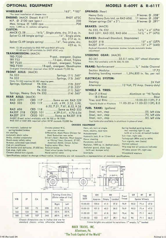

  16. This particular (1965) one is a good reference, because it shows the "standard" configurations of 2 different R600 models, and it has the second page which shows options. You can see the optional engines, transmissions, and clutches...among other things...on the 2nd page. For instance, it shows the ENDT-673C engine option for the R611. Wish I had a bunch of these in person!
  17. Mack called single-screw models "4 wheel" and twin-screw models "6 wheel". You can see examples of that on the brochures I posted. Most of those 673's had a HP rating on a tag somewhere on the engine. Can't remember if it is on the engine or the pump, though. I'm betting 211 HP, as I think that was the rating on the ones with no other letters after the engine model number.
