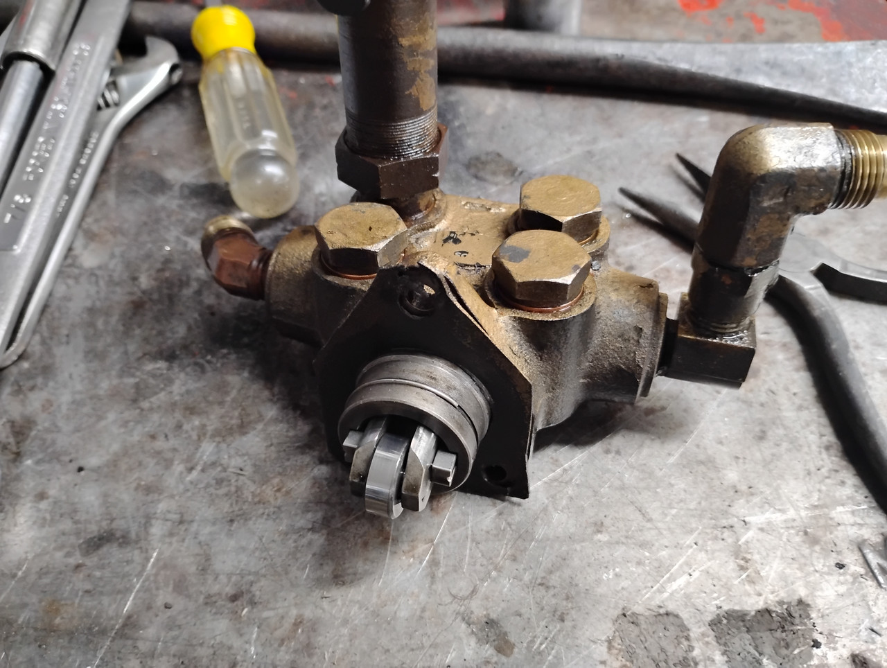

Ok, seems my original pump is not keeping up.  I can manually pump up 20# but after starting and running it drops to 10# and then barely holds 5# and then it has been just stalling out.
I was perplexed with it not wanting to stay running after a few minutes until I put a pressure gauge at the filter and then I can see what is going on.
Anyone have the proper part number?
Thanks.
Larry
Thanks.
Bro before you go condemning the pump ! Have you checked the tank vent! Is the lines to and out of the filters clear!  I have been burned by other people’s diagnostic conclusions before !
Check before you canon!
just sayin!

Fuel system was no issue last fall.  Now it suddenly won't run with new motor.  I had lots of issues with getting this primed up when I first started it and it only had 2ft of hose to can of diesel.  Then it really had problems drawing from tank.  I replaced the new primer pump I bought with old bailing ring version from the 237 and it works much better.  I can hear it returning fuel to the tank after pumping up 20# of pressure.  After starting the pressure drops and won't recover.  I know it should be 15# idling as that was what the 237 had.  Too bad it is different pump or I would try it.
New lines from lift to filter and back to injection pump.  Remaining lines are good from before.  New filter also.
