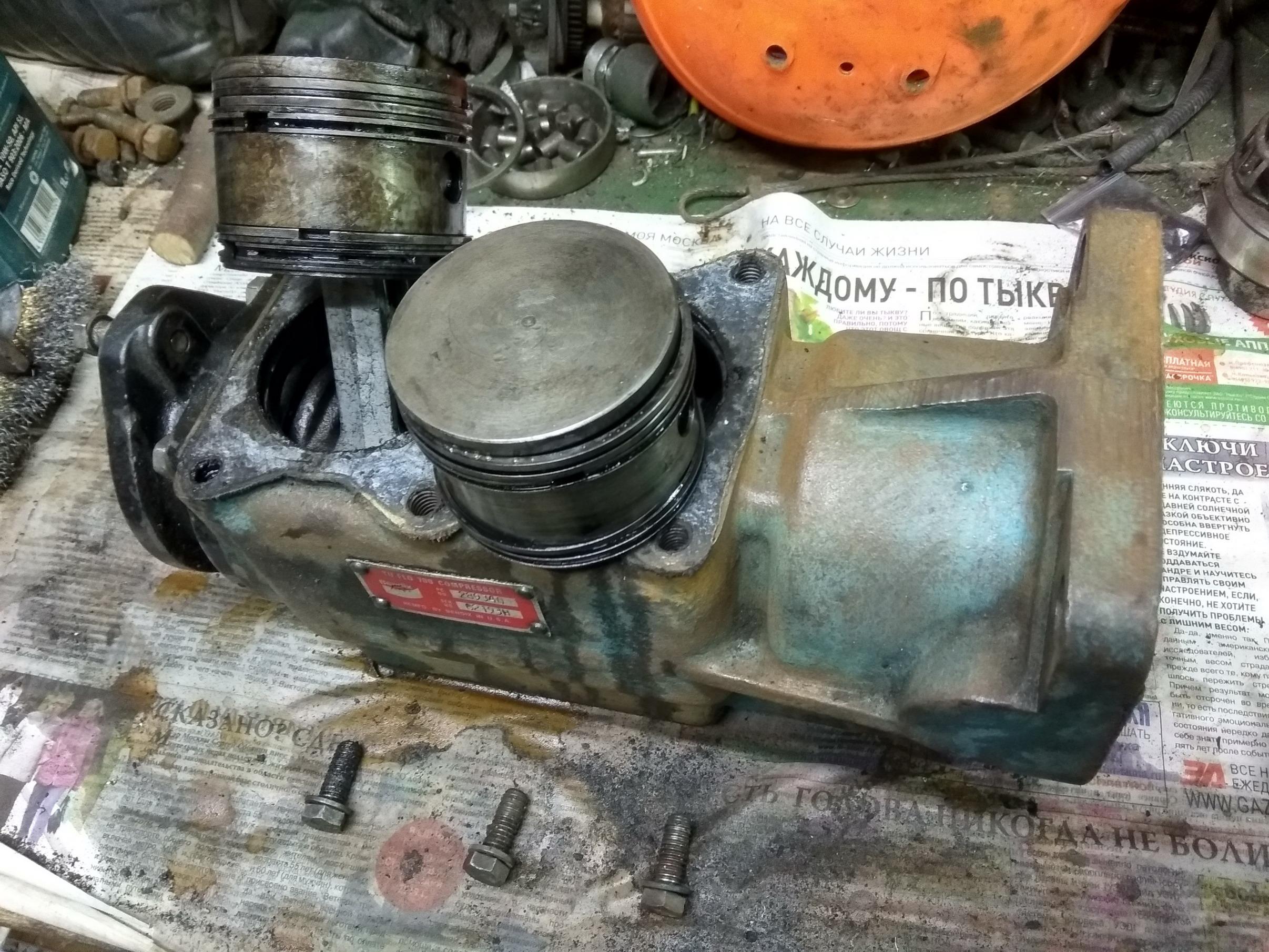

I have a couple of questions about these compressors though since my one is in fact not completely assembled at the moment.
1st - what is the torque for the conn rod bolts? I measured it when loosened the rods in the new compressor but the bolts had something looking as a thread lock on the threads so unscrew could be harder than the specs. And should I use any Locktight or other thread lock compound there? I know that wouldn't hurt the deal but better to learn what is prescribed by the manufacturer.
And the 2nd. I probably have count the matter but still have a little bit of doubts. I tied to figure out the way the connecting rods oriented. Sure marked all the parts and the old compressor had the rods with the markings (part#) to the drive end (up front). But that NOS one had one rod to the front and another to the rear. And I'm sure nobody opened it before me and the parts were std which meant factory assembly. Also pistons had no arrows pointing any direction for the fittment. So overall it looked like Bendix saw no matter on which way to install pistons and rods. I put them as they were in my original compressor - same way up front. But if anybody may confirm or argue my guess I would like to hear the suggestions.

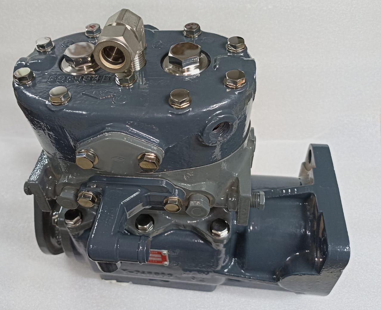

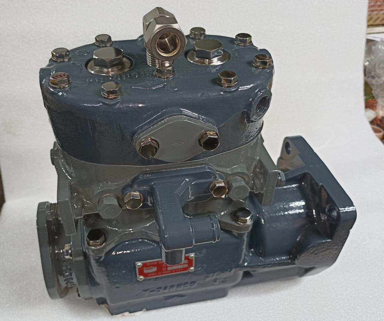

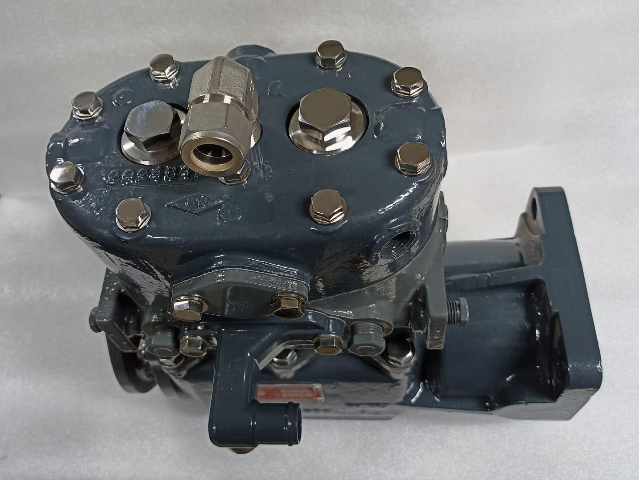

Update on the deal.
Since I found no data from Bendix on how to torque conn rod cap bolts I resolved to use the figure I've taken when was getting those bolts loose. The compressor I took them from was NOS and looked like nobody touched its insides after the factory. That time I grabbed my late granddad's torque wrench and checked out the release force. The reading was 200. That old thingy had been calibrated in kg-cm so the figure was equal to 2 kg-m or about 14.5 ft.lb.
What I noted the threads of bolts had some yellow color stuff on them which appeared as thread locker. So the reading could be higher than actual torque limit. If I fit a common steel bolt into a steel/iron boss I'd grease the threads. In that case I didn't want grease to not make the point loosier but wanted something for the thread to spin easier. Thought about thread lock but got worried on even higher loose torque increase in a case I ever remove the bolts again. So ended up using silicone gasket maker I use alot over different spots and was very familiar with its properties.
So "greased" the threads by sealer and applied torque carefully tracking the increase of the force. Turned out I was easily achieving those 200 digits and maybe a tiny bit more after which further turn of the wrench made no increase to the torque. Which meant alu thread's deformation. Again, I kept very high accuracy so that overtorqueing became 5-10 degrees no more. No worry for the thread's damage I guess. All 4 bolts showed similar scenario after which I closed the bottom cover (a kind of an oil pan) and finished assembly of the cylinder head.

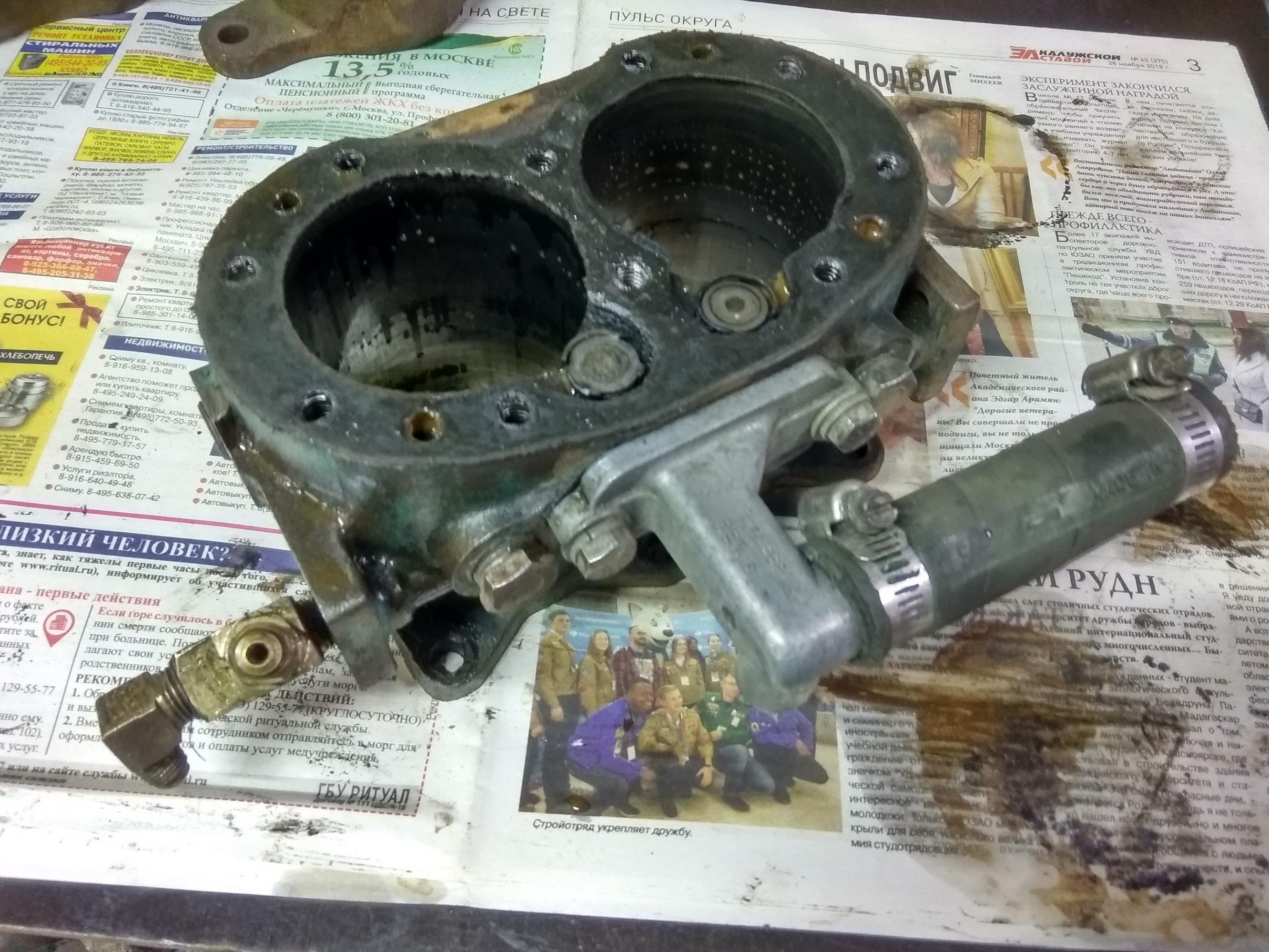

Looks like I should say sorry for a kind of propaganda. Those newspapers I lay on a table were printed by Russian Communist party to a certain election event. They were spread for free and my mom grabbed a stack somewhere to give me for my garage means.
