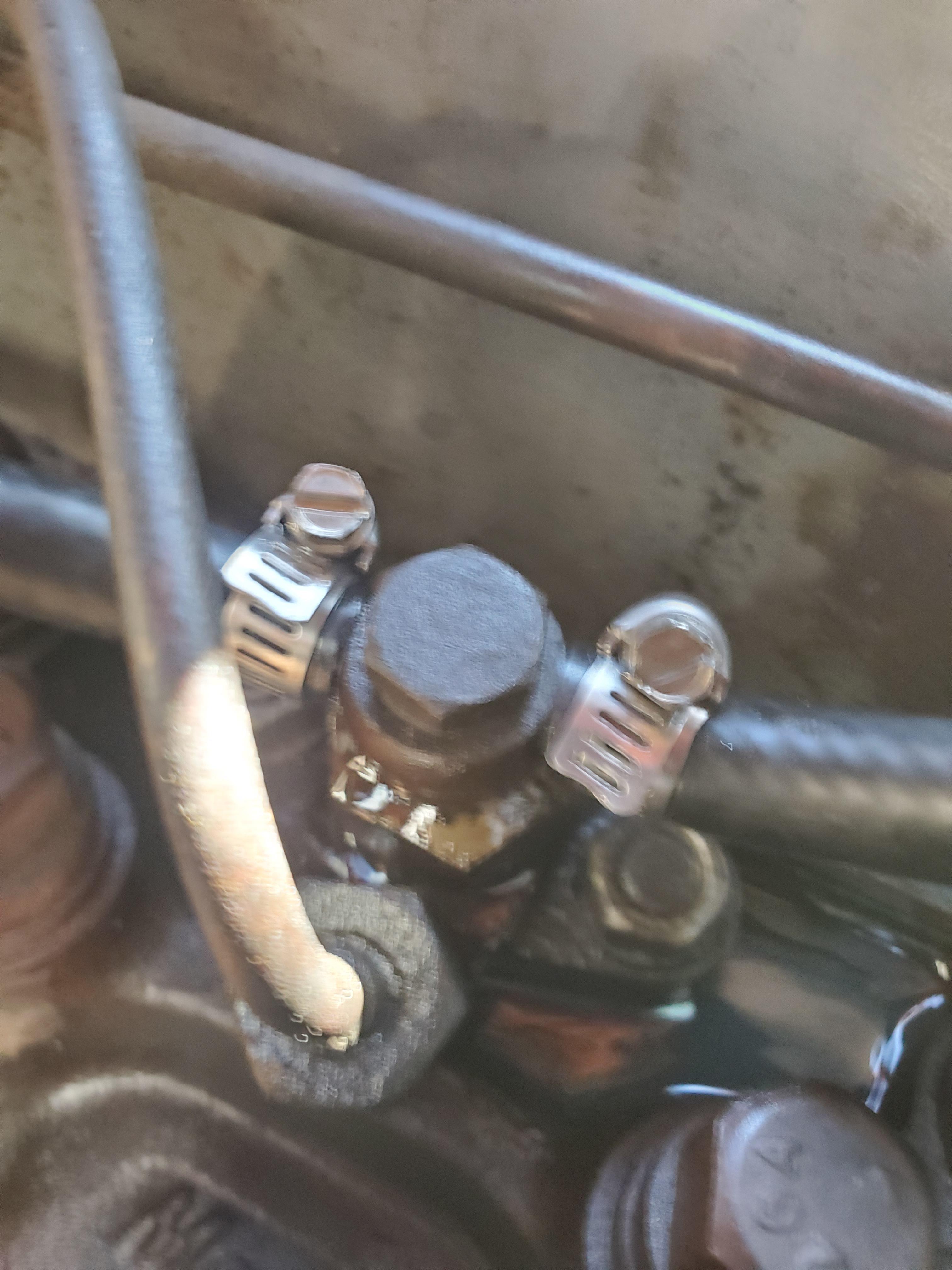

truck seems to run fine around town but when I am climbing the canyon occasionally it will start to miss (more than just loosing power) and I would have to pull over and let it idle for a bit.  Then I could start back up again.  I do understand about a liquid filled gauge, but would think the gauge attached after the secondary filter would mellow the fluttering a bit.  I did notice a couple of times that the gauge did drop to zero for several seconds.  I did pull the plastic check valves and they did look ok, but don't have new to compare against.  Truck only has about 160,000 road miles (not sure about motor miles being there is a pto running a packer) but then again it is 47 yrs old and sat for about 20 yrs before being put back into service about 8 yrs ago.  Truck only really works part time anyway, but I do know stuff breakdown with age alone
