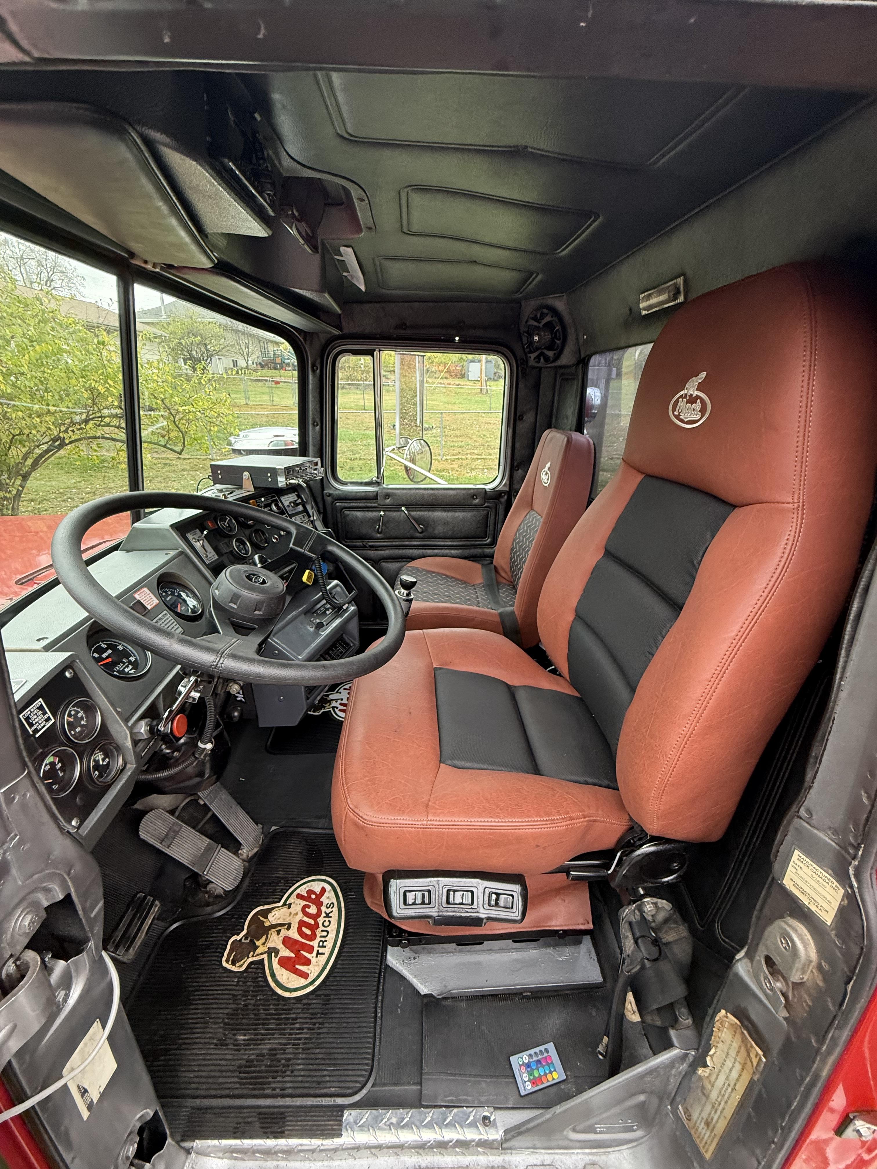

Jeff, I have some NOS 20 inch VIP steering wheels with the Mack base and Mack horn button medallion.  They are Mack parts supplied by VIP.   These are 20” though and not the smaller 18”.   I have one in one of my ‘89 R688ST’s.

10 hours ago, mowerman said:
wow your truck is gorgeous,,,,or is that a very old photo?????
That’s about 4 weeks ago.  One of my 2 matched 89’s.  I put a matching upholstery buddy seat in too right after that photo.
