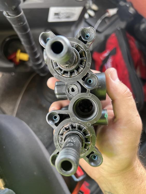

The problem is now the trailer air supply (red button) won’t stay pushed in. It just pops right back out. So I can’t even supply the trailer with air.
Edited by nbone28
1 minute ago, mechohaulic said:
(1) is this the new valve assy you had put in ? (2) did you try with trailer lines disconnected ? (3) by chance red/blue lines not crossed = had to ask ,
yes this is the new valve assemble, lines are off button still won’t stay pushed in, the supply for the truck goes in and stays in perfectly fine. it’s the trailer one that won’t. No the lines aren’t crossed.

you stated old valve was worn = but still usable enough to hook/ move trailer ; and have defective valve for return.
taking the new valve back, claim it’s faulty and swap it out
Red button will not stay in if the red trailer line is open to air. You need to put a dummy gladhand on to test the tractor.
I think, according to what we have read, that it does eventually stay in when hooked to the trailer after holding in long enough to charge the trailer. This is normal, the tractor is not the problem.
In all my years on my own equipment I only changed one MV and that was because I couldn't get the gasket to repair the old MV-2 on the truck. They don't go bad that often. I since got a new gasket for the MV-2 and re installed it, kept the gaskets in stock because all 3 of my truck had the same valve (which was why I re-installed, the replacement was a Midland and the rest of the fleet was Bendix MV-2)
