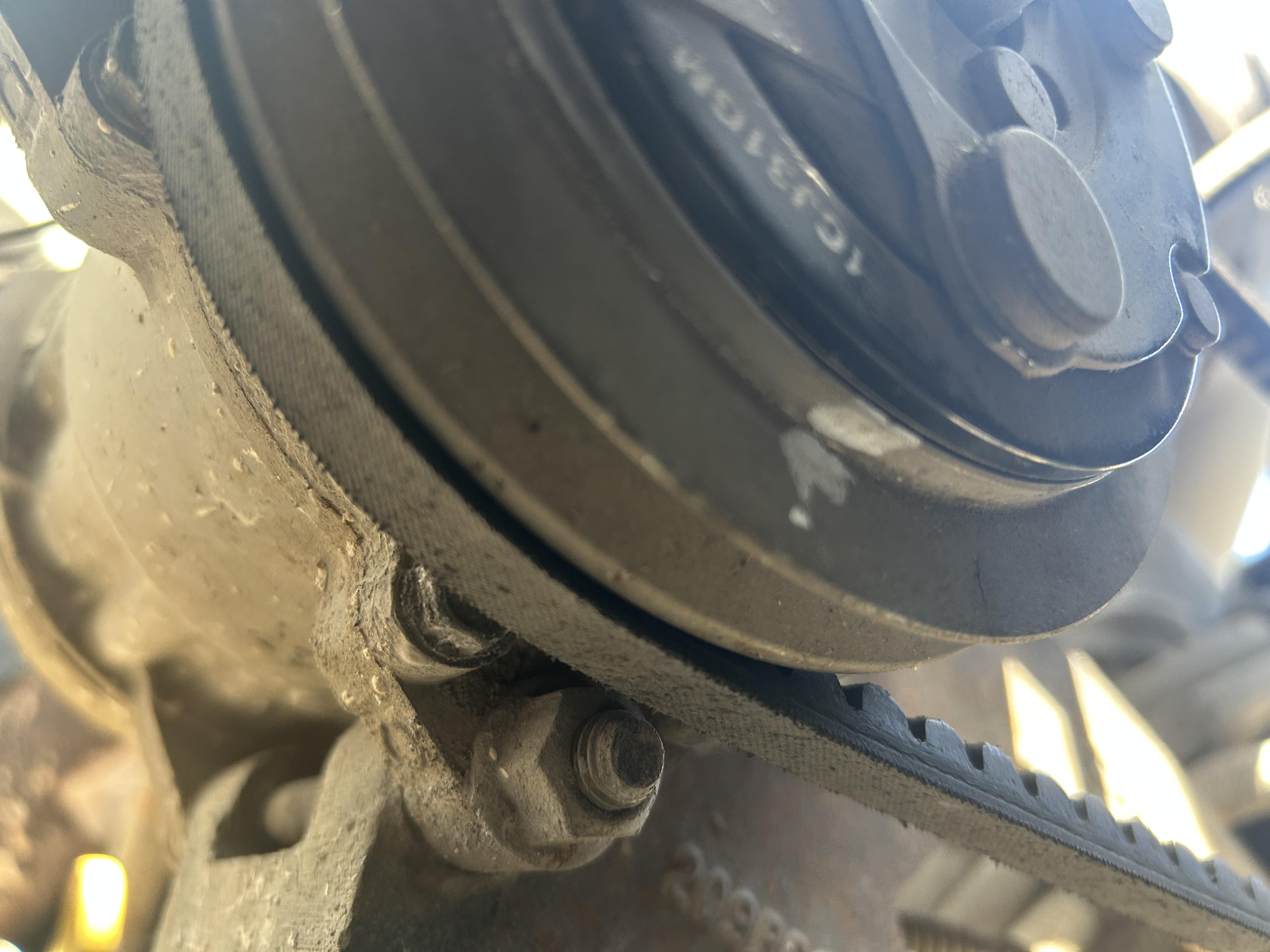

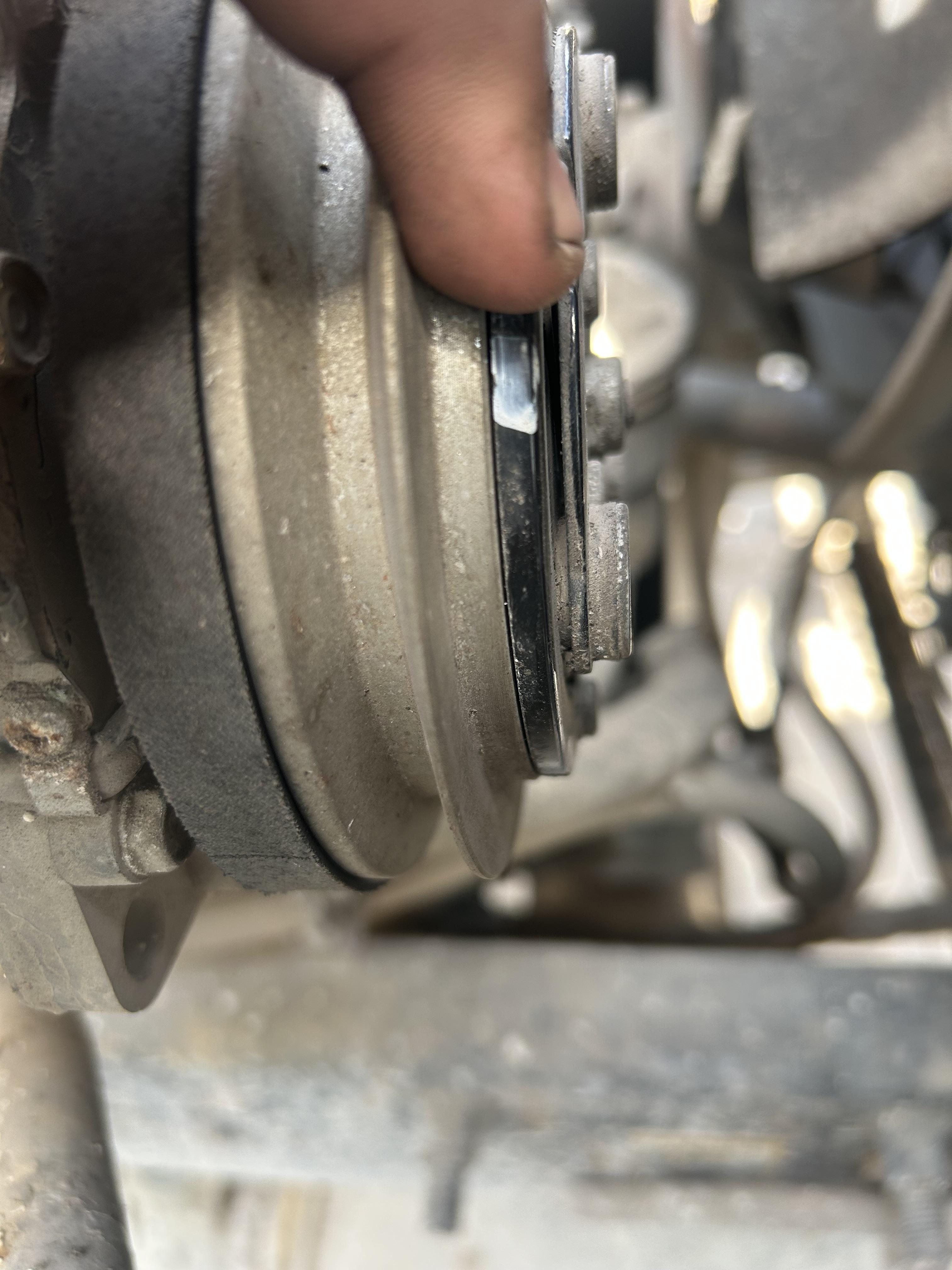

ac pump is kicking on ac is on just not blowing cold air it’s more luke warm i was told that the compressor and clutch can affect it

it is a sanden pump it’s turning on but i’m wondering if it’s not broken internally and causing issues.
