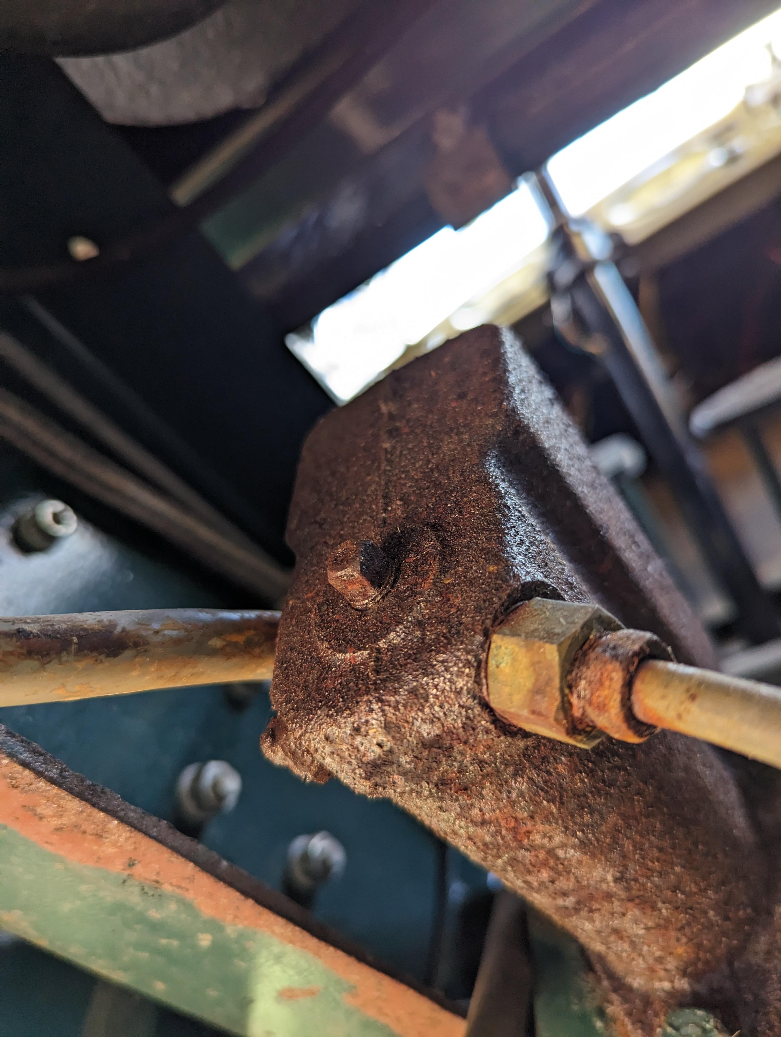

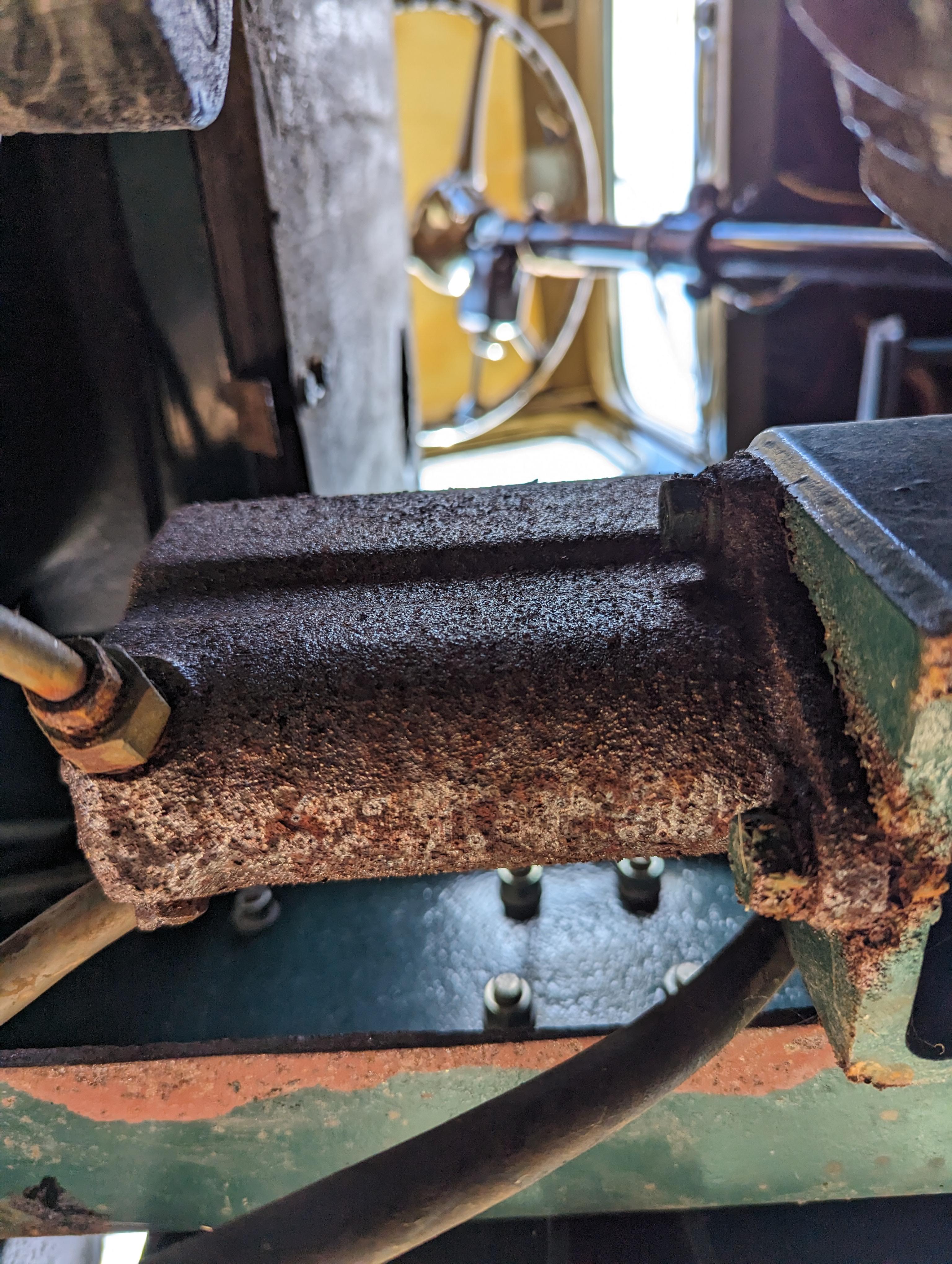

1948 Mack EE Brake master cylinder
Can you post a picture?
I sourced a M661 from Napa for my B20.  Its a single circuit master.  Its my understanding it was a very common master for most medium duty trucks of that period.

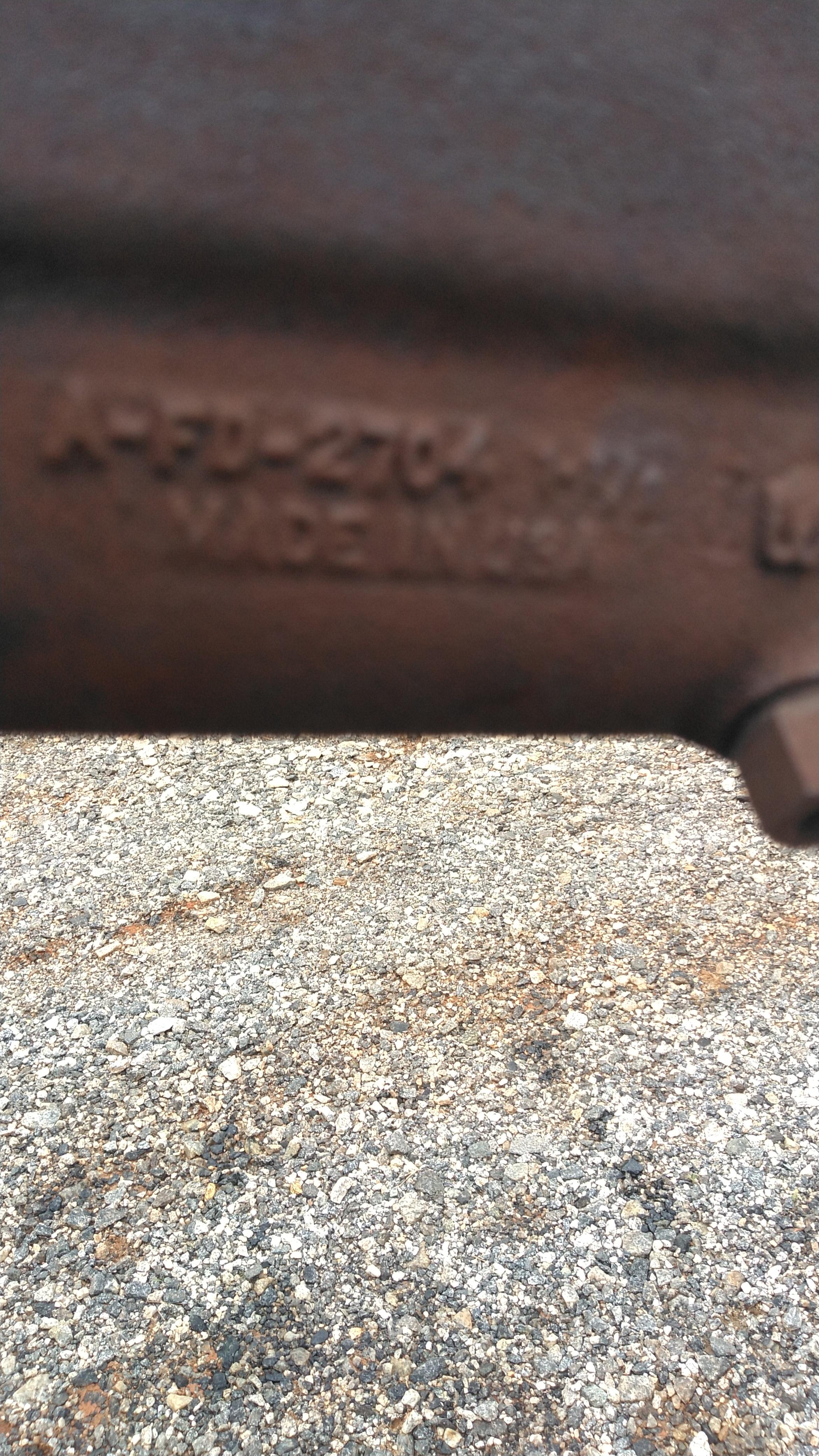

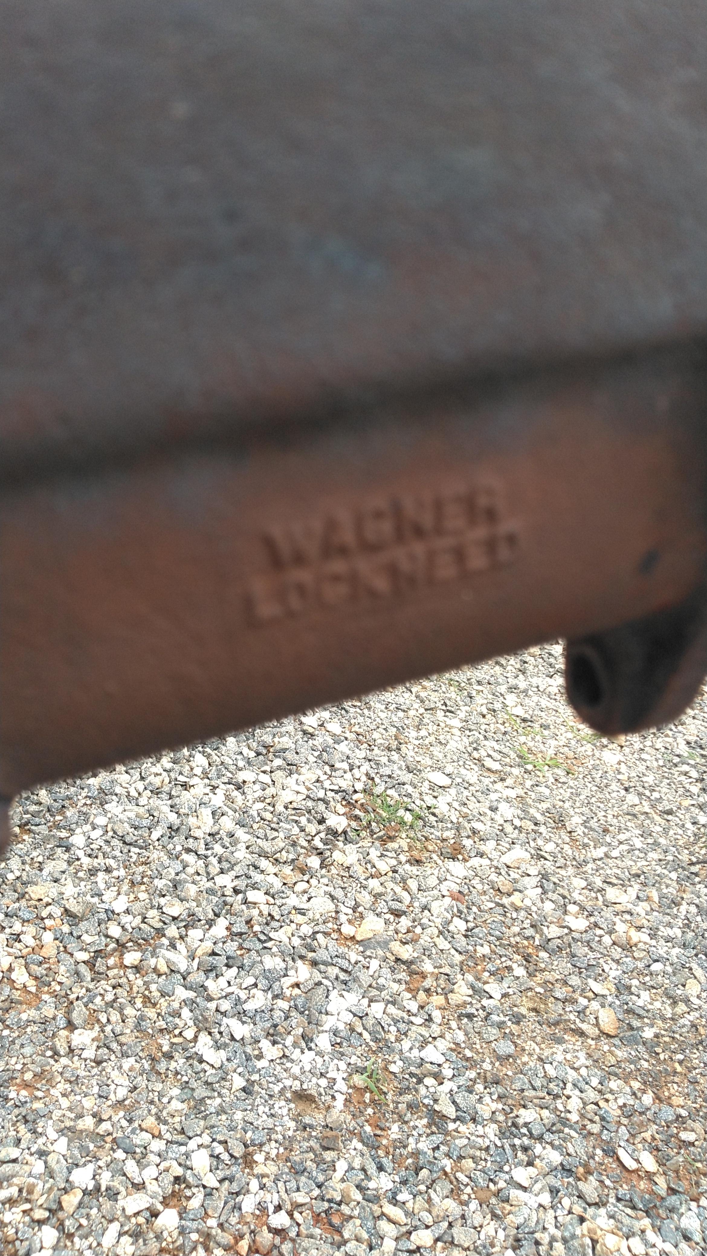

That looks just like the one on my 48 International KB-7..  mine is a Wagner Lockheed, and I actually got one from O'Reilly Auto parts..  there was a number cast into mine that I used to get the new one.
No numbers on this one ugg!
The Master cyl pictured is a very common type, BUT there are different bore (may be stroke) and very important, with and without RPC (residual pressure check).
 If the truck doesn't have a frame mounted hydrovac booster, you need a master with the RPC, if it does have a hydrovac, it may or may not (depending on the booster) need a RPC in the master.
The K-7's tha Jojo and I have are a 1 1/2" bore and do not have a RPC in the outlet. It is MC 2657. the same master with the valve is different, I want to say, MC662 but that is just from memory, so could be wrong. edit: I was wrong MC 661 is the number 1 1/2" bore with Rpc.
You MUST use the correct configuration for your application and can not use "looks" alone to select.
