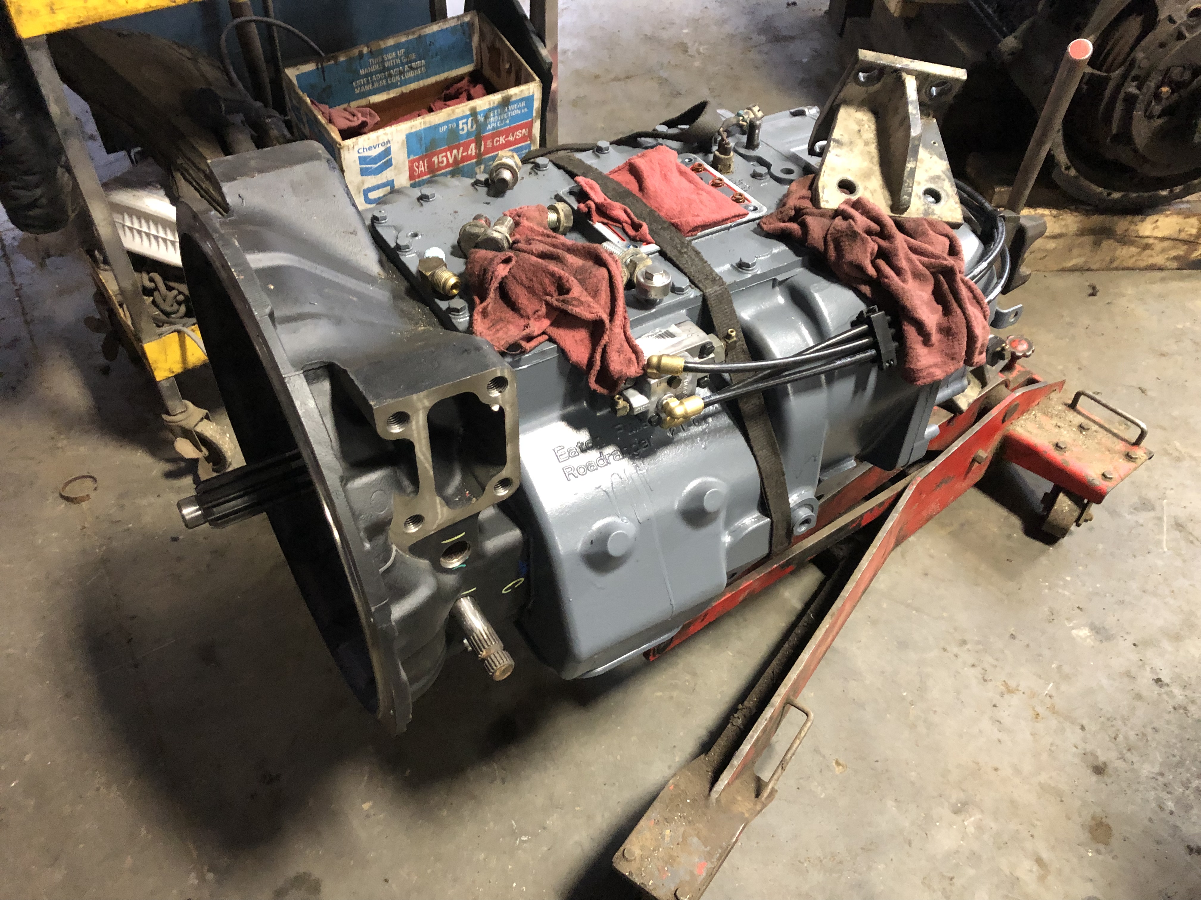

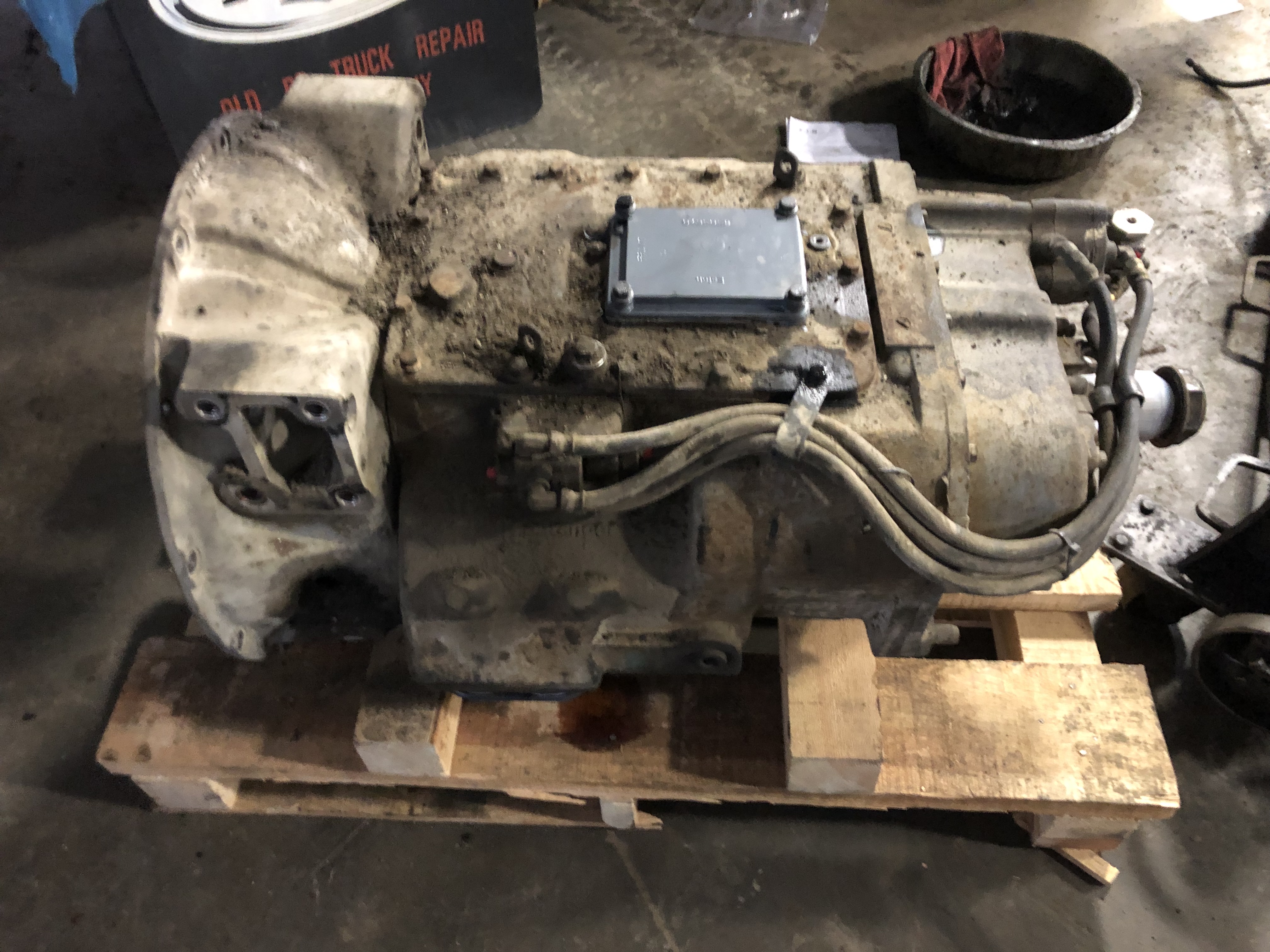

Stopped in at the shop quick between pushing snow into piles and the bell housing was on, flywheel was back from resurfacing and they were in the process of relocating the transmission mounts. They hoped to have the trans in by the afternoon and driveshaft ready to be sent out to be lengthened.
Turns out the transmission side mounts are different.

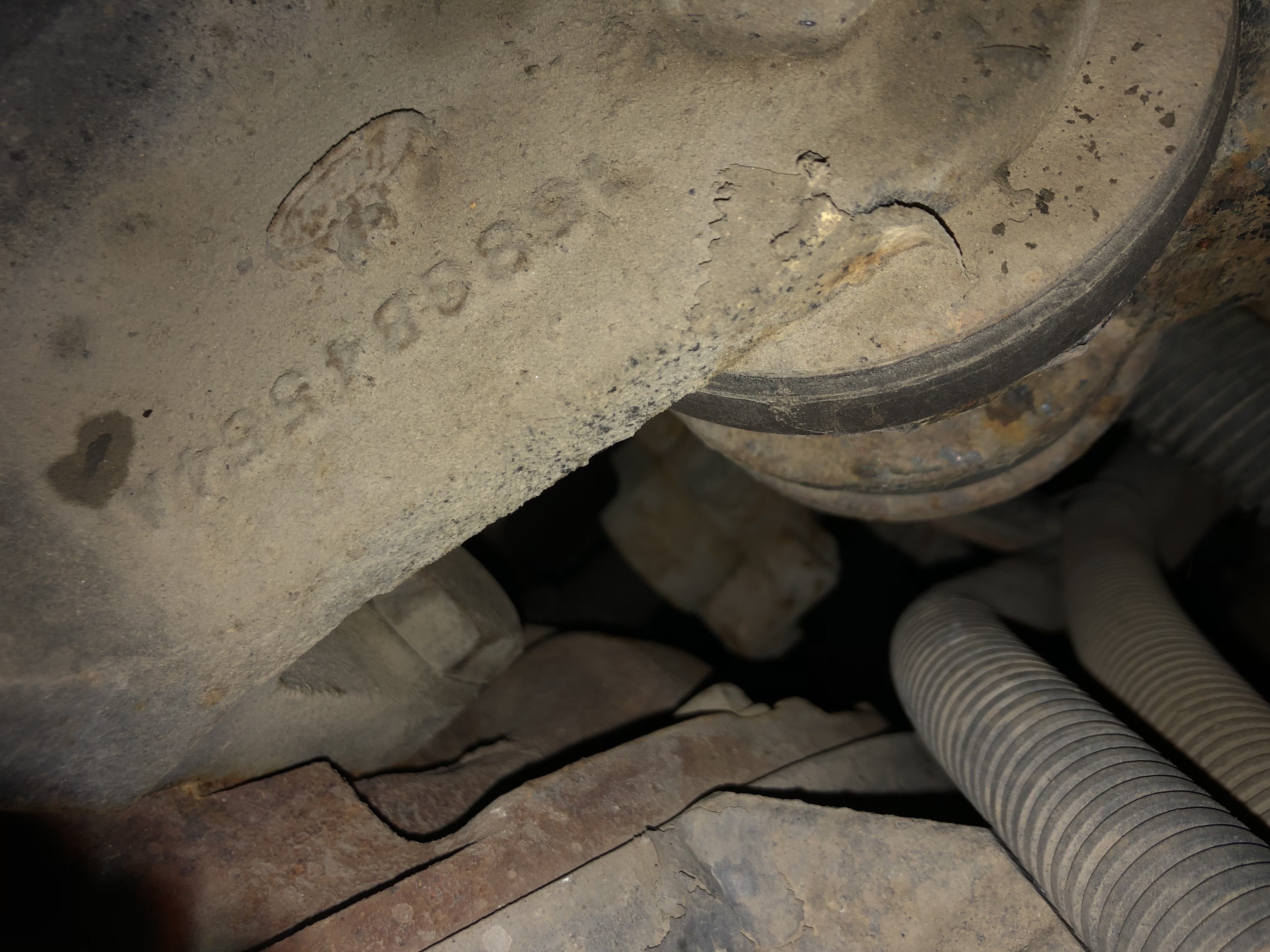

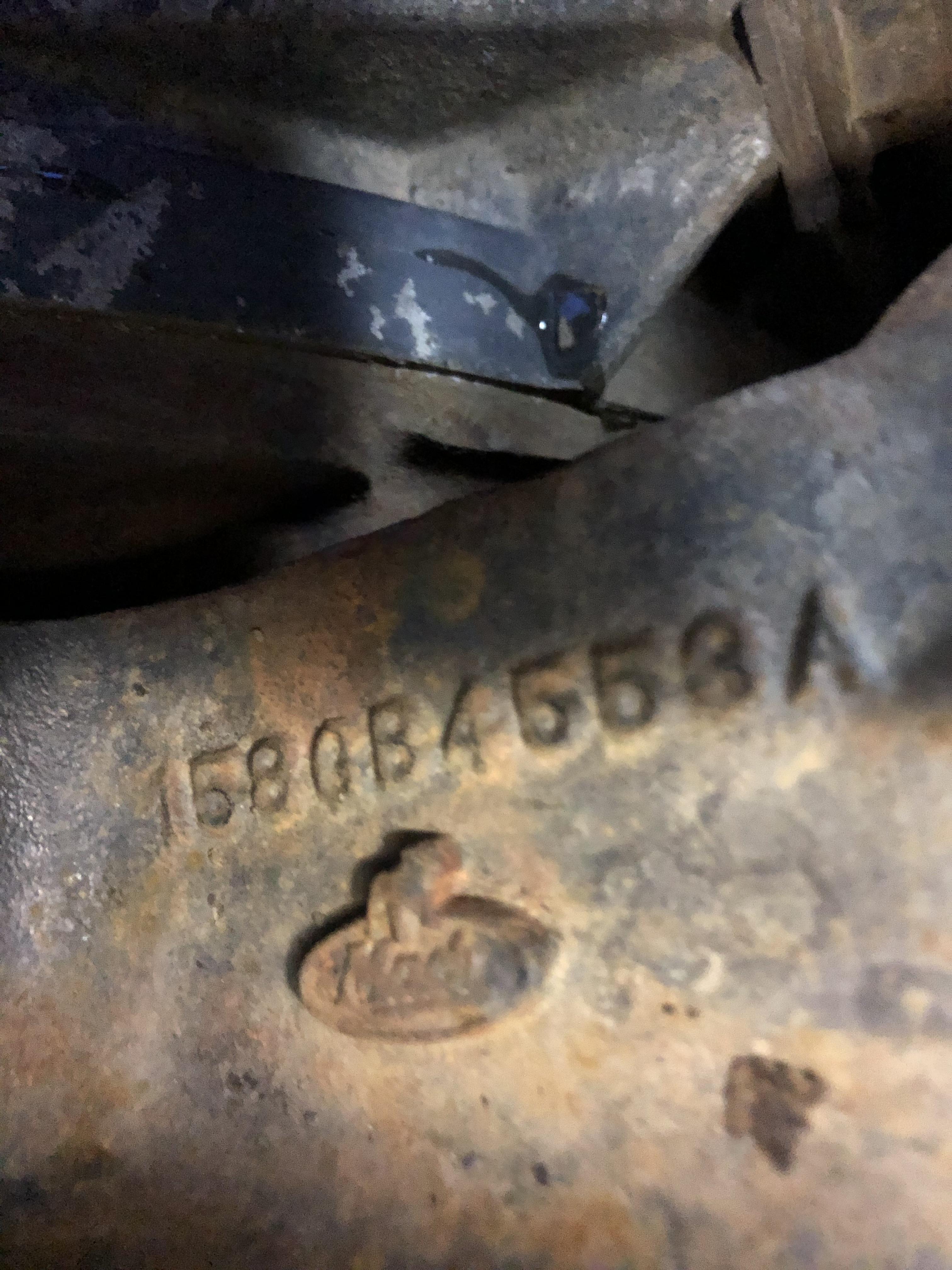

I was able to get the numbers off the transmission mounts on my dump truck. I think the frame side mounts are the same but will do some measuring in the morning.
The transmission mount part numbers I believe I need are, 158GB4553A and 158GB4554A.

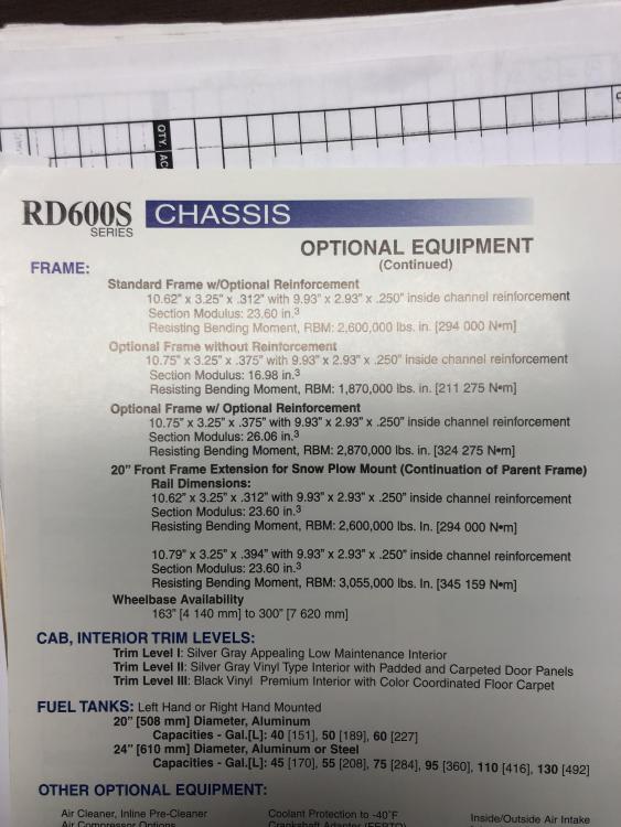

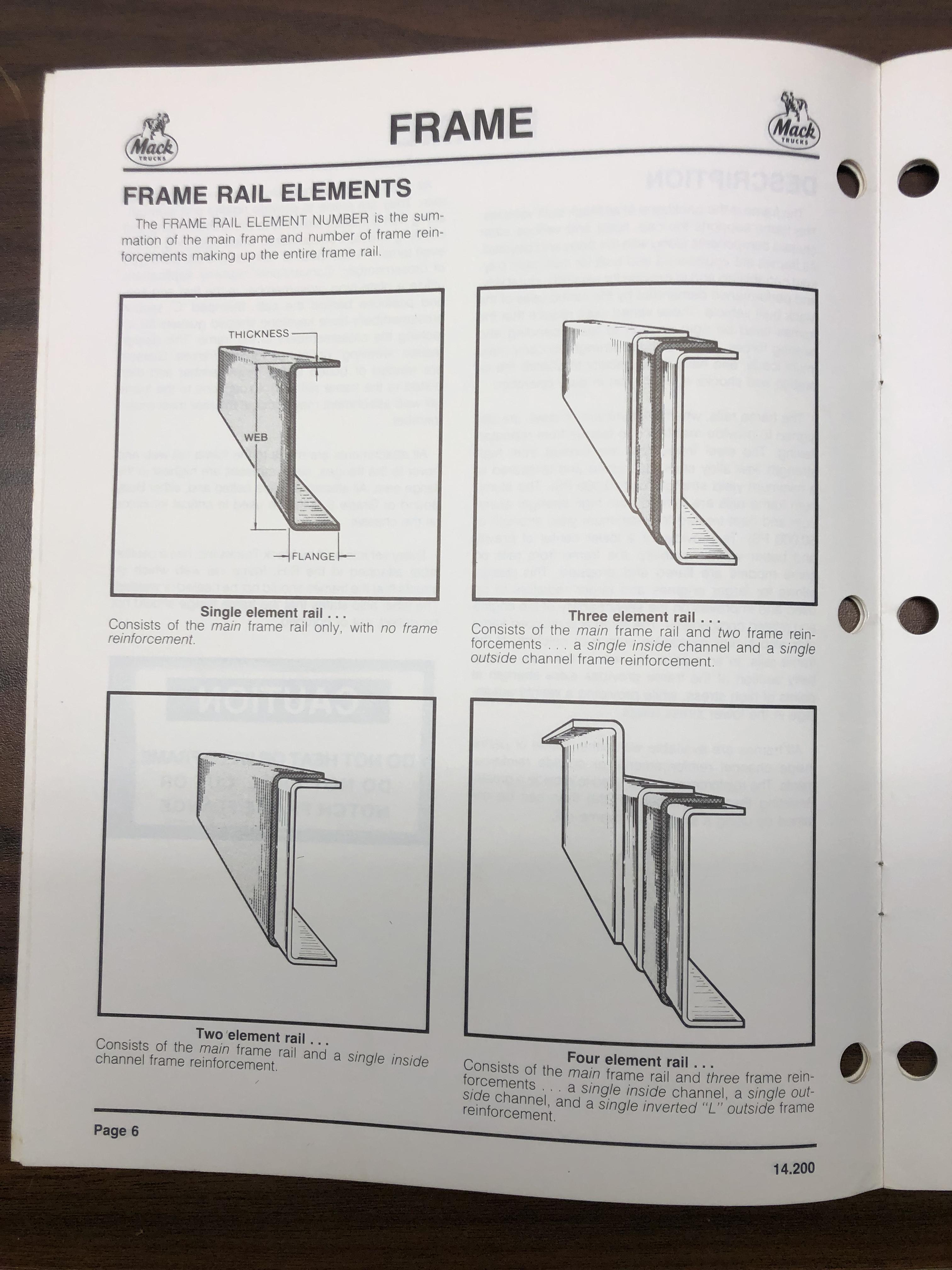

Well got my Mack frame book out and might’ve answered my own question about the single frame versus double frame, triple etc.
According to the book a double frame truck will have the second frame on the inside of the main frame. Any additional layers after a double will be to the outside of the main frame.
With that being said it would make sense that mounting brackets would be narrower on a double frame truck than a single frame.  Or  a spacer is used to make up the space, similar to having an inner rail on a single frame, then the same brackets can be used regardless of the frame thickness.

New trans and the removal of the REPTO. The REPTO is kinda heavy- 3 good size gears plus several bearings and it took two oil lines. Aluminum housing but it all ads up. No doubt took HP to turn even if not connected to anything. Hope my oil pressure comes up a little, I was on the lower side when hot.
I wanted the REPTO out the day I bought the truck. When the 9ll started to occasionally slip out of 3/7 gear I took the opportunity to get rid of it and slip in the 18. Turns out the clutch was in need and the rear main was leaking so I would of been in there soon anyway.
