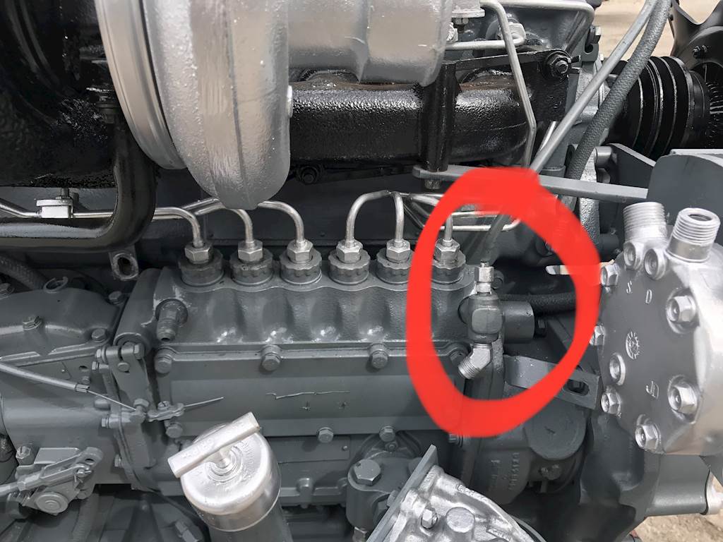

fuel ckeck valve
mack88
It screws into the side of the fuel injection pump then the fuel return line ( that goes back to the fuel tank) screws into it. Various different styles throughout the years. Most can be re-shimmed to increase pressure. The spring can break or loose tension or the ball and seat can wear and can cause low fuel pressure or hard starting
1 hour ago, mack88 said:
Thanks for the info ordered a new one dealer said only 2 left in north america.
