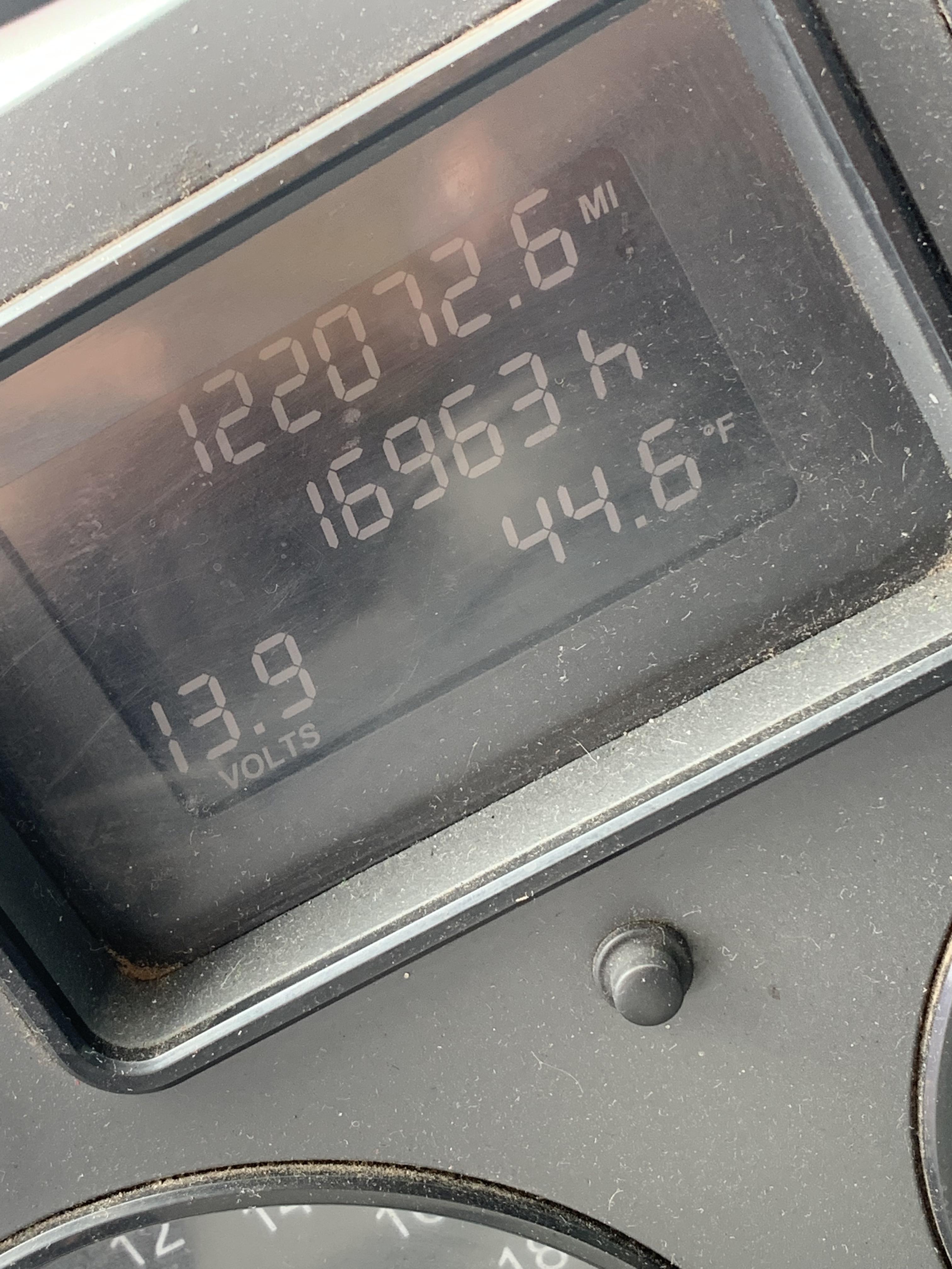

I am looking into purchasing a 2009 Mack Pinnacle CXU613 with an MP8 engine 550HP 13 speed manual, All Original miles to the whole truck which is 122,062. I am not sure how that’s possible being at what age that is but I saw it for myself and got it checked at a Loves Truck stop for authenticity to the miles.. They are selling it to me for 56k… good deal?? Anything I should be looking out for on this truck??

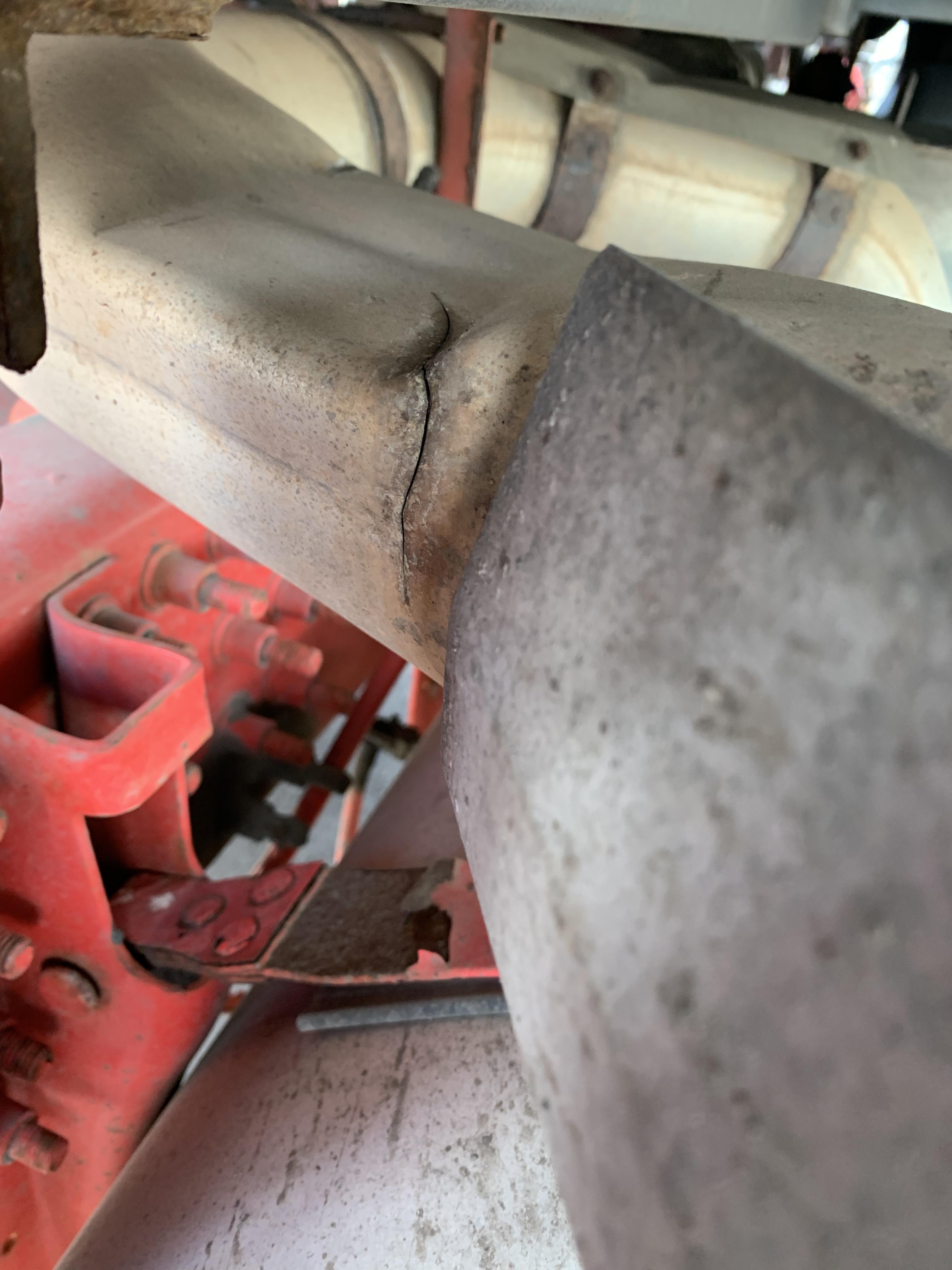

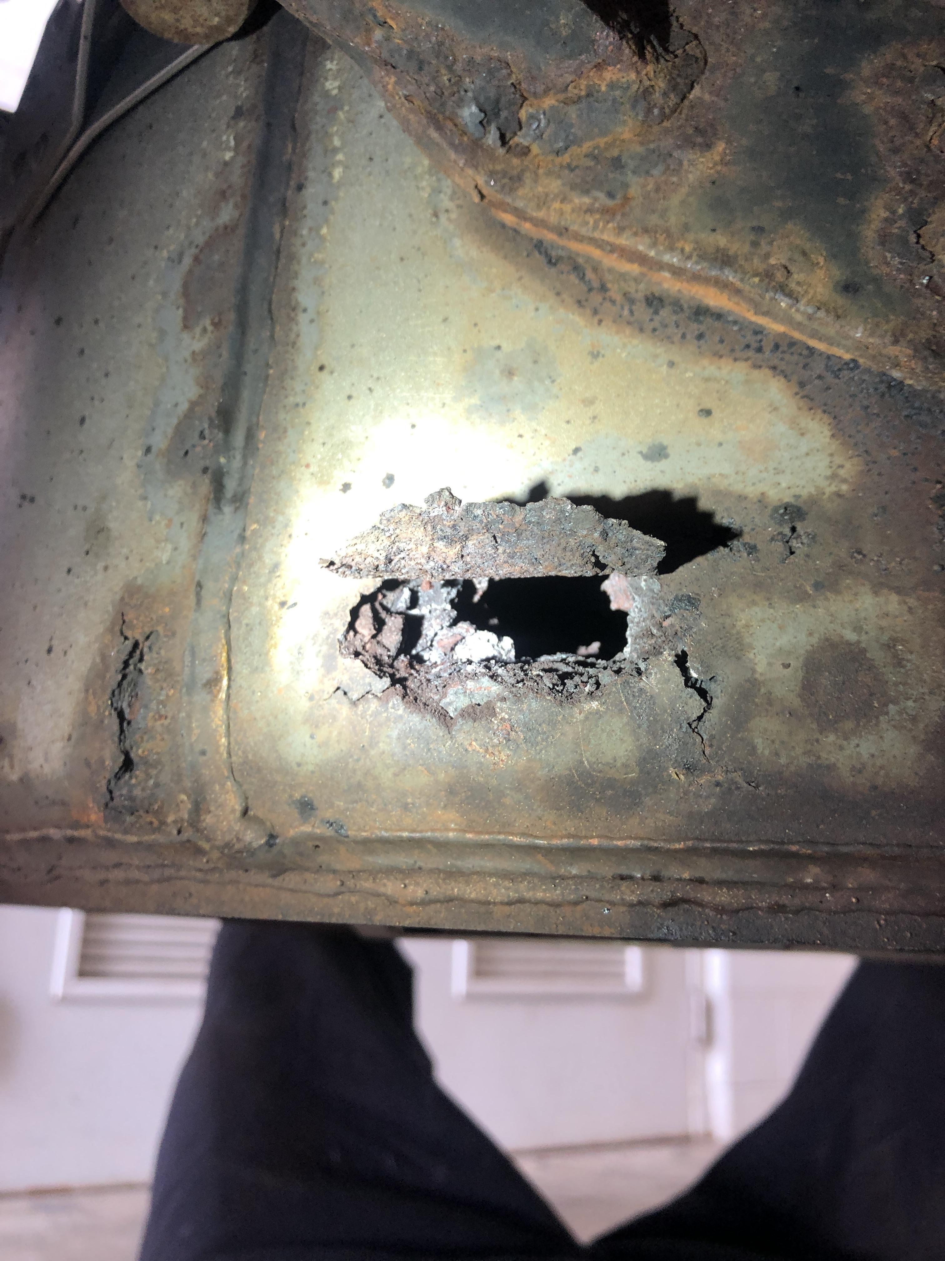

Is there any service information on this truck? What’s with that bumper, any idea what the truck was previously used for? I notice some volvo green parts on it. Stand up style doc/dpf so check the bottom pan for cracks or holes. If possible maybe ask about getting some oil and getting an analysis done on it.
I definetly agree with you on the bumper, it is ugly as hell lol and if I go through with getting this truck I would hope I can change that ugliness in the near future lol. Ok I will check for those cracks and holes and the oil analysis. How is it possible that a 2009 has 122k miles on it only? And for that price? It’s too good to be true it feels like

Yeah I know, right now I can’t fall in love with the look of a truck I gotta love what it will do for me 😏 that’s what I was thinking too Onyx! I saw the same exact link I sent you, and I went to go see it for myself. The dash does read 122k and the clock hours are very young. That’s why so far I am having the truck inspected at a Loves (if that’s dependable for truck inspection) Truck Stop and as well on legitimacy of reading the computer to the engine for its Miles and such, it’s too good to be true. I hope this doesn’t sound too crazy but where is the dpf located or can I see a full picture of what it looks like?? My last truck didn’t have the dpf and it was a mack.. Is it that tank that’s right under the passenger door?!

Hahaha, I’m not familiar with loves truck shop. So I can’t answer that. So that DOC (diesel oxidation catalyst) and DPF (diesel particulate filter) are all one unit under the passenger door. It looks like a kerosene heater haha. You will get to know these trucks pretty well once you buy one.

Onyx the Unit is an 09. Vmac Off the top of my head about the engine hours I kinda forgot, BUT for 122k miles I DID look at the engine hours and seen it for myself that it is young. I will stop by later today and take a picture of that. Is there a way I can find out if the cups/injectors have been updated? Can I call the Mack dealer and give them the VIN to see if they have record on what’s been done to the Unit?
