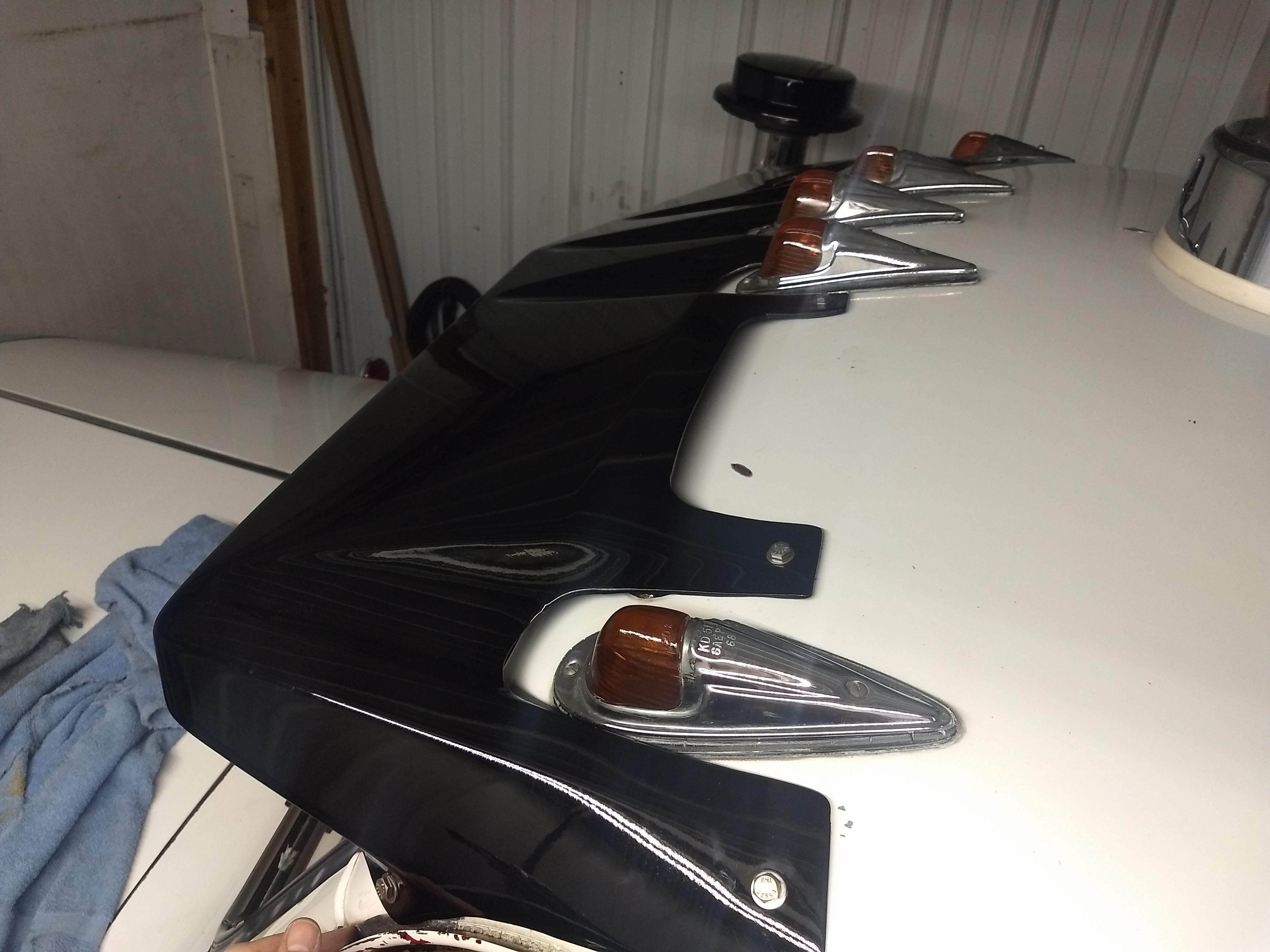

I just my headliner back in a week ago after installing my new visor.  My headliner is in 3 pcs because the seams fell apart.  I have it taped together on the back.  Ugh.
