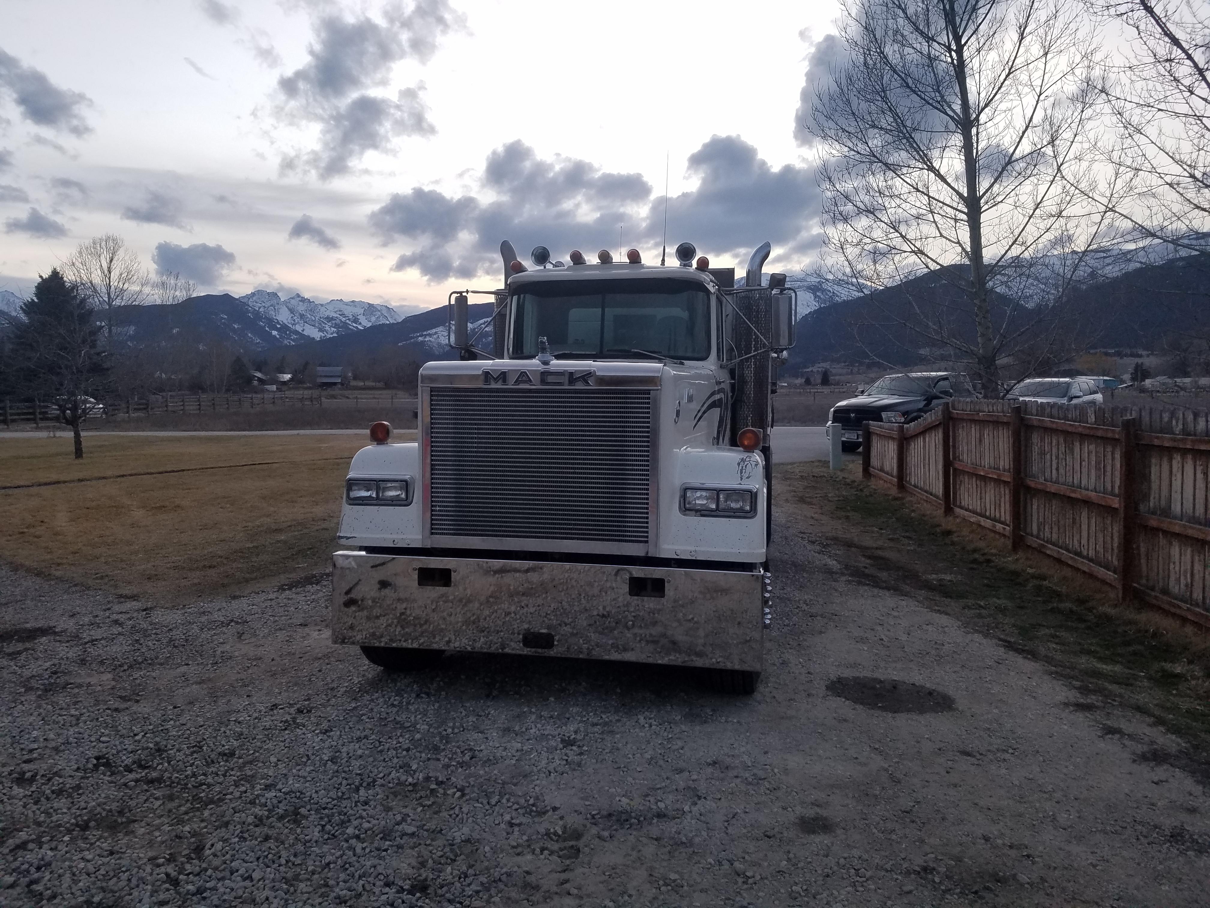

I have a Superliner with a single stack.  I bought another Superliner as a parts truck that has dual exhaust.  I want to add the second stack to the truck I run everyday . The parts truck didn't have the cross members that form an X between the two muffler mounts.  I've seen them on some other Mack's with dual exhaust.  Does anyone have dual stacks without the cross members? Am I going to need to get some?

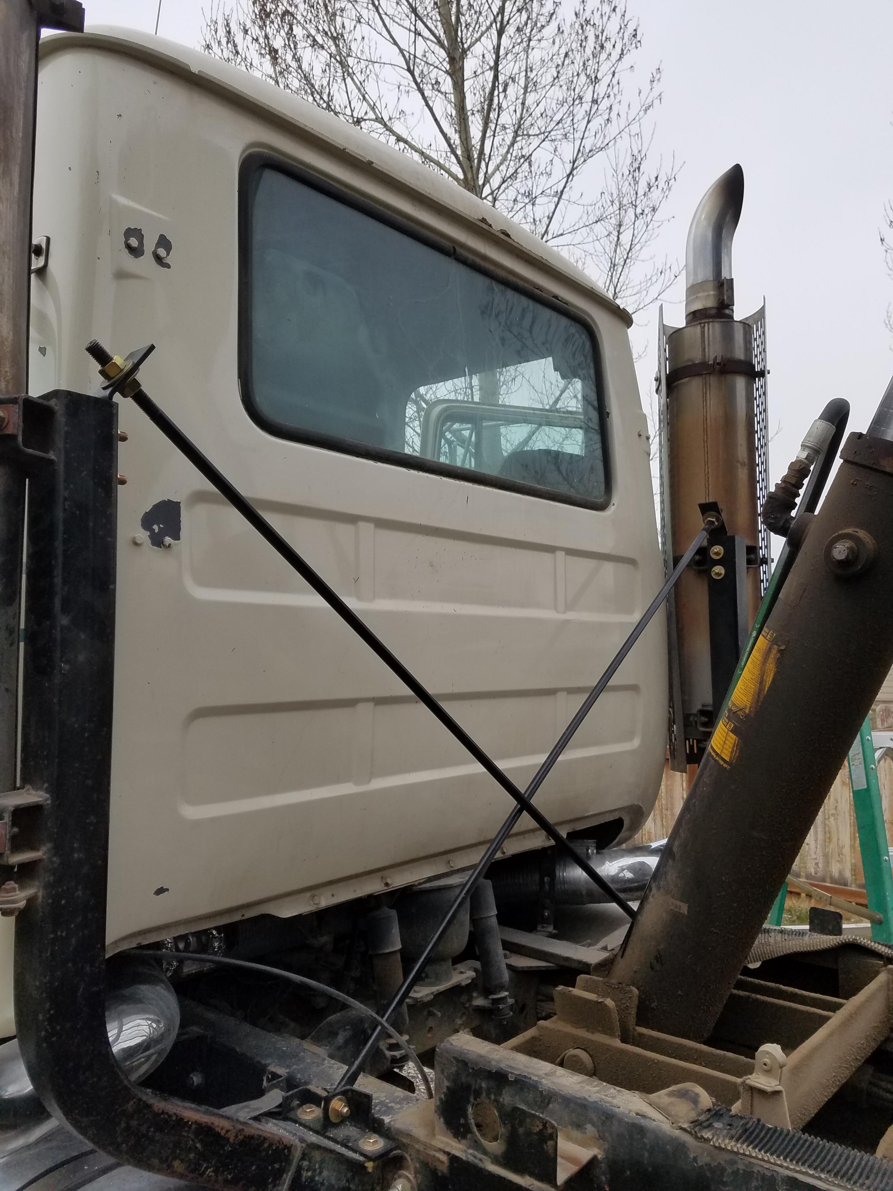

I don't think they all had cross braces.  The one on my 89 looks to be homemade.  I don't think my family's 88 sleeper had them mounted behind the bunk, but one always shook and eventually broke the mount.  There is also the option of running a single tie rod between the brackets as my MH has.
